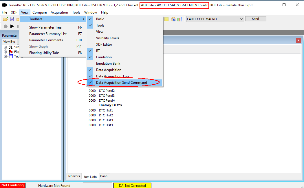

I know (assume) the DTC codes are wiped when the PCM loses power, but when I try to send the DTC macro using TunerPro RT and the adx the command list is blank. Am i doing something wrong, how do I load the macros to the send command drop down bar?
If I can get that working on this PC, I'll lug everything downstairs and plug it in to the car and hopefully get some DTCs to track down the source of the problem.
Any help is greatly appreciated :)
Posts: 8996
Re: LS1 ADX V1.6 to suit Tunercat OBD2 Cable, AVT 852
Load the ADX, then view->toolbars->enabled data aquisition send command
Then a drop down bar with "fault code macro" and "clear codes" macro in it appears in the tool bar, pick the one you want and hit send.
Results appear on the "item list" page.
0000 is deafult/not populated. any other numbers you see are from the car.
avt vpw dtcs setup.png (35.69 KiB) Viewed 36640 times
avt vpw dtcs.png (33.57 KiB) Viewed 36640 times
