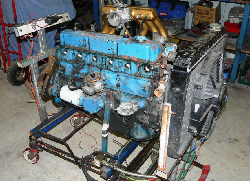

Well as the topic suggests, my ultimate plan is to have a 202 running with a custom crank trigger!
So to begin with i am going to use a stock 202 blue motor on a test stand and get it running with the same delco 808 and vk efi manifold as per my gemini, once this is sorted out i will then make a crank trigger using a commodore ABS sensor on the balancer to drive the whole show.
The main aim is for better rpm trace at high revs compared to the reluctor dizzy setup.
So to that end i have begun setting up the 202 on a test stand i got off a mate :) it was originally used for v8's so i just modded the front legs and added my own rear supports and off we go :)

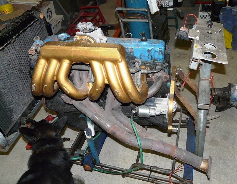

few more pics, this is what it looks like with all the efi wiring hahahah
and this is why its now quiet :)
Posts: 5632
Re: Converting 202 to ABS Crank Trigger
nice one mate love the map just hanging from a short hose
its not hanging, its cable tied to that pcv hose :P hehehehehe
Second pic down, your dog might need to be careful where he rests his chin after the engine has been running :lol:
hahah yeah he was actually sniffing it from one end to the other, if you look at the pic below that one hes moved on to the radiator pipe :)
funny as though, when it is running he is in the middle of the yard watching it and shivering :P
