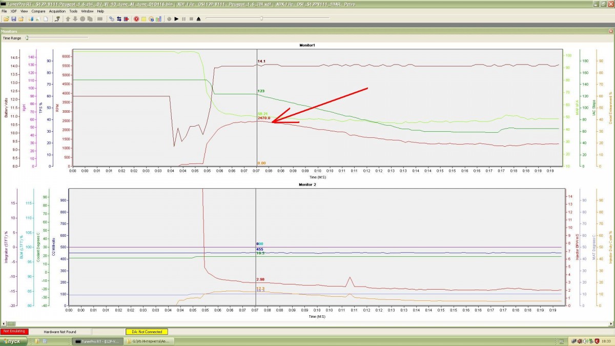

how to reduce rpm after engine start

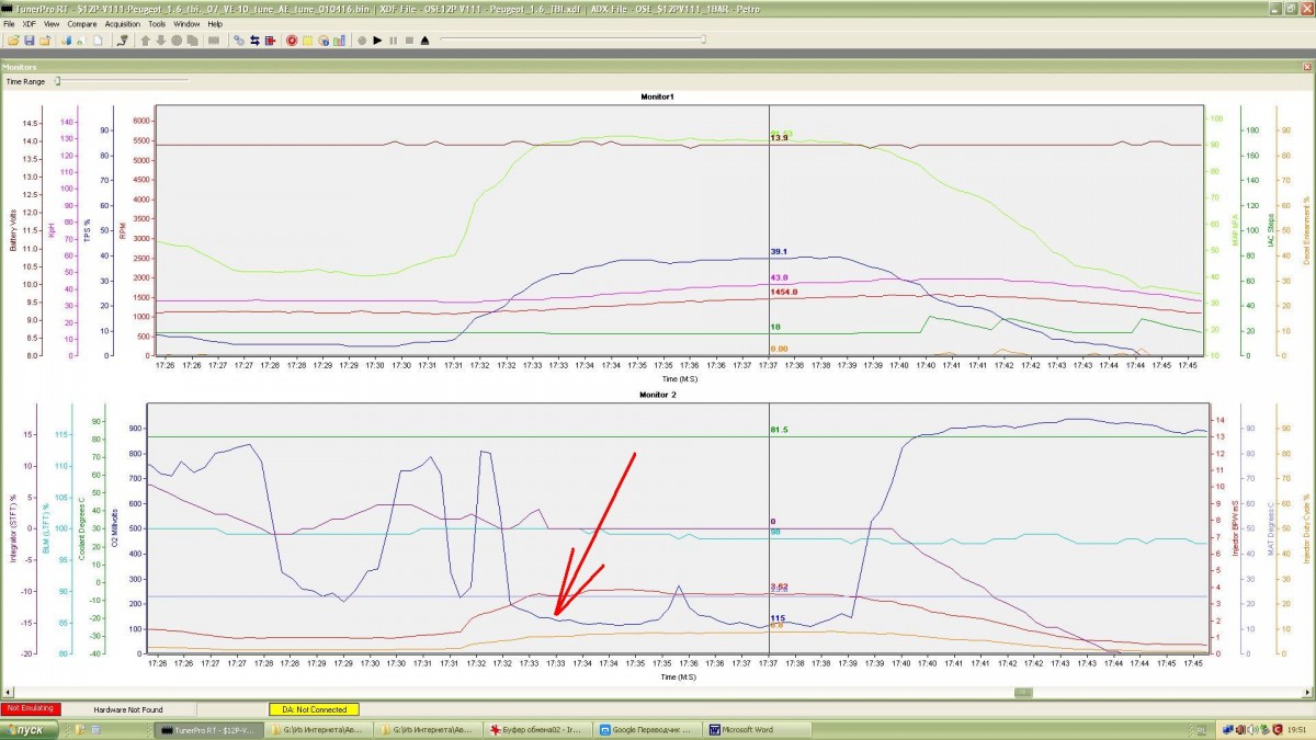

How to remove these failures? AE setting helps weak...
In this case, after the failure of the engine enters the normal mode

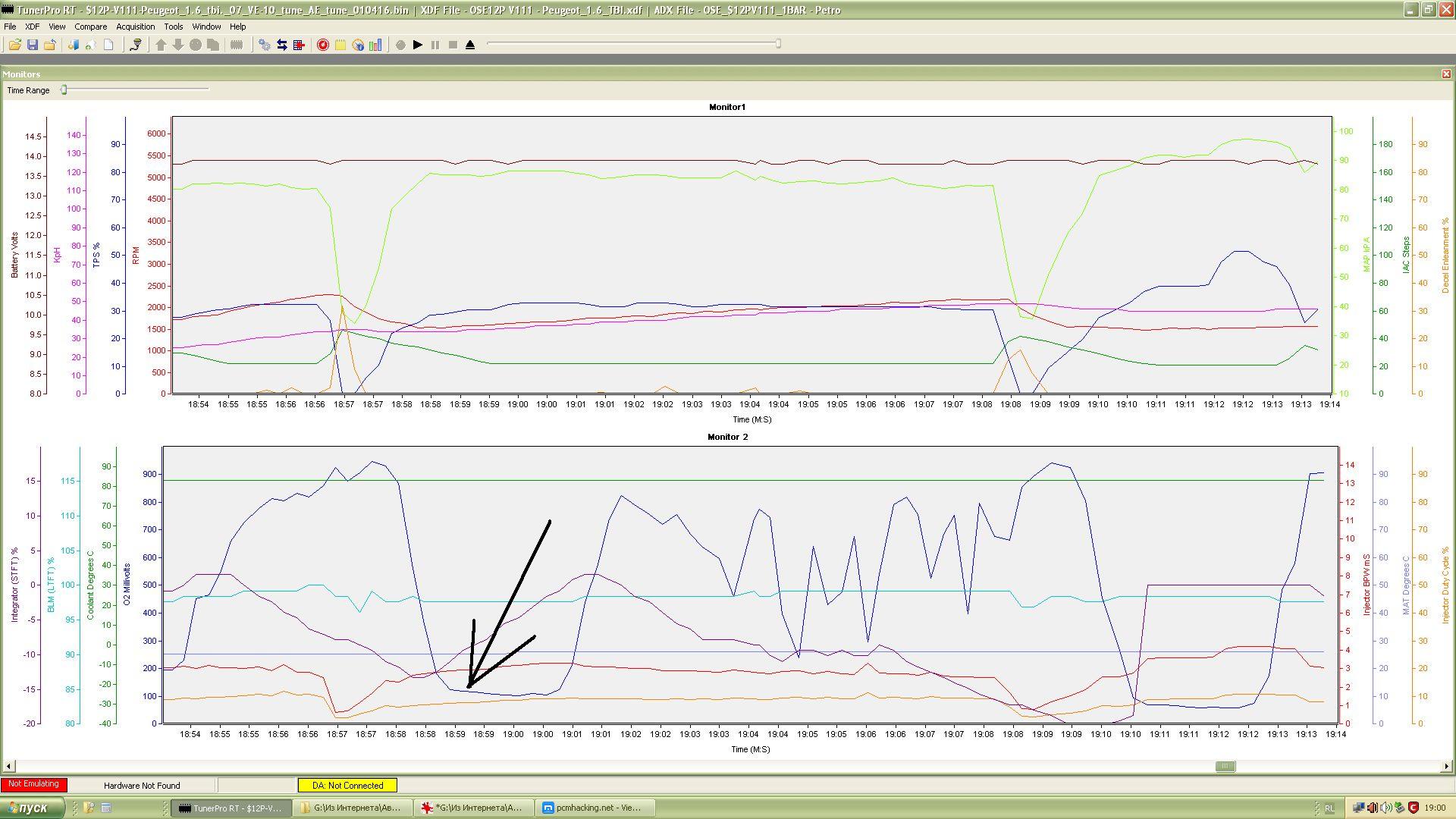

In this case, the engine does not reach the normal mode
