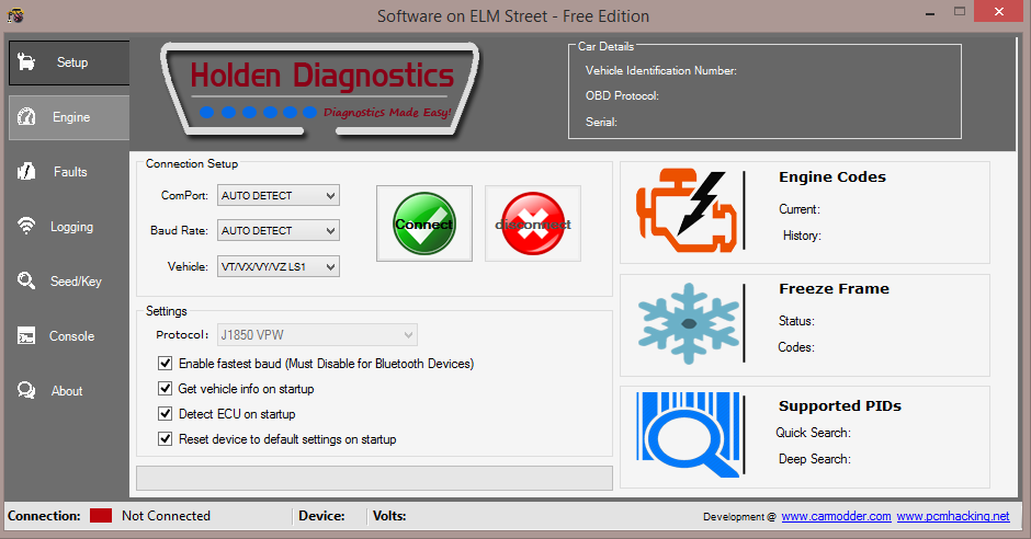

Re: Software On ELM Street - OBD2 Software Development
Did a full reconstruct of the vertical tabs... had to write the little buggers from scratch since the old ones were causing soooo much flickering!
Added in little icons as well. Im not very happy with them at the moment.. but will do till I source out some others.
If anyone has suggestions to what the icons should be for each category.. shout out the idea!
Got to play with a VZ commodore today. Found a few interesting issues which I was unaware of!
1) The "auto detect" was a little weird and didnt work the first time around. (But, I plugged in the tool AFTER starting the software.. so I believe the COM had not updated into the application yet.)
2) The "Fast Baud 115200" definitely did not work while plugged into the car.. but it works on the bench setup (again Im not sure why!?!)
3) The initial vehicle information requesting of VIN and Serial and faults caused a small error to pop up on screen for a split second. I believe this must be because I disable the car chatter for a split second at one point.. I will need to remove! Unnecessary precaution to have in there!
On a good note, the "Freeze Frame" counter worked! Had two freeze frames lodged and successfully picked them up. And the fault reader worked a treat too!
So now...why would the ELM behave so differently in car to on the bench setup? There is a grounding, 12+v supply and the CAN lines connected on both systems yet only my bench setup accepts the update!
Whereas the in-car experience just had the setup hanging saying "enabling fast baud" or something similar.
Can anyone think of a reason why? The ELM works with enabling the fast baud also when connected to the laptop and not the car as well... so its only when in car! Very weird!
Iv read from everyones posts as well as some feedback that this issue has occured a few times. Just unsure what was exactly happening.. unfortunately I didnt have long enough to step through the process and see what the ELM replies during the process... since we were trying to diagnose why the engine was fluttering at ~2000rpm, turns out it was a dodgey sparkplug!
Can anyone that has issues with enabling the fast baud while in car please just comment in the thread so I have a count of who can test stuff? My next version will have a very detailed fault catching system to display all steps going on while trying to enable the fast baud
I really do feel the fastest baud rate *needs* to be used to maximise effectiveness of the application since the communication for data logging is extremely quick!
Well Iv got NO clue why the ELM cable behaves so weird during connection in car. I will try work that out on my mates car in the coming weeks.
I think it is something to do with sending "ATD" which sets the elm into default specs. I think I will try removing that entirely and giving it another shot.
Apart form that. Iv started reverse engineering the VE V6 controllers. Should hopefuly be able to add those to the compatibility list.
Removed the "Reset to Defaults" and seems to work better in car.
The auto increase to 115200baud two a couple shots... still dont understand why! Ill have to google if it is a common issue since didnt have time to step though it again.
If anyone with a VZ can test out the "Connect" with auto comport and auto baud enabled on the Next version I put up. That would be greatly appreciated. I will try put some more process text so it will show up in the console log if anything does fail.
Iv also found out... the elm supports up to 500,000baud! Thats pretty quick!
Soooo after ALOT of research... Iv found that there has been alot of instances where a software baud rate change (Like I do) does not work when connected to the vehicle. It seems to only work when unplugged from the car and only plugged into the laptop.
Now, a software baud change also only works on newer ELM cables. So, I believe, I will need to have a Message box saying to unplug the cable from vehicle (while it does the BAUD rate update). Then plug it back in once the baud rate has successfully updated.
Im also adding in (Finally) clearing the Fault codes!
I will definately need testers on that! Just to see if all fault codes clear (including current.. even for a moment?) and if the history clear as well. Since it can be a quick way to identify which fault is actually causing havoc in the car.
