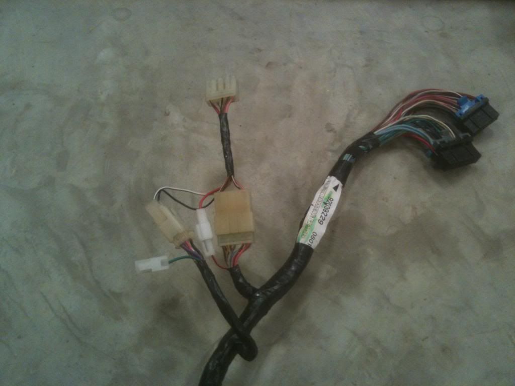

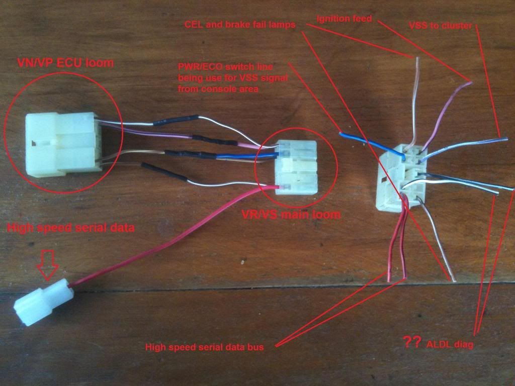

Yes the wire is free to use now. I know what you mean Dylan, I saw that they loop the power button to the reverse supply line. I will get rid of this and set it up line on VN/VP
I will use the blue wire for the VSS and on this plug I am making split it for the cluster and ECU.
So looks Like I got it sorted more or less.
One question I have for VL400. Does your VR under steering column USB adapter require any other lines besides the serial data line? I noticed there is 2 black and white wires remaining on my plug, I assume these go to the ALDL connector under the steering column?

It needs only ground on pin 4 and/or 5 and ALDL data on pin 9.vlad01 wrote:One question I have for VL400. Does your VR under steering column USB adapter require any other lines besides the serial data line? I noticed there is 2 black and white wires remaining on my plug, I assume these go to the ALDL connector under the steering column?
- Posts: 8123
Re: VR manual conversion with VN loom RT 808
ok makes sense. I can use the black wire on the ALDL plug on the VN loom and patch it though to my plug in the pic.
I gather the white with black stripe is the same wire you jump on the VN ALDL to get diag mode? Might as well patch that though as well so I can do this under the steering column.

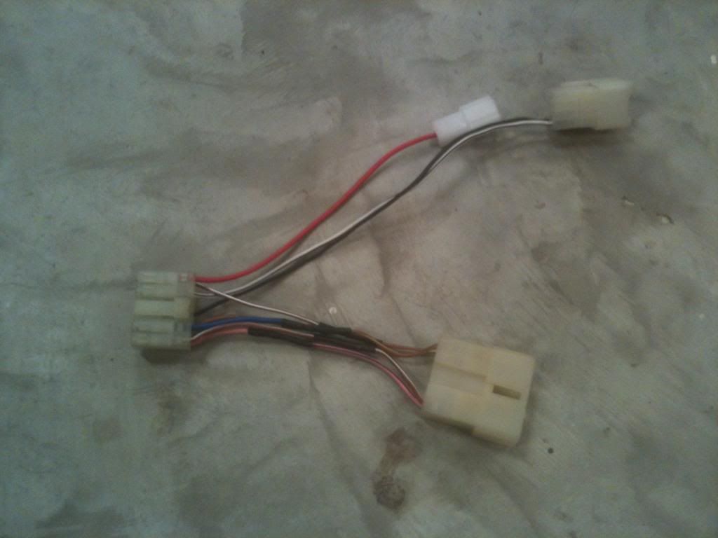

So I fitted the loom externally on the car for testing, plugged in my adapter and did some tests. So far looks right.
Just need to add the serial line on the ECU loom and the high speed ALDL board added to an ECU and I am good to go on to the rest of the project. Then I will make the T5 plug and play patch loom and test out VSS.
another video, this time I have made my patch loom for the T5, also plug and play.
only problem I noticed is the VR speedo is clearly calibrated for the higher pulse per Km and reads really slow. you can see this in the video.
its good though as I wanted to change to a VP speedo anyway as the VR are lacking gradients that I like in the VP cluster.

So yeah, its finished, seems to work. I will know for sure once I have gone over the whole car. So far I got the auto removed and manual shift plate fitted.
If you are wondering, the green wire is for the WB.
