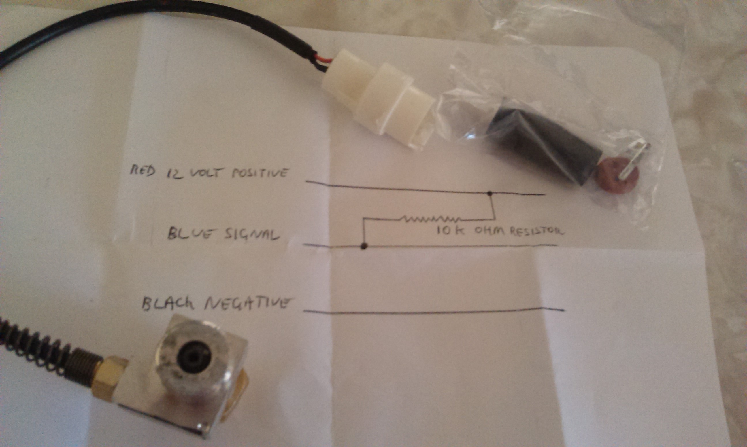

The sensor will have 12V, gnd and signal wires. The 12V feed is switched ignition.

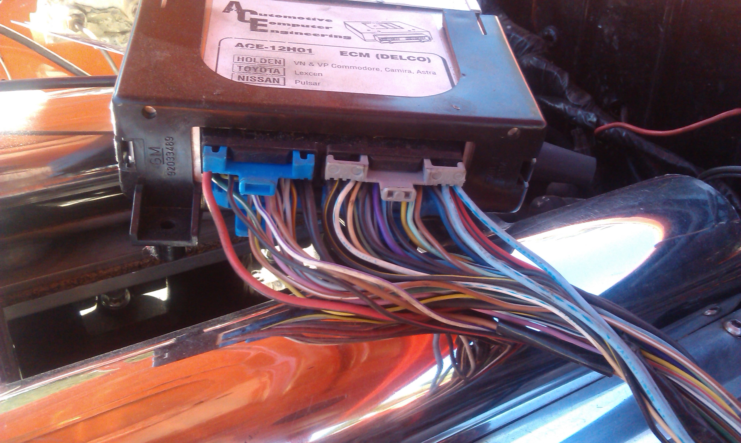

You wont have the speedo part shown in the factory diagram which does a divide by 5 of the signal. Wire the signal wire of your sensor directly to pin A10 of the ECU.
Once its all working will need to setup the PPK value in the ECU to match the sensor output.

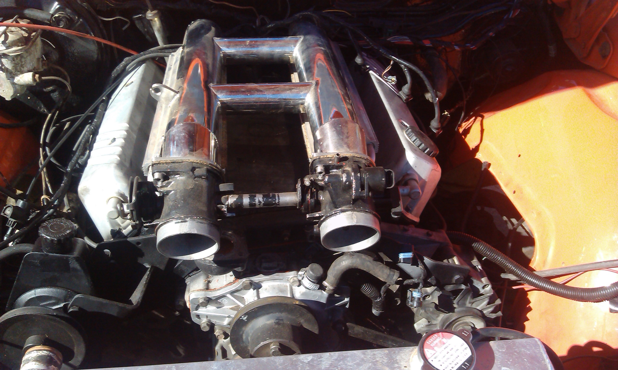

manifold that's now fitted

that's the sensor with an average at best diagram but all components are completely there

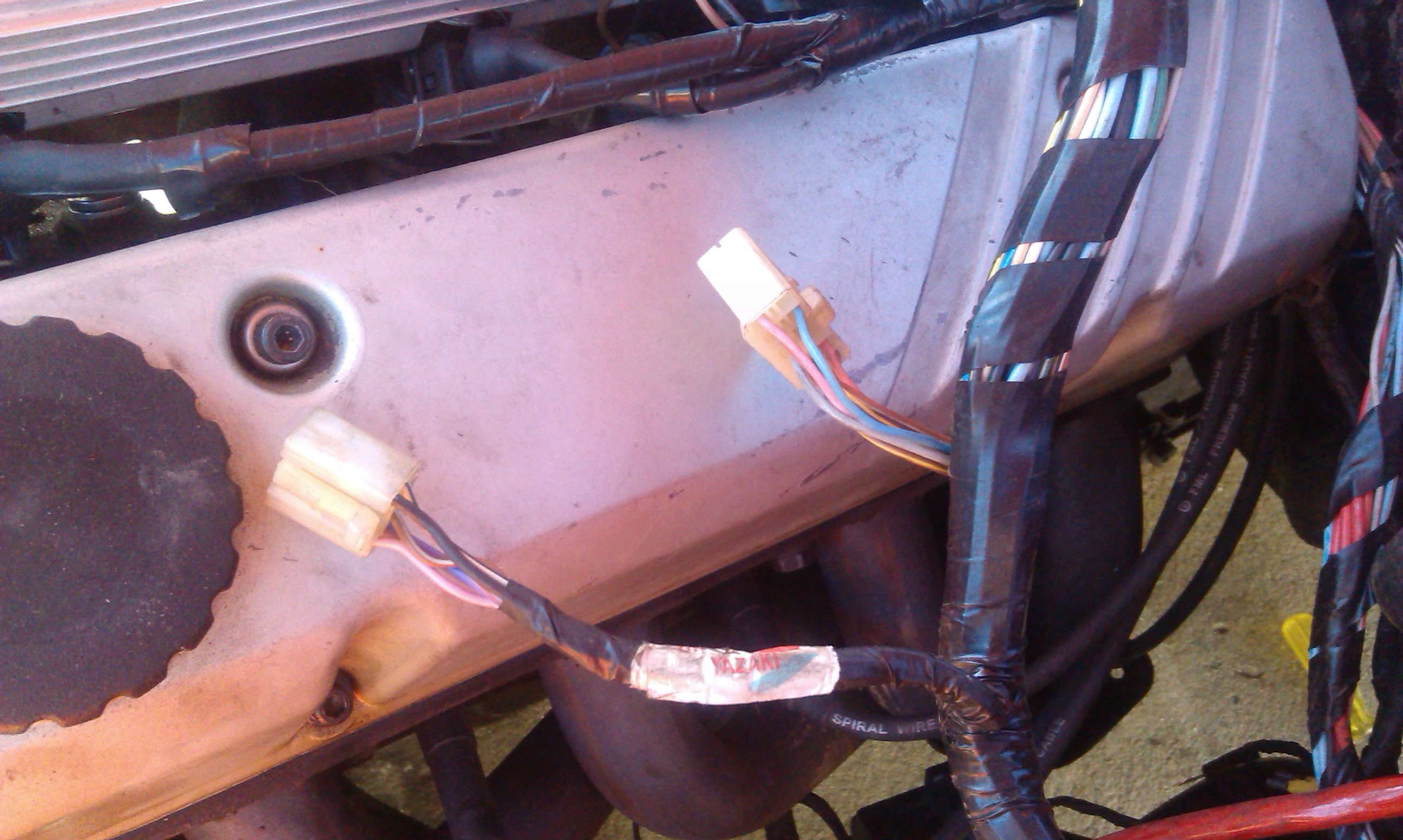

I have this harness but no dash wiring just efi loom
obviously ill need to redo this part of the harness and get the new speedo sensor wired up and the tcc whoch I need help with

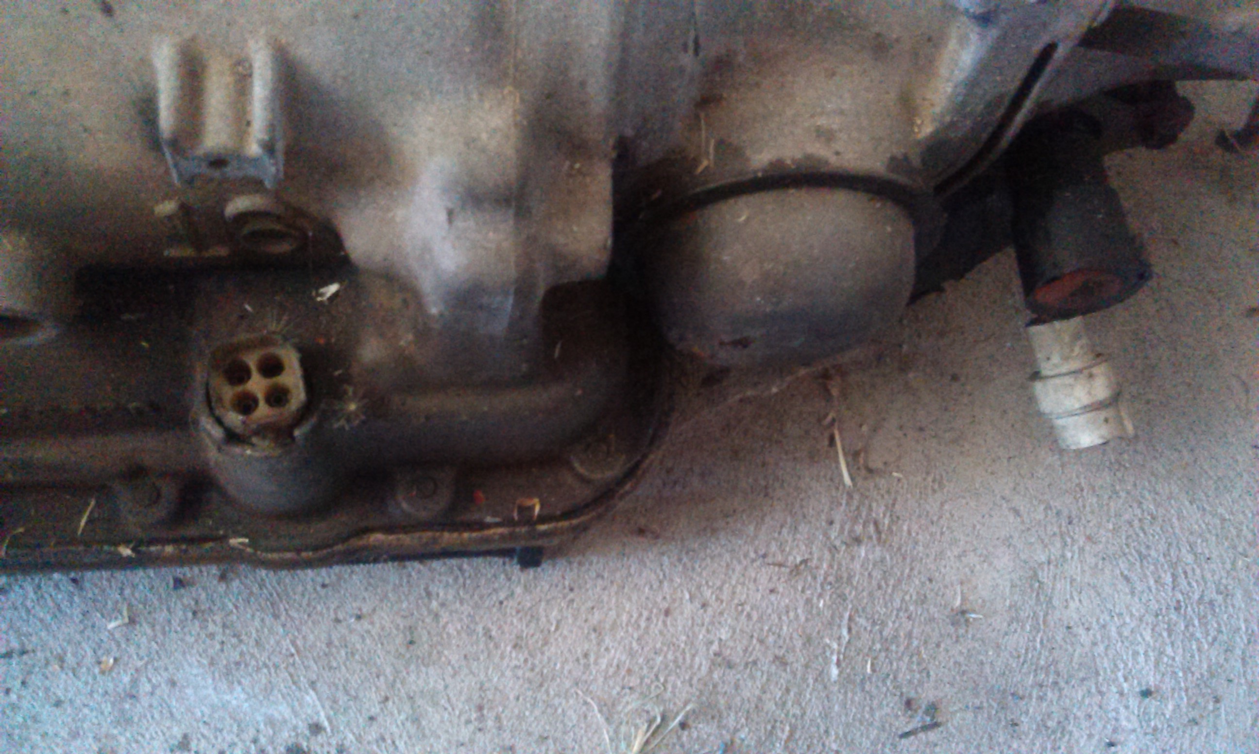

that's the box
is that 4 pin connector the tcc control or what does it do ? and whats the wiring to get it hooked up

so last 2 pics are just ecu wiring and aldl and stuff
how do I mesh it all up???
