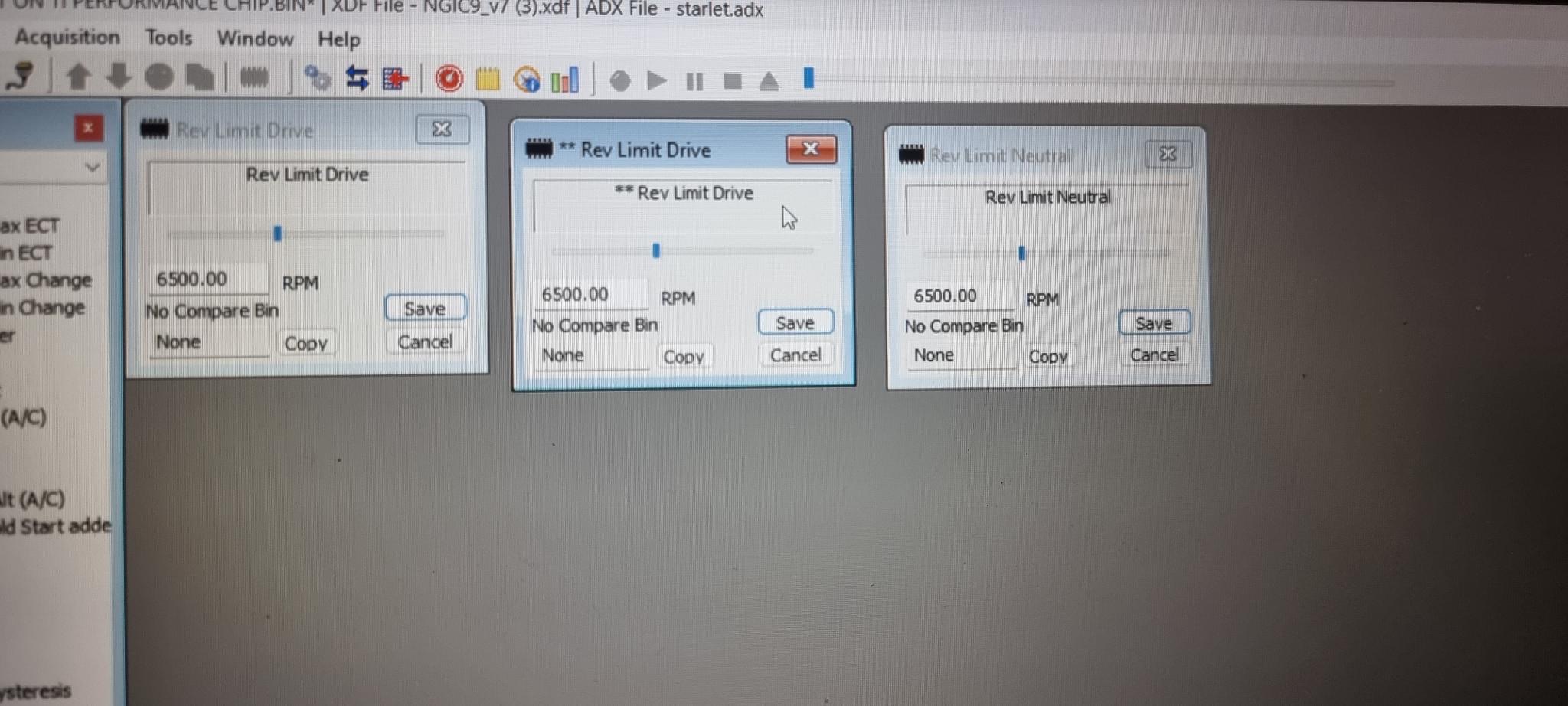

Helping a friend with his race car and he's having problems not being able to increase the rev limiter.
12WD bin and NGIC9_v7(3).xdf from Ti performance - https://www.tiperformance.com.au/library/tuning-files/ as it's an AU VCT engine and PCM.
The limiter is stuck on 5800, as you can see below its been set to 6500 with no change. (admittedly the RPM is being guaged by a cockpit tacho not a datalog :thumbdown:)

It has an asterisk on 1 of the Drive RPM limits & notes saying it doesn't work, so maybe that isn't a great file to use, could try another another definition just to double check?

Yeah, I've been thinking it has to be an XDF issue

Just heard back from the main guy at T.I.Performance & he said the definitions you're using are all tested & working, if it has no speed signal it will get stuck at 4,250RPM
