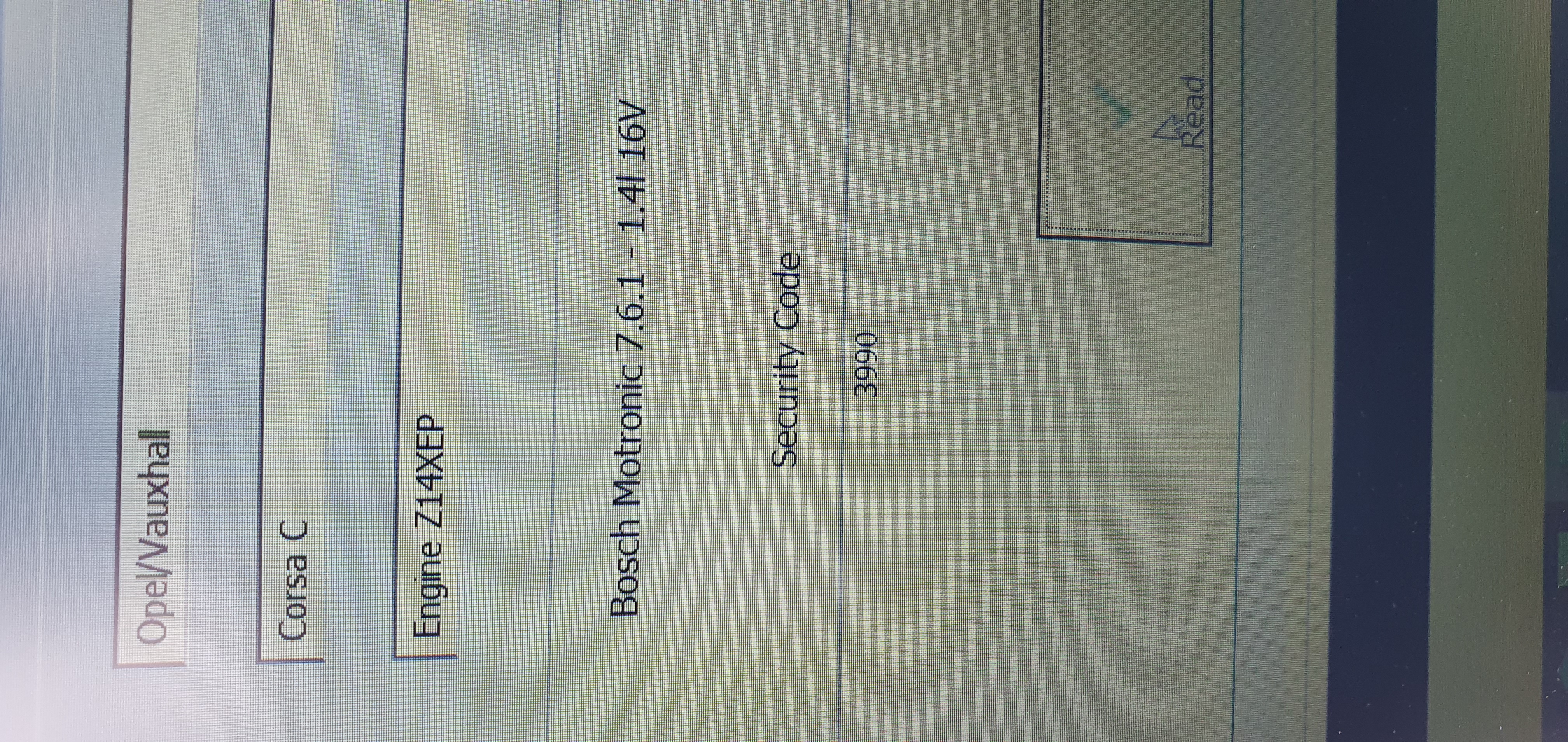

FVDI reads and resets the immo code without the rest of the car

id be interested to see where it's reading it from and what mode it's using, have you got something to log it doing the request?
Mode 23 reading flash doesn't get anything, ive gone through all the 21 and 1A PID requests and found nothing so it must be reading it via another mode or getting it from ram.
