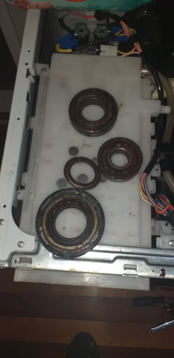

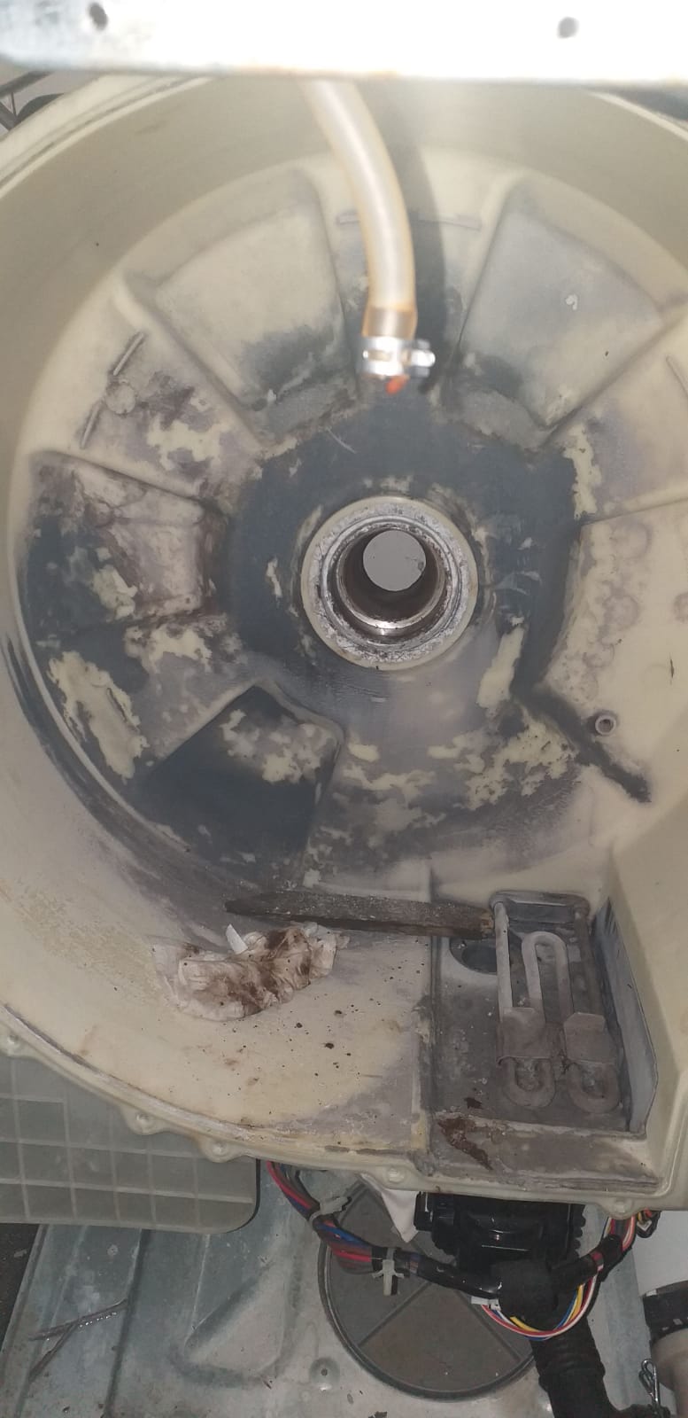

Today's mission, Washing machine locked up on the weekend on the final spin cycle, 1200rpm with a full load of towels. Looks like the seal failed causing bearing failure. In this case the rear bearing cage failed, part of it folded over and locked up the bearing. Made of a hell of a racket when it locked up. Bearings look standard but that seal might be difficult to get.
According to the manufacturer that is not repairable, the only sell the whole rear section of the tub with complete bearing/hub etc.

Holly cow, that's a fresh clean break, it just snapped! Bet that made y'all jump ...

Looks like I'm finally getting a bit of good luck. Managed to track down a supplier who has these special seals. Will fit some decent bearings to replace the cheap chinese ones that were in there.

Looks like my bearings and seal for the washing machine are stuff in the backlog of parcels in the greater Auckland region and washing is piling up fast

Washing machine back up and running but looks like the belt took a hit and is slipping. turns out it's a special belt only made for this manufacturer and it's NLA..... Closest generic belt is 4mm shorter but there is not adjustment for tension.
