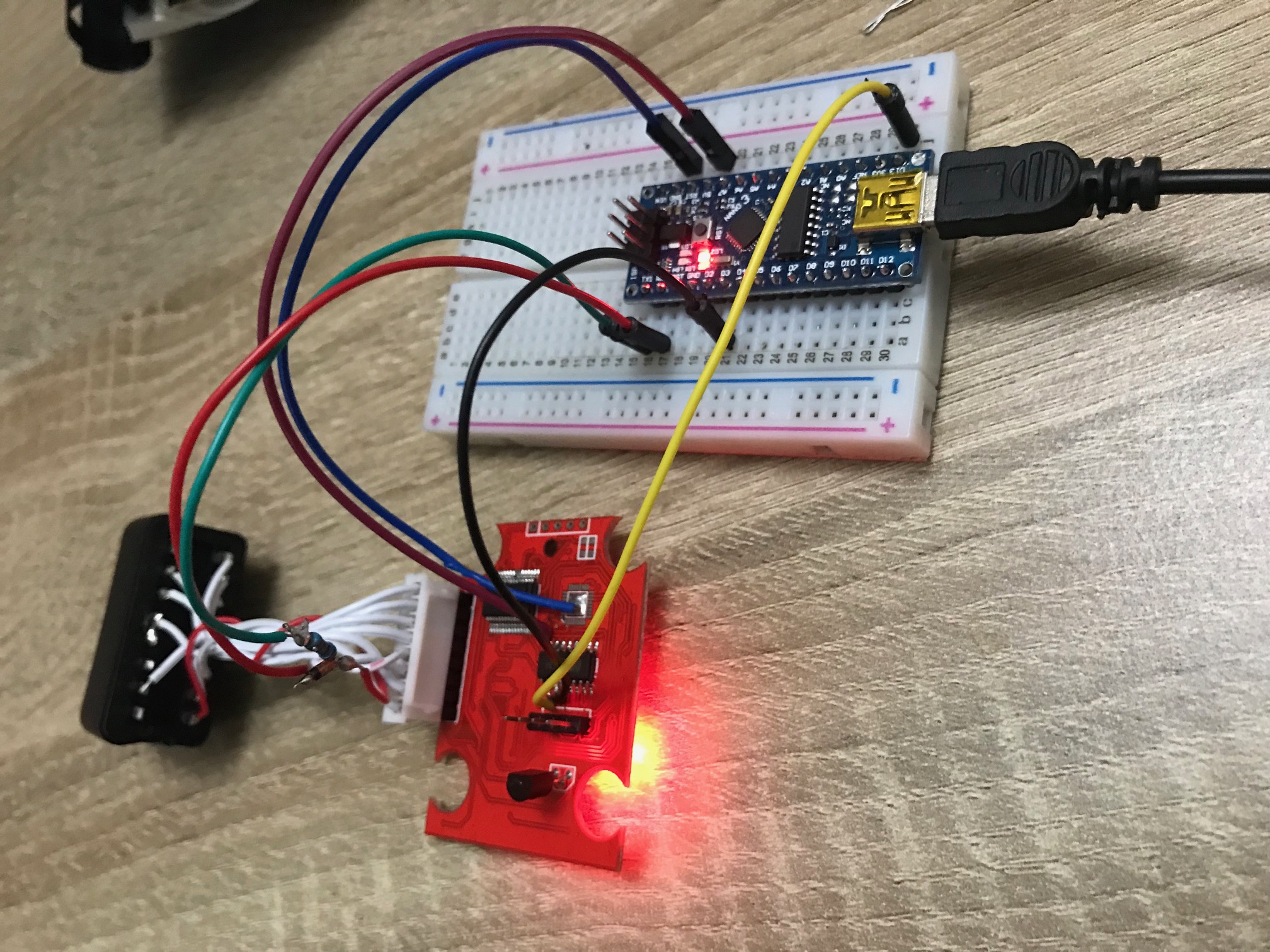

cannibalised a crappy china elm327, added aldl interface without the serial conversion for now just to try and get an idea of how to make it all talk lol
cant find much on aldl on Arduino and obd2 seems split down to individual protocols instead of a complete library but ive only been looking for 30 mins or so lol
