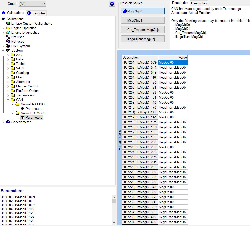

I've got some experience with the pcs controller that zero gravity sells with a custom firmware to run the 6l80/8l's in swap kits.
While it works, the software is PIA to use since there's no real instructions on the tables/options that actually work to do stuff, so u kinda have to figure it out on your own. Which is why im all for getting as much code integration as possible before going down the standalone path (if compatible ecu works etc), unless there is software written & clear descriptions on what shit does.
When i get some time, I'd love to work out what code changes were done in the 6l80 tcm oses that changed between 08-09, then 10-14.
I can flash an 09 to a 08 os and it work in a car, but a 2010 is completely incompatible, I believe it's to do with the broadcast data changes in those years. To add to this I have a holden pim from our vz model that had the e38/t42 if i place a 2010 ecu on the bus, the data the pim reads is completely out of whack, an example would be with the engine off it thinks it's doing 6500rpm, but plug a pre 09 ecu in and it reads perfectly fine.
I know the TX/RX data can be changed in the ecu calibration, to define what messageblocks are sent on addresses. I just haven't dived that far into it.

I see Ross actually got around to implementing my CANbus options request, at least in the E38 OS before retirement. Good man..
What you have there is the full CANbus RX / TX ID list from the E38, which includes both of the GMLAN protocols possibilities early years. The "Corvette Only" version as I call it are the ID's in Dec, and standard GMLAN are ones in Hex. Or that's the easy way I remember it, have the full list in a spreadsheet also that another EU member and I hashed out years back. But that looks to be everything in the E38 from the original 1999 code.
However, as you mentioned, there is a couple possible GMLAN TCM related additions after 09 that might not be in the older E38 OS versions. And there is roughly 11 more messages that T87/A requires... My original request to Ross was an ability to reassign actual pins or PIDs to those ID's listed. But years later, realize that wasn't a simple bit switch like he has implemented in the 38. Would take some major work, likely a full recompile from scratch.. However, this same CAX file approach with an ON or OFF for each ID requirement is what roughneck427 is researching for us for on the new TCM. But likely as a custom OS release that is backwards years compatible so specific year. Just depends on how little data this TCM will actually operate with...
I haven't played with these new E38 CAN options yet, but will load one up here and have a look. Also have a couple T42's on the bench, which by my account, should work with all those ID's above. Was there a different OS for the T42 and T43 if it was in a Corvette?? And please provide some more details on you T43 and that pin swap.. Might have an idea of what you are encountering. But again, I don't see any physical reason we can't run ANY ECM against any TCM, of any year. Just gotta hash out the Happy Data..

Those are custom data i pulled into a cax file based of os 12609099, then kinda semi-massaged into 12639270. i have not verified or dared to make changes to that stuff yet. lol.
I have been reading through the GM specification docs like GMW8762 to get a good understanding of how they do stuff.
