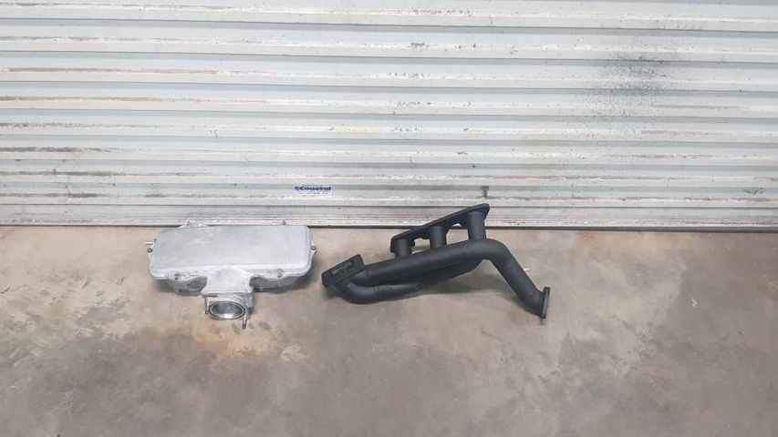

Theres a fleet thread somewhere but a couple of you suggested it was time for a build thread, so, watch this space. I took my track hack and applied a turbo to it. Its been a WIP but I'll break it down into sections. Got alot of inspiration from mates and those crazies at Nugget Garage with Kevin.
....I contacted a dude off Stalkbook (shout out to Tony'z Turbo Garage) after I found him on Stalkbook - based on this concept.
....I already had my China turbo
So just asked for the Inlet manifold (delete EGR, reverse TB and block PCV) so this got made along with the crossover from the drivers side (not shown)

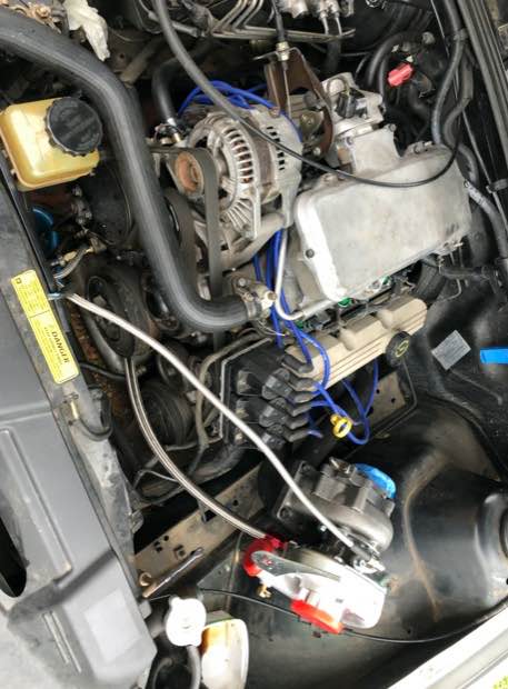

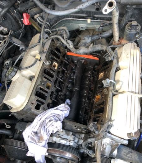

so we start about here. valley gaskets because mud in the radiator per usual. simple job. except for that fucking O ring that goes on the heater line back into the valley.
then i put it all back together and found that i had fucked the fuel rail. the VT is steel moulded shite, and, i ended up with an injector leaking continually. VS fuel rails fit the eco fine, so, on they went thanks G sack. i put stock injectors in there to make sure that it still worked and i didn't fuck it up - all good

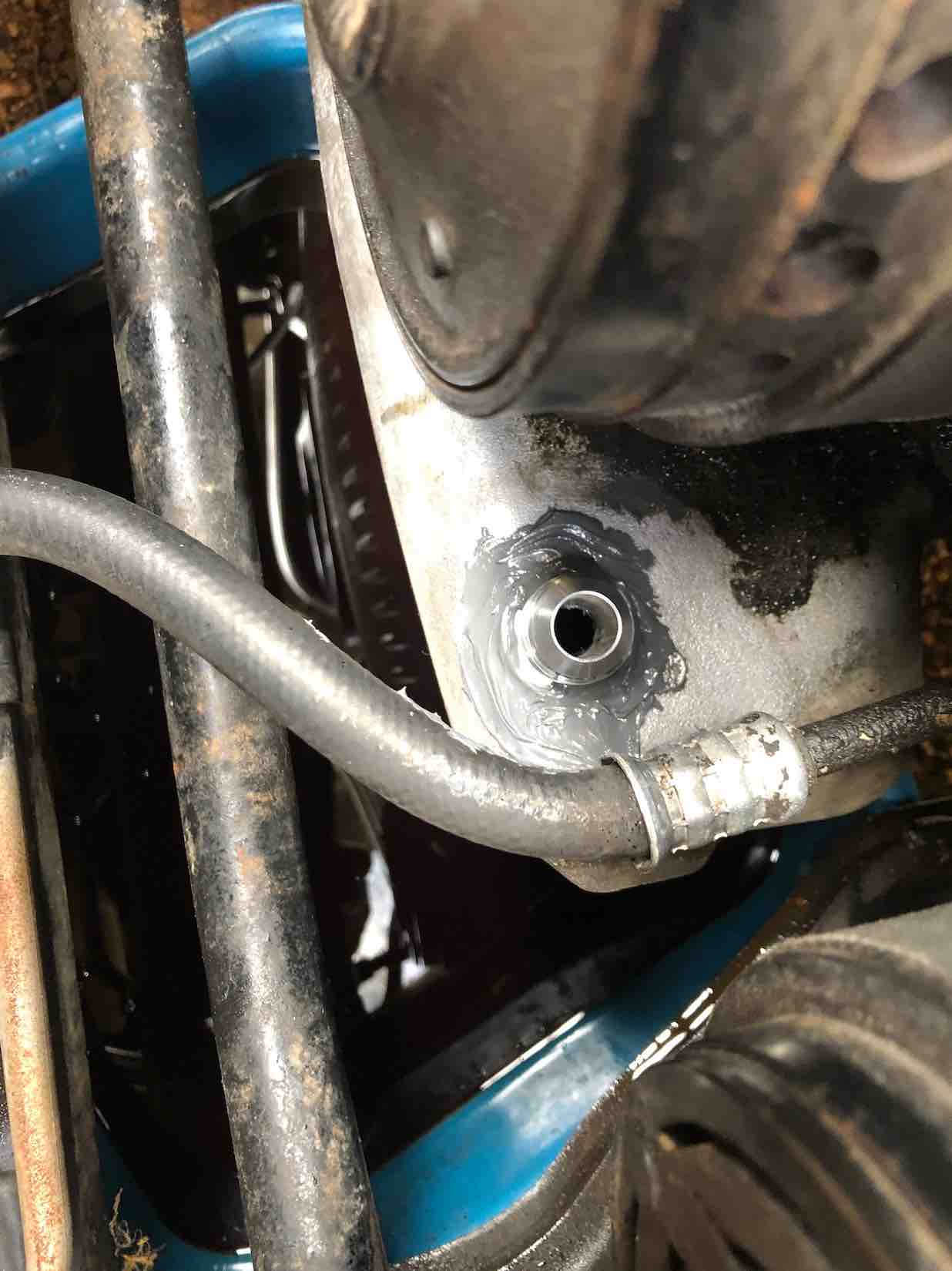

was then time for a hole in the sump for the return line.
got my nice 13mm drill bit and made this (yeah i know it looks like its about 2mm)
was no way i was taking the engine out / dropping the k frame to do the sump as i dont have many of my tools any more ; so this happened. JB weld for the win. this shit is mint.

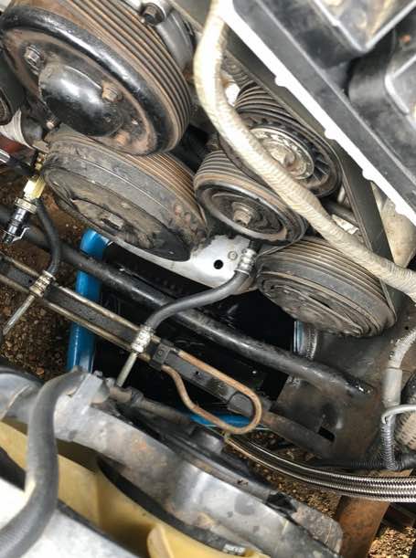

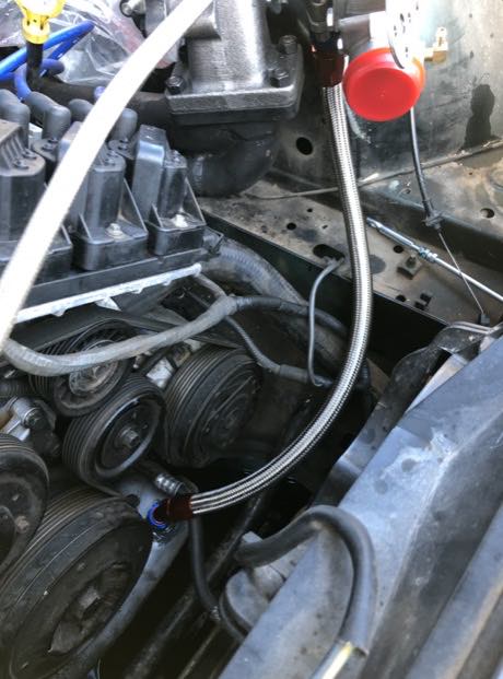

then went the return
and feed

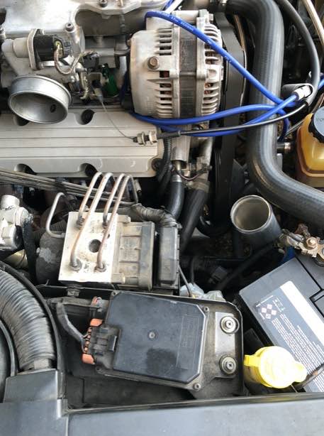

then it was time to munt the intercooler. its a smol boi at 450x300 but taught my son Ryan how to make brackets and grind.

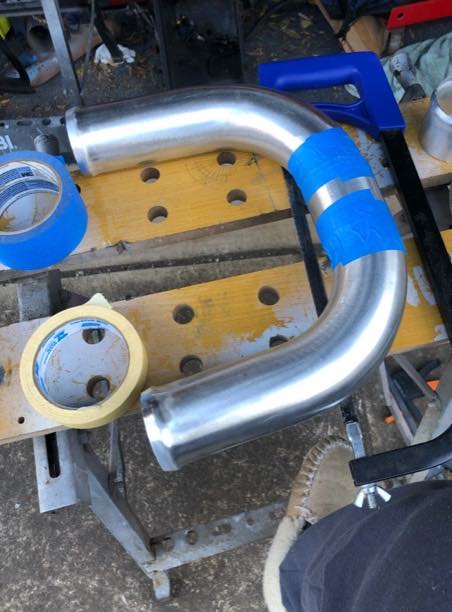

then came the intercooler pipes. i used blue tape to 'weld' them together and get the angles right, i failed maths so this shit for me is uber hard. note if the tape was flex tape welding would not be required. #becauseflextape #flexseal
welding time. i have a MIG only. it is old. like me. T sack came over because he can MIG vs me who creates bird shit. it took us half a day to sort out my welder with the feed keeping jamming up but, got some good beads down and i ground them up so they look nice.
mount all that shit up, the other side to the inlet manifold is TIGHTer than, well you know what. plus i now own all the silicon pipes in Australia.

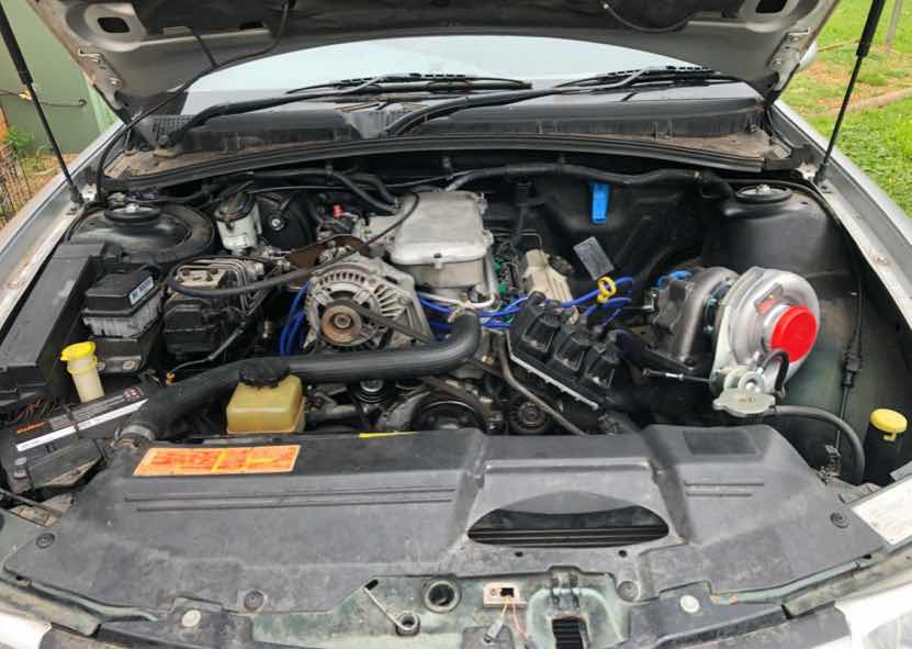

and per yesterday i got to about here.....with a successful start. i was shitting myself because i ran it at first with no oil return hooked up so i could see the oil, basically, return, and, it didnt. took the T piece apart off the pump, oil was there, checked line for blockages, all good. with cranking pressure the oil would only just get in the line! so primed the feed on the turbo with oil, and started it and let it run a bit longer. to which it then came through fine. alot of fuss about nothing just my lack of skills and experience shining through - thanks to the T, G and V sack for chiming in.
was kinda funny as when i pulled the fuel pump fuse, i figured it wouldnt go. fuel was still pressurized in the rail, minute i turned the key it went! even with the 42lb injectors and stock ecotec map at this stage as well! i havent changed the injector size (yet) still got some things to do like

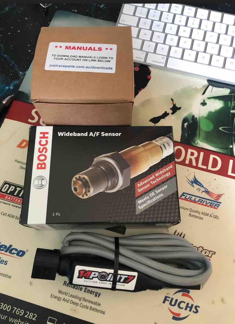

OK so more real time updates - but my wideband OS2 sensor just came in the mail. Dunno about everyone else but the mail seems to be working AOK for me down here in the Corona Capital of the Universe.
the brown box has a gauge in there for WB OS2 reading.
