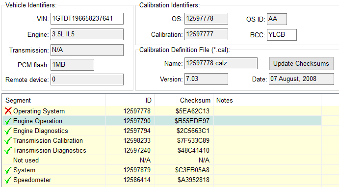

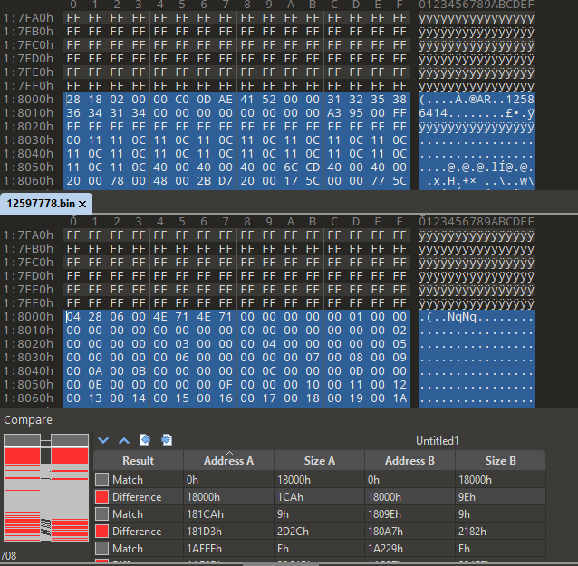

antus wrote:This is the OS segment you need, I dont have a complete file but if you make it line up you should find the flipped bit.
Strange the first 0x18000 Bytes do match then after that my file has what apparently is the speedometer cal.
Posts: 8257
Re: PCM Hammer P12 development
can you post yours up?

antus wrote:can you post yours up?
Here it is.
12597778_corupt.bin
(1 MiB) Downloaded 97 times
Posts: 8257
It looks like the OS segment is split, part at the start of the file, part after the calibration segments etc. Apply a 163840 byte offset (decimal) to verify the second part. This aligns the SPS bin with the end of your file and the data then matches from the point you have highlighted to the end. Your bit flip is at 45D9F in your file which is F9 in the corrupt file and its F8 in the factory file.
