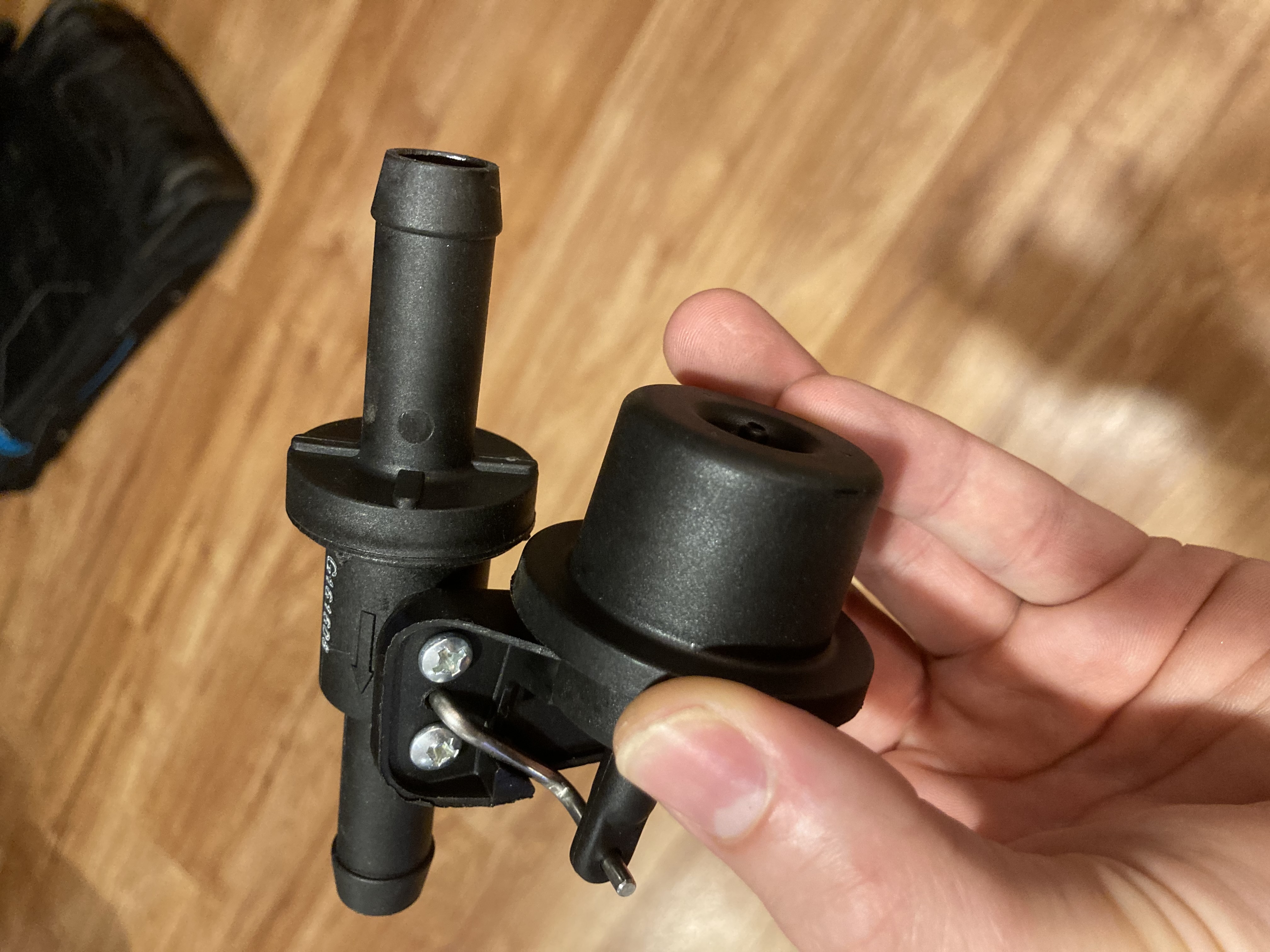

Does anyone know of a good quality vac operated heater tap that easily adapts to the VN-VR? A universal type or perhaps a genuine OEM one from another make?
It's become apparent that the ones for VN-VR, weather MacKay, Gates, Dayco or whatever, all have their quality fall off a cliff since covid, or at least since I last bought one.
They all either jam up, allow coolant to pass in the closed position, and the issue that is really driving me spare is air leaks into the system (less of an issue is the coolant leaks but they eventually start after the air leak is well set in)
Typically I only get a few days or weeks before these problems crop up and I have tried all of these brands with the same results, and I can confirm that they appear to be different suppliers at least for the visible parts of it.

I found this one, it says BA/BF falcon but it's in NZ. When I google BA or BF ones on google, I get like random heater tap pics of all kinds, so I can't confirm if this is what they look like.
Either way, if this is OEM it might be long lasting. The all plastic construction suggests the end cap is welded on, not crimped. This crimped join is where I suspect the air leak occurs, it was the point that coolant was weeping on the last one.

RHV2005 is the repro part number if anyone needs it. And the same part I believe as the Tru Flow brand is TFT2005. Appears they are all of this same tap but under re-brand. MacKay, Gates etc.. All have this plastic one.

That's the one I am having problems with. Never had any issues over the years until the last year or so, they are all falling over in short order.
The quality of them has tanked in my opinion.
I manged to fine some HV2005 ones on ebay for 17 bucks each, so they are on the way. I'll update this when they arrive and are fitted.

I updated my main thread with the new taps, but also figured I'll update this one the same since that is the subject.
Heater works as intended again, fits same as the stock one, just little longer on the barbs which was no issue at all.
Interestingly, the arm only moves 1/3 of the available arc to fully close off, the old one was the full arc and it still leaked coolant past.
The plastic seems a lot more durable like an irrigation type of plastic with the addition of typical automotive glass reinforcement mixed in, and not brittle like the original type which was a bit more like Bakelite.
