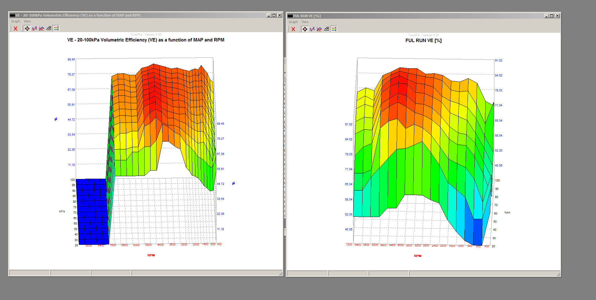

Yea I was thinking it would be fine. I'll look at swapping over the VE and ignition maps. Boy they were a mess from GM.

The 12P stock VE table is very good for VN 2 and VP.
I used my tuned VR 12P map with pacemakers on my VP with pacemakers too and when retuning with the wideband there was 0 difference from the VR map despite having lower comp, only thing I did was add a certain percentage to the complete map until I got 2º to the peak WOT timing for the VP for the lower comp.

Had a look at the newer and old VP factory tunes. Didn't see anything really different apart from a single cell mistake in the VE table of the tune you mentioned. So don't know why the later VPs use so much fuel compared to the older ones.
As for 12P vs the factory VP tunes there isn't a massive difference in the shape of the VE table, obviously the 12P one is a higher res and more precise so I would still use that over the factory VP stuff.

Got me convinced. I'll go with 12P. Yea vlad that big hope at one point is a glairing error but with interpolation it probably didn't show up in the driving.
