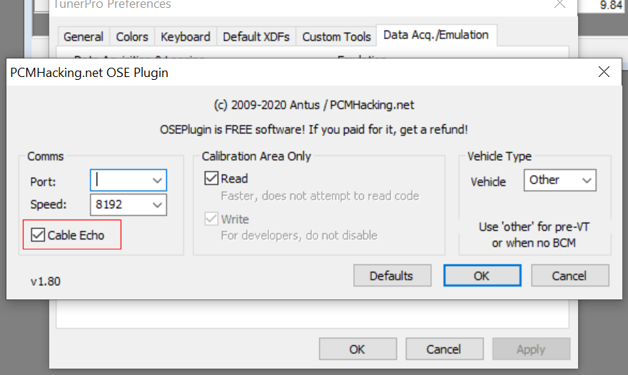

Got it working tho lot of errors when data is flashing on screen

you probably have the wrong echo setting for oseplugin.

- Posts: 9045
Re: Tunerpro RT Datalogging & OSEPlugin Getting Started Guid
No its in the oseplugin settings.
- echo.png (85.52 KiB) Viewed 41804 times
I must be doing something wrong as it looks like im under same data acq tab but dont have the options you do ?
Under emulation is no ose plugin option
- Posts: 9045
Yeah it doesnt look like you have installed oseplugin. See viewtopic.php?f=3&t=590
