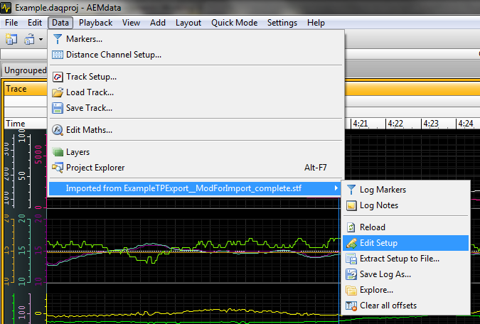

It was mentioned a few weeks back that AEMdata could import CSV files (http://pcmhacking.net/forums/viewtopic. ... 190#p53948). Had a look and overall AEMData looked like it could be very useful, heaps of features just playing around with the demo project files.
Well it turns out that the feature is no longer working in the current release 4.1.1, but there is still a workaround to get TunerPro logs imported :thumbup: You need to download and install two programs...

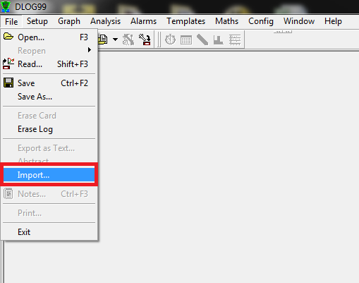

Now open Dlog99. Under the file menu select import...

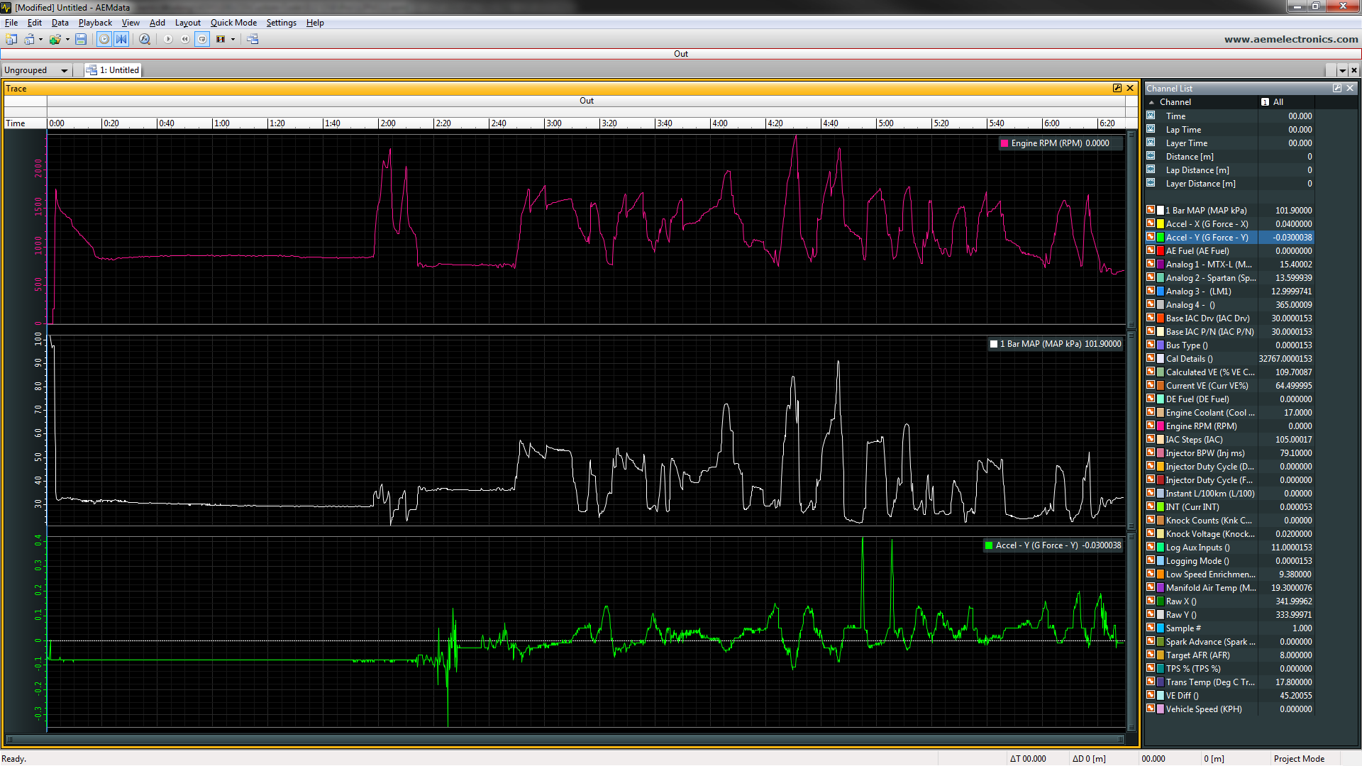

Now open AEMData and choose 'Open log file in new project', then empty project. It will open a file explorer, select the stf file you previously saved.
And that should be it, can get all the channels in AEMData. Happy playing :D

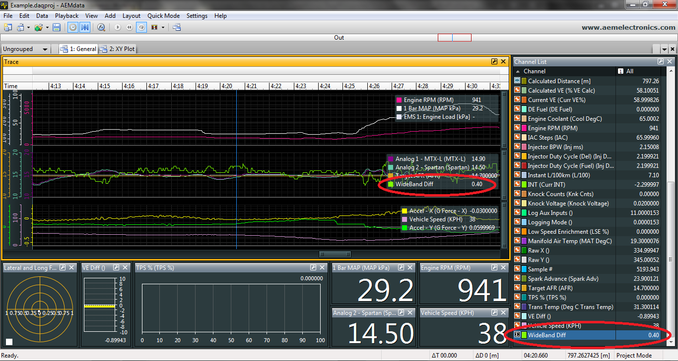

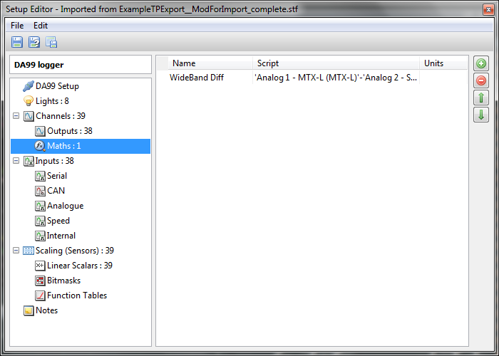

Did you get the Maths functions to work with the Dlog imported file? I couldn't get it to work previously, I think it had to be in the newer file format which Dlog doesn't support, didn't have time to see if I could work out the new data format.
Re: Alternative Data Analysis - AEMData
Correct, math does not really work with this free option when working with STF files.
The solution is Gems Data Analysis Pro (it wasnt mentioned in the original post as it costs $$), it allows CSV import and math functions. You will find this software looks very similar to the AEMdata software.
Edit: What does work in the free AEMdata is math applied to one data log, you cant have a math function for an entire project.

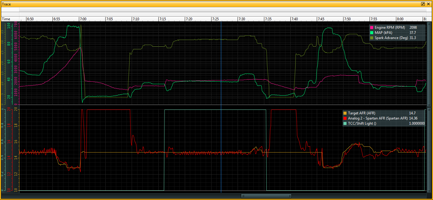

Updated the macro to now handle flags, it slows it down a bit so have left previous versions. I dont know how to import flags from CSV with ASCII names to Dlog99/AEMLog (might not even be possible?) so it replaces the flag state text with a 1 or 0 (there is a lookup table of names that you can add to).
All flags can be shown in the trace view which is handy, shown here is TCC lockup...
