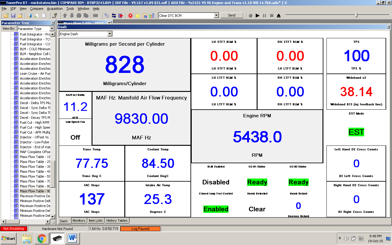

hey guys just a few questions for anyone with super6 knowledge, my bro just picked up a l67 vs stateo cheap cos it had blown the inlet gaskets and filled the sump with water, so after doing the gaskets we took it for a drive with the lappy connected to see how things were going and all was good.
after that i burnt the memcal with vt xu6 spark maps(& 98pulp) and went out logging to see any difference and was surprised how much extra pep it had and a roughly a 50 mg/c increase as well, which brings me to the question its currently showing around 9800hz & 230 g/s this to my understanding is almost maxing out the maf but this vs has bog stock pulley, cast headers, twin cat exhaust ect but reading here ppl say 10psi pulley almost maxs the maf.
our plan is to boost it to 10-12psi & install extractors for some fun but but dont want the hassle of having to find a bigger maf & extra work can anyone shed some light on this setup as to whether or not its reading right?

I think I got similar numbers when I logged our bog stock VX L67.
With the enhanced code software is no longer a limit but the MAF would be as it's limited to about 256grams/sec. Full details can be found in The1's enhanced thread.

Thanks fellas just to clarify will the extended bin fit on the factory memcal or do I need a nvram? I'm not really interested in realtime tuning as it's only a little side project, but should be able to get an ls1 maf easy enough.immortality wrote:With the enhanced code software is no longer a limit but the MAF would be as it's limited to about 256grams/sec. Full details can be found in The1's enhanced thread.
Re: vs L67 logging questions
functions idential to stock, just extra features, can burn it to a stock memcal or a nvram. Most stock MAF's will goto 10,000hz if your planning on anymore mods then chuck a VZ LS maf on.

Thanks the1 that's what I wanted to hear! Problem solvered lolThe1 wrote:functions idential to stock, just extra features, can burn it to a stock memcal or a nvram.
