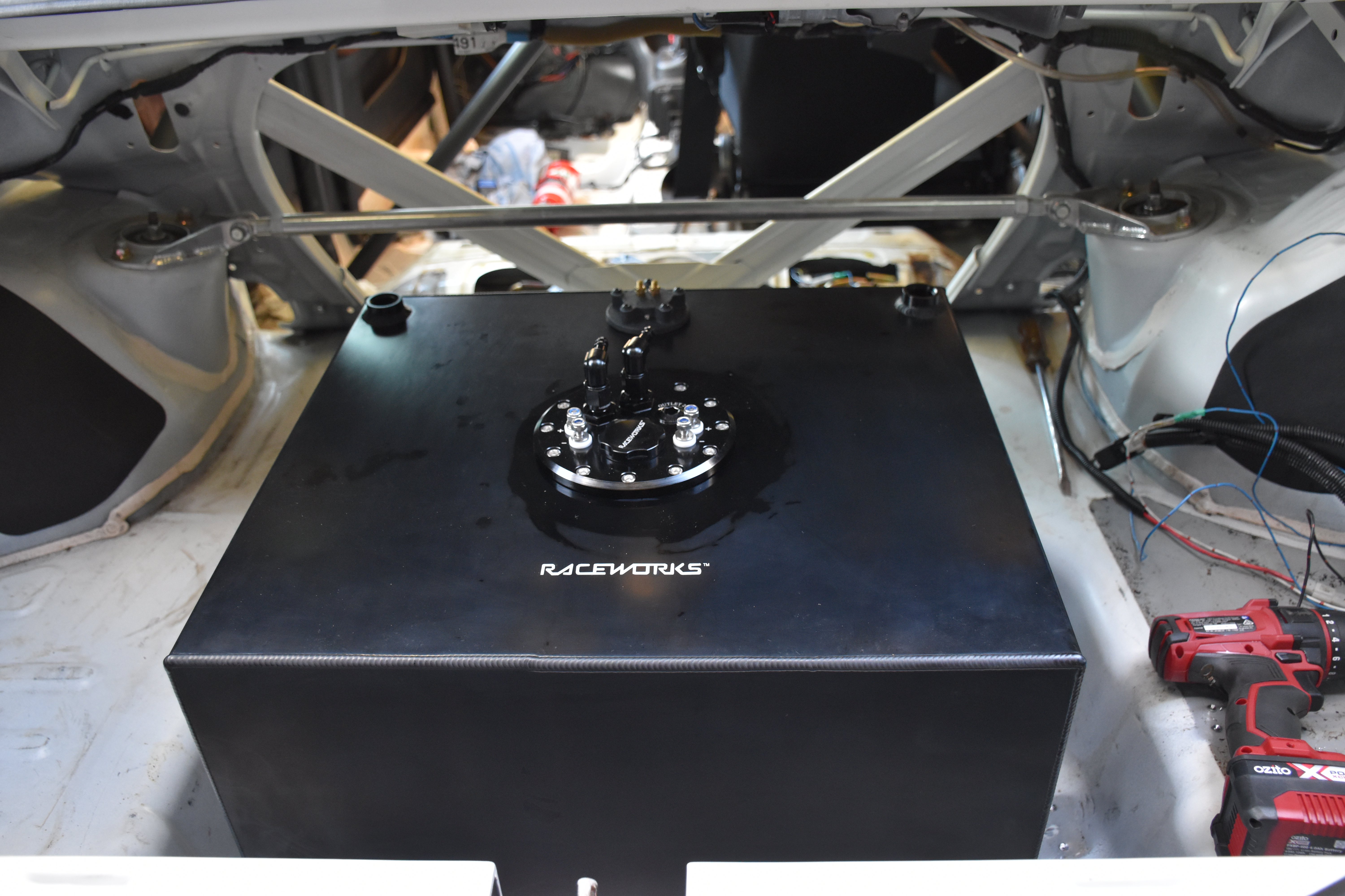

Car has been starting and running fine so I decided to fix the sender unit and took out the pump. OMG the amount of rust inside over everything and the scale floating around the tank now confirms I was starving for fuel after a few laps. I am really thinking the log is displaying a 100% fuel cut on decel but I can't tell because the logging of the TPS dosn't work. I must have the wrong address to get that MUT data. Anyway after explaining the essentials to the wife here is a pic of the latest upgrade to fix the tank problem.
