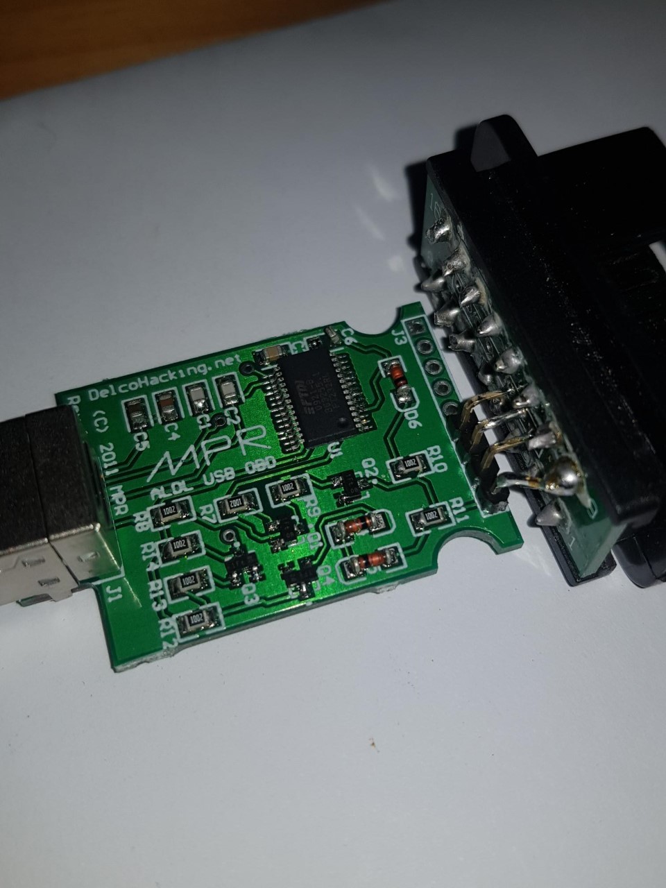

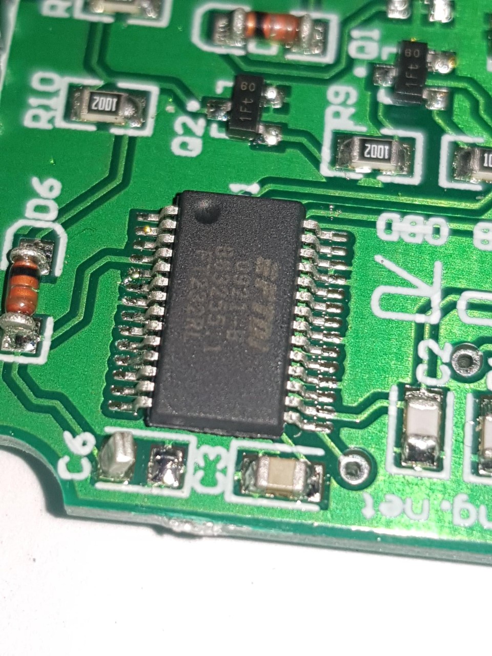

Heres what it looks like with close up on the lifted capacitor

Most certainly isn't a fake. That'll be the build number/serial ect of the chip.

I wouldn't expect the cap to be lifted on purpose if it wasn't needed it would be removed

i dont think c6 should be disconnected either but i'll check against the later versions and compare againt you pic. the aldl line does have a resistor on it so i dont think its shorted to ground, just pulled to ground. if you open say putty (google it) with comms chosen and the right com port typed in, can you see whatever you type echo back?
