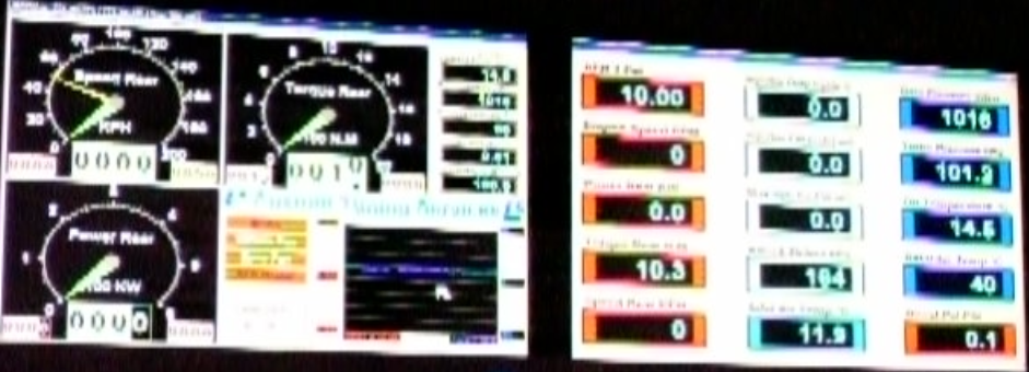

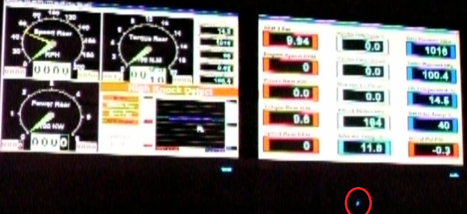

Well I've had the module for a week or so & done a little bit of testing, still trying to get my head around which settings to choose to set it up!
I've managed to get the output to trigger on the dyno (attached grainy photo's) if you look on 1 of them you can see the blue LED lit up of the module, then on the MAIN screen of the dyno in the middle you can see HIGH KNOCK DETECT, then on the other image you can see where all the data is it has lit up red in the middle saying a figure of 194 & then there's a standard image of when it's just stock which sit's on 164-165!
All the numbers are irrelevant as I'm just using the map2 signal & seems the LED of the module triggers, then the main screen detects it & then the value on data screen!
If I can figure out how to upload a video to you tube I will put it on, but the images are just screen shots of it & pretty crap quality too!
- Knock Detected with blue LED.png (514.44 KiB) Viewed 7976 times
- Knock Detected.png (683.25 KiB) Viewed 7976 times
- No Knock sitting 164-165.png (445.95 KiB) Viewed 7976 times

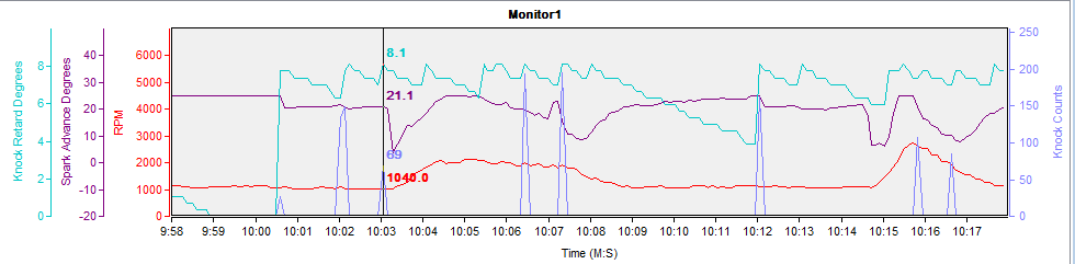

You were making much better progress than me, my first attempt to hook it up to my ECU crashed my laptop - and my second try stalled the engine and crashed the ECU
So I had a look at the 808's schematic to work out what I was doing wrong, and 3rd time lucky: I had the knock filter wound up to make sure it showed even the slightest bit of knock, and added heaps of timing until it started to ping

Never having logged a car with a knock sensor I wasn't real sure what it *should* look like, but when I compared the ignition advance and knock count history tables, there was a clear correlation between them so that was nice to see
