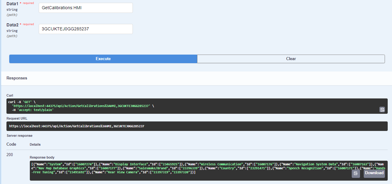

I've found their system so unreliable, that I went to the extent of rigging up my own Tazzi-SPS to pull the latest calibration numbers.. and will host the files on a local server to pull into software.
Im still working on pulling the actual calibration files down for any missing, but they appear to called using a secure socket connection to their servers. Its technically a simple request.. ie... gmservername.com/getCalibrationID (along those lines) and then a post frame is sent.. but this request is sent after the socket connection sends the encrypted data to a proxy server.
About ready to just decompile SPS2.. import in IDE and just start stepping through the code until it can be pulled 1 by 1 :lol:
