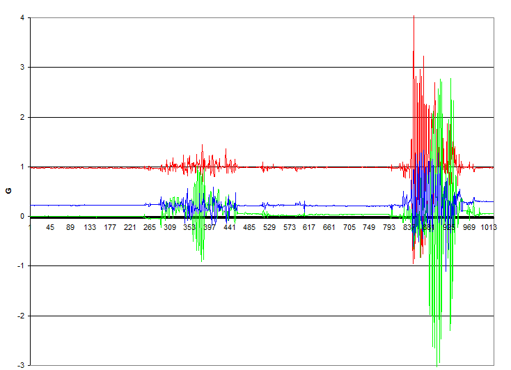

I was mucking around with my logger a while ago and wanted some analogue inputs for a 3 axis accelerometer.
I would have used SPI, but the one I had on hand was an ADXL335 analogue sensor so thought I'd use that.
Plus, I have a few more sensors I'd like to add to my car so extra inputs are always handy so I knocked together a USB 10 channel 10 bit ADC module.
I haven't got it properly integrated with the display yet but it's logging data well enough.
Here's a log of me giving it a bit of a shake - the red line is the Z axis, hence the 1g at rest compared to 0g for the X and Y axis:
I still need to calibrate the channels - the Y/blue axis is out by about 0.2g...
