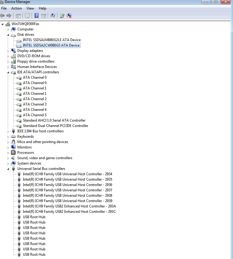

- Posts: 2882
Re: Win7 x64 lost hdd partition
As stupid as it is... I downloaded most of the stuff last night (none of it helped on the actual machine it previously ran on)...
But before I even tried that I had an old desktop I hadn't fired up for 3 or more years I OC'd & had an intel SSD in it, so I plugged it into that & fired it up & without installing or doing anything it installed itself & got recognized... But thank you for all your hard work!
VX L67 Getrag wrote:As stupid as it is... I downloaded most of the stuff last night (none of it helped on the actual machine it previously ran on)...
Nice! Just gives another reason why not to throw out any old laptops/desktops.
Could try copy the drivers from the desktop, then install them onto your laptop? Even just having them aside for future reference would be good.
