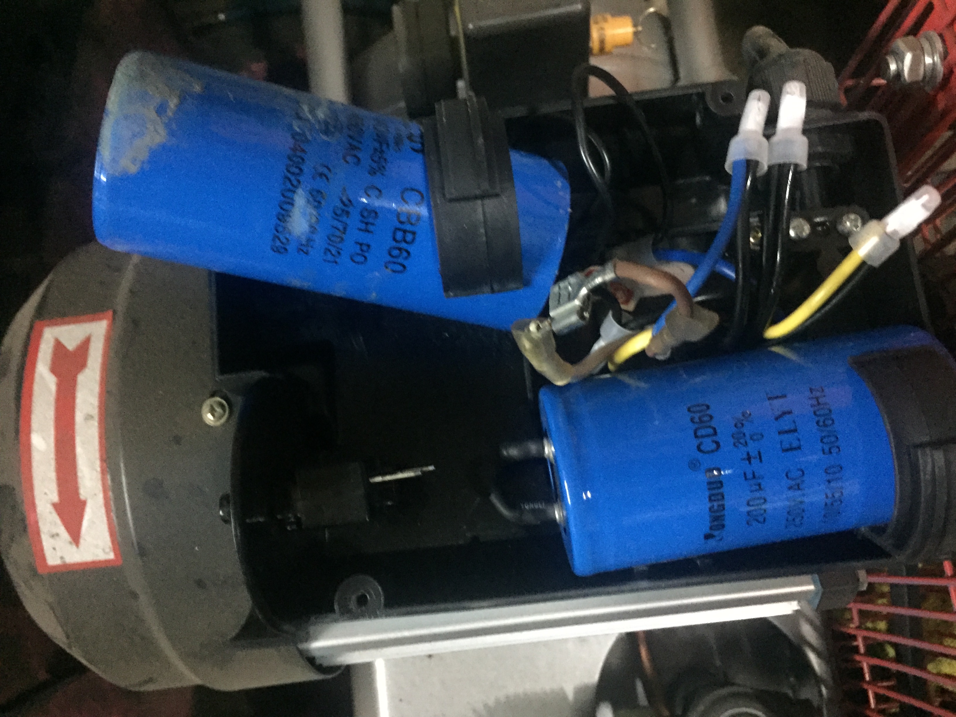

Gday, my shed compressor shat the startup cap, it is fitted with two, a cd60 and a cbb60. The cbb60 has clearly leaked. Anyhow, has anybody got any suggestions as to what to replace them with, there are $15 eBay units or should I be looking for a brand name?
Any ideas appreciated

Any Brand should do the job. Just watch the uf and voltage rating. A local electric motor rewind shop should stock some.

UF (micro farrad) matters, voltage must be same or higher.
There are polarity and non-polarity sensitive types and different technologies in the manufacturing but search fir cbb60 etc you'll get the right type.
