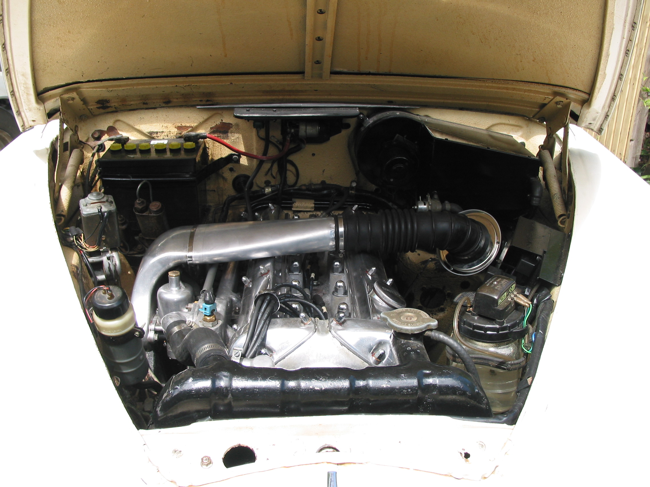

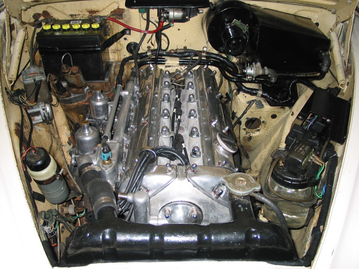

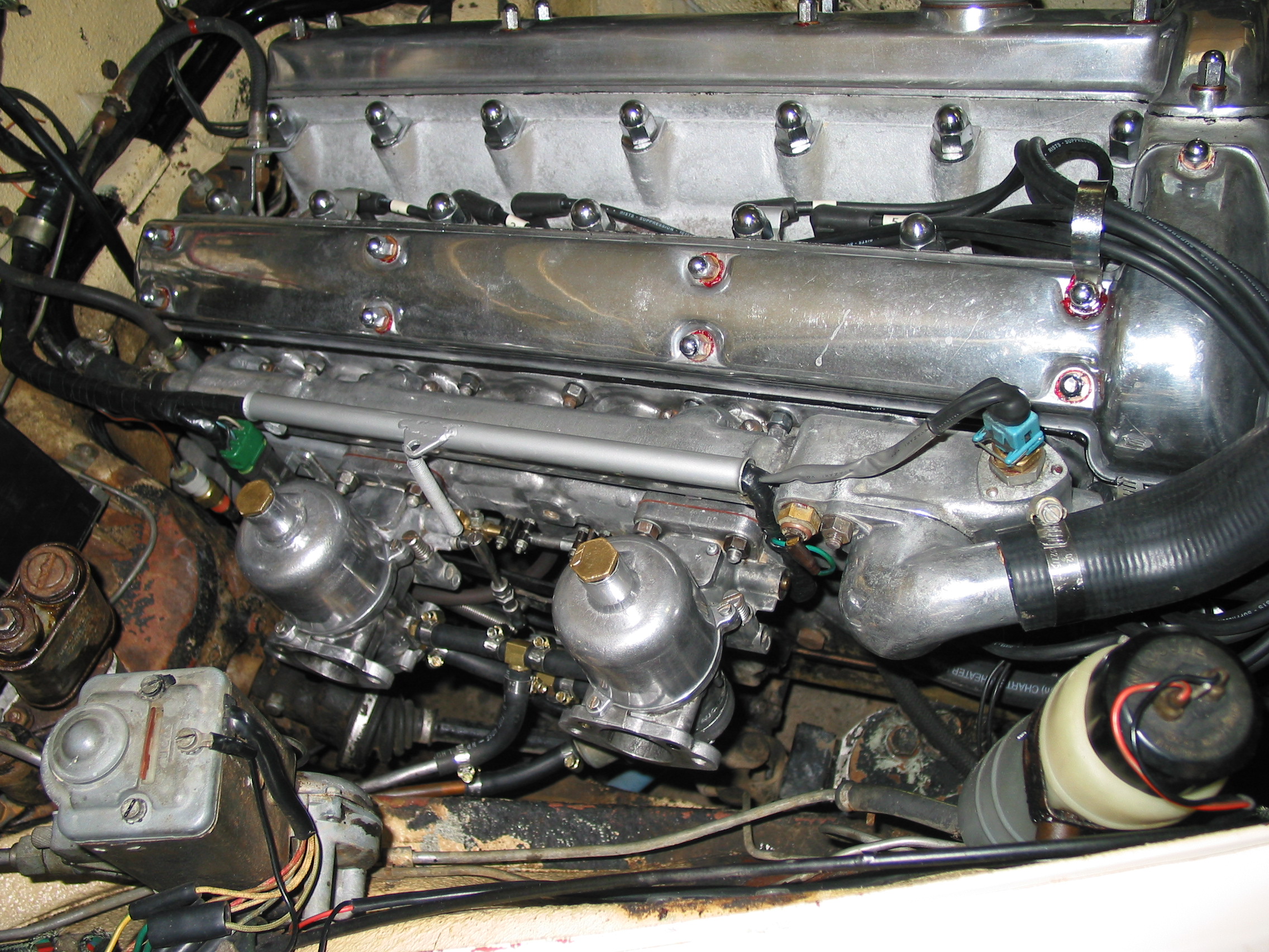

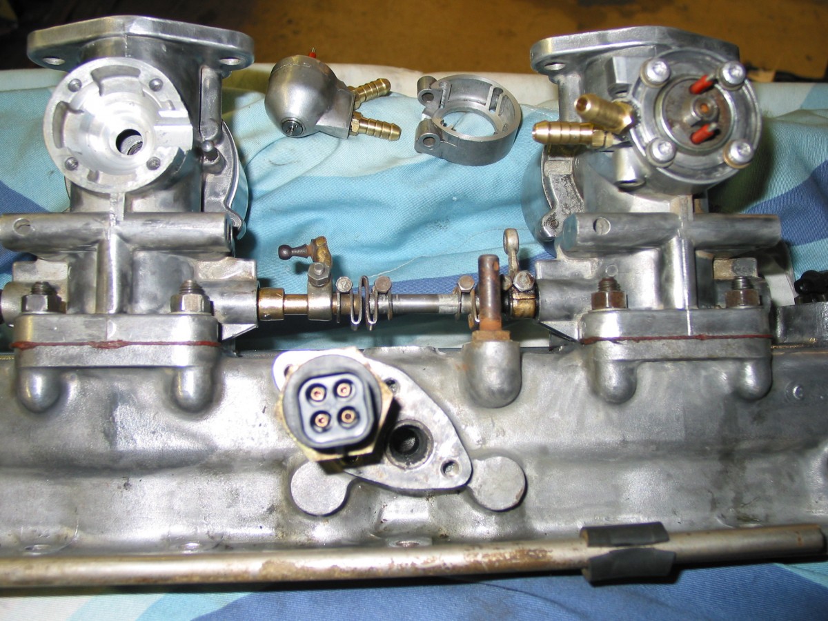

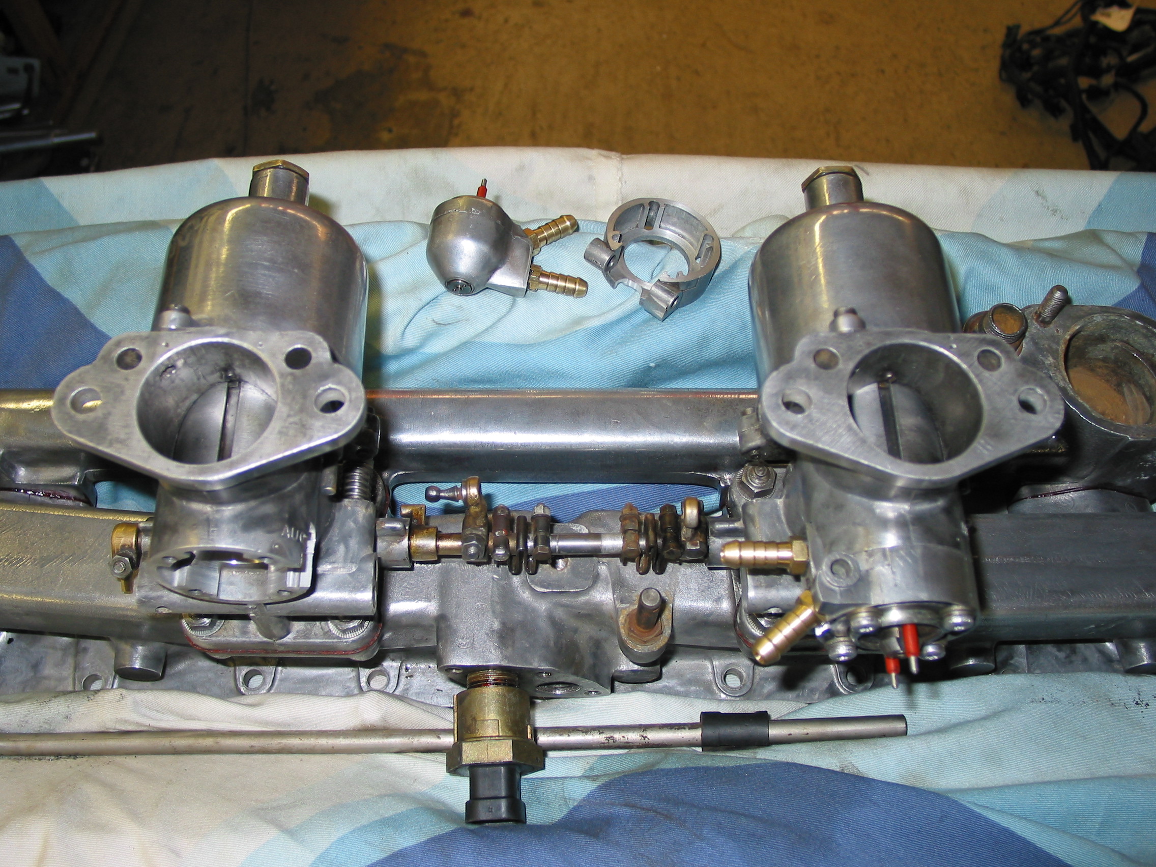

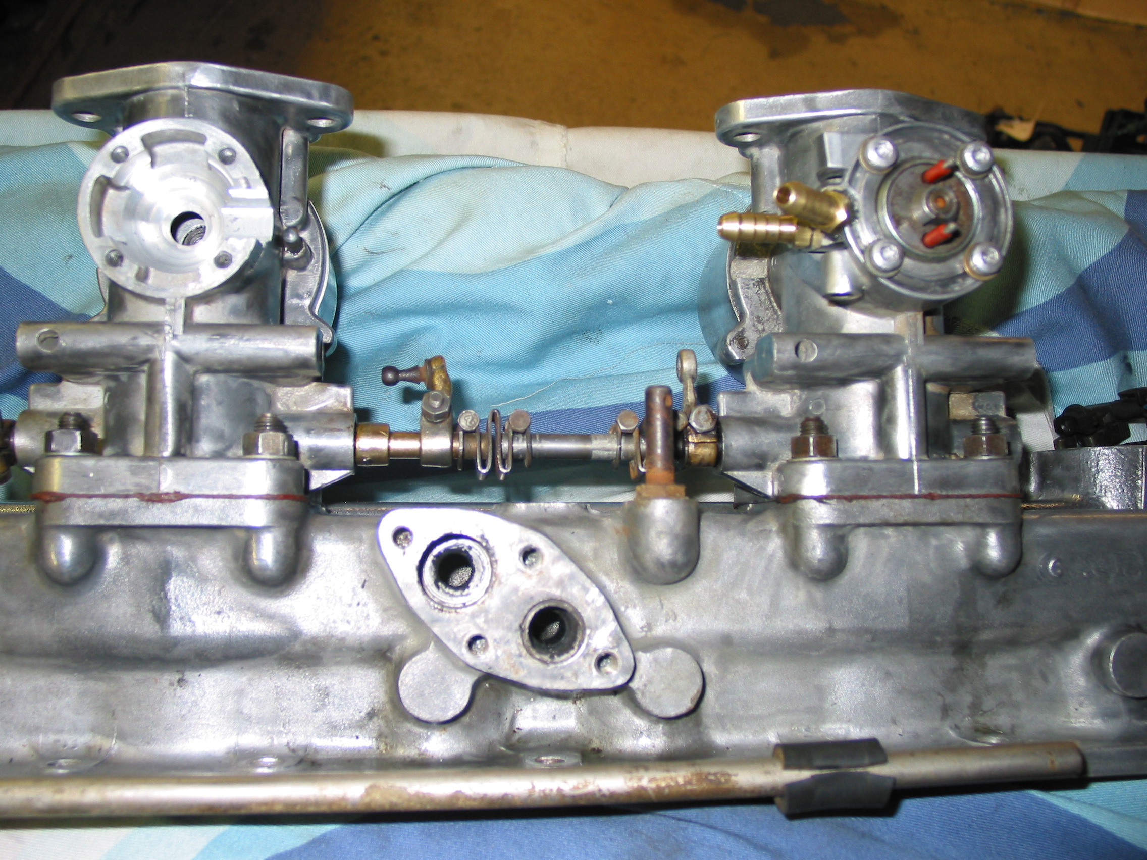

Just thought I would share.
Did this with Kalmaker quite a few years ago ,was going through old photos so thought I would share.
Twin su carbys on 2.4 MK2 Jaguar 808 running sp3 and two Camira tbi injectors mounted within the fuelbowls and crank trigger in distributor.
Wanted to hide the efi idle speed motor placed where cold start enrichment carby was.
would have been much easier to get right with 12p
