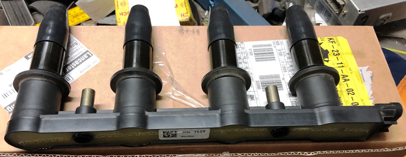

so this coil pack goes in the top of the tappet cover in between the two cams and as you can see the coils go down onto the top of the plugs
so anyways i bit the bullet and got a new set of genuine coils $300 .... didnt want to risk ebay specials! (this will come back to haunt me)

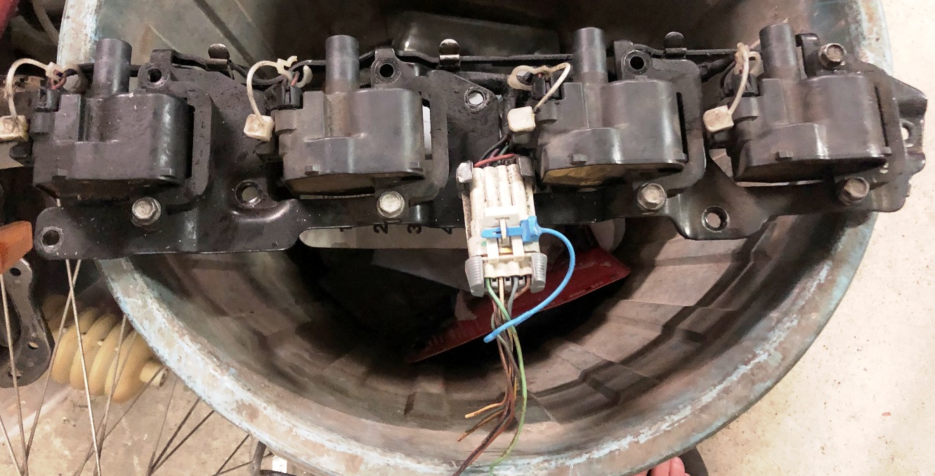

in the mean time i had a thought of using LS1 coils, and did a bit of research and it looks like the wiring to my coils is 4 x coils, power and some grounds, a quick crank over with the scope on a pin and sure enough it looks like its got a 5v square wave trigger, should be perfect for LS1 coils.
so i sourced a set (8) for about $150 delivered and im in the process of working out a patch loom to connect the LS1 coils to my original wiring connector (so i can revert to stock if i ever sell it)

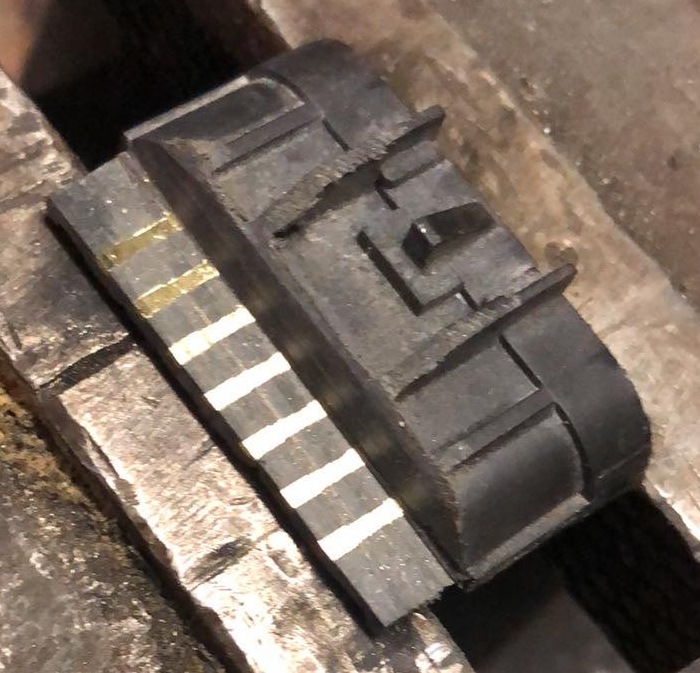

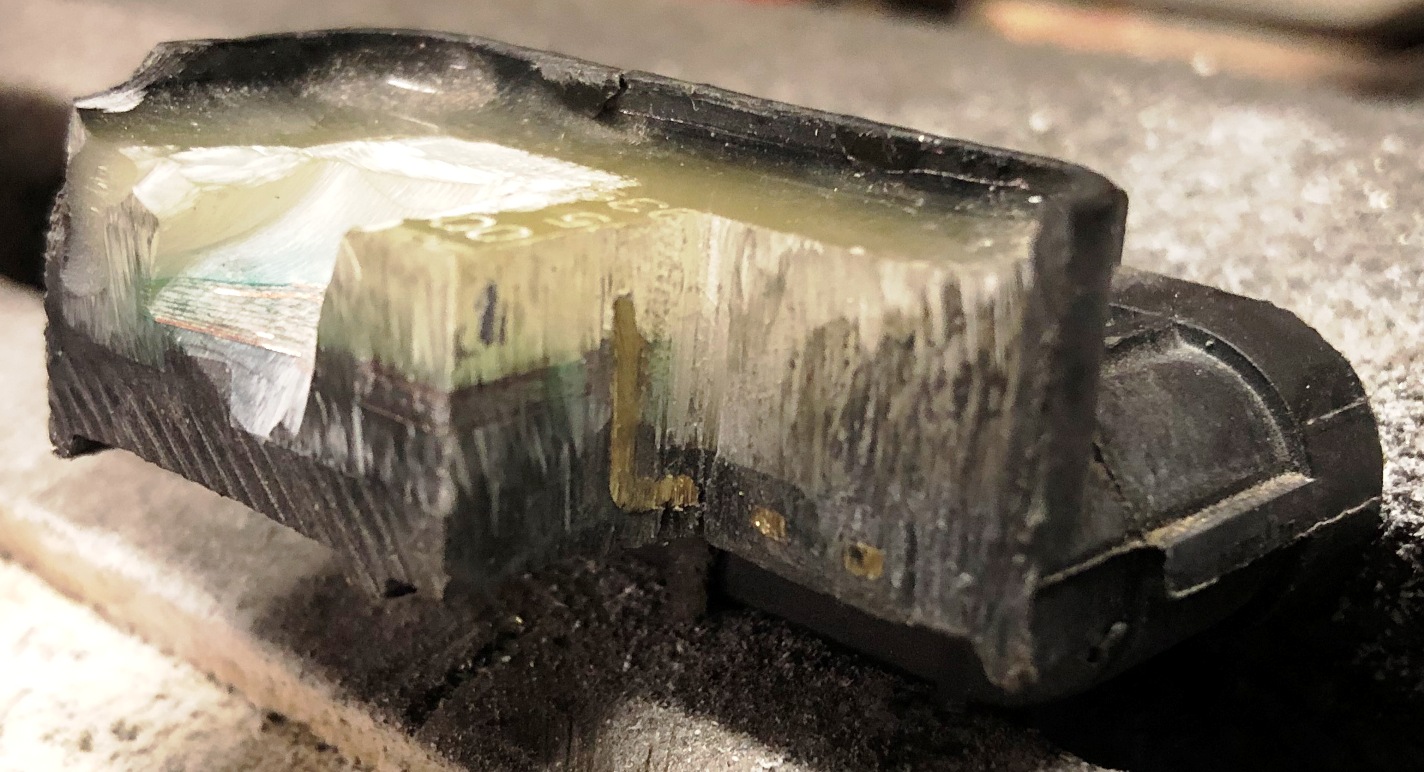

I got the orignal failed coil pack and cut the plug off the end of it, and set about finding the lugs to solder some wires to.
a bit of hack sawing and i found the pins

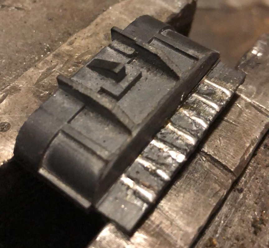

Massive progress on this!
spent a fair bit of time slowly cutting away the plastic/resin to find the pins without damaging them! so now i have a spot to solder wires onto!
Tinned with my 100w soldering iron :twisted: ready to take some wires!
hopefully now the rest will be pretty straight forward, just need to look at some wiring diagrams and plot out cruze coil pack -> LS1 coil pack pin outs.
