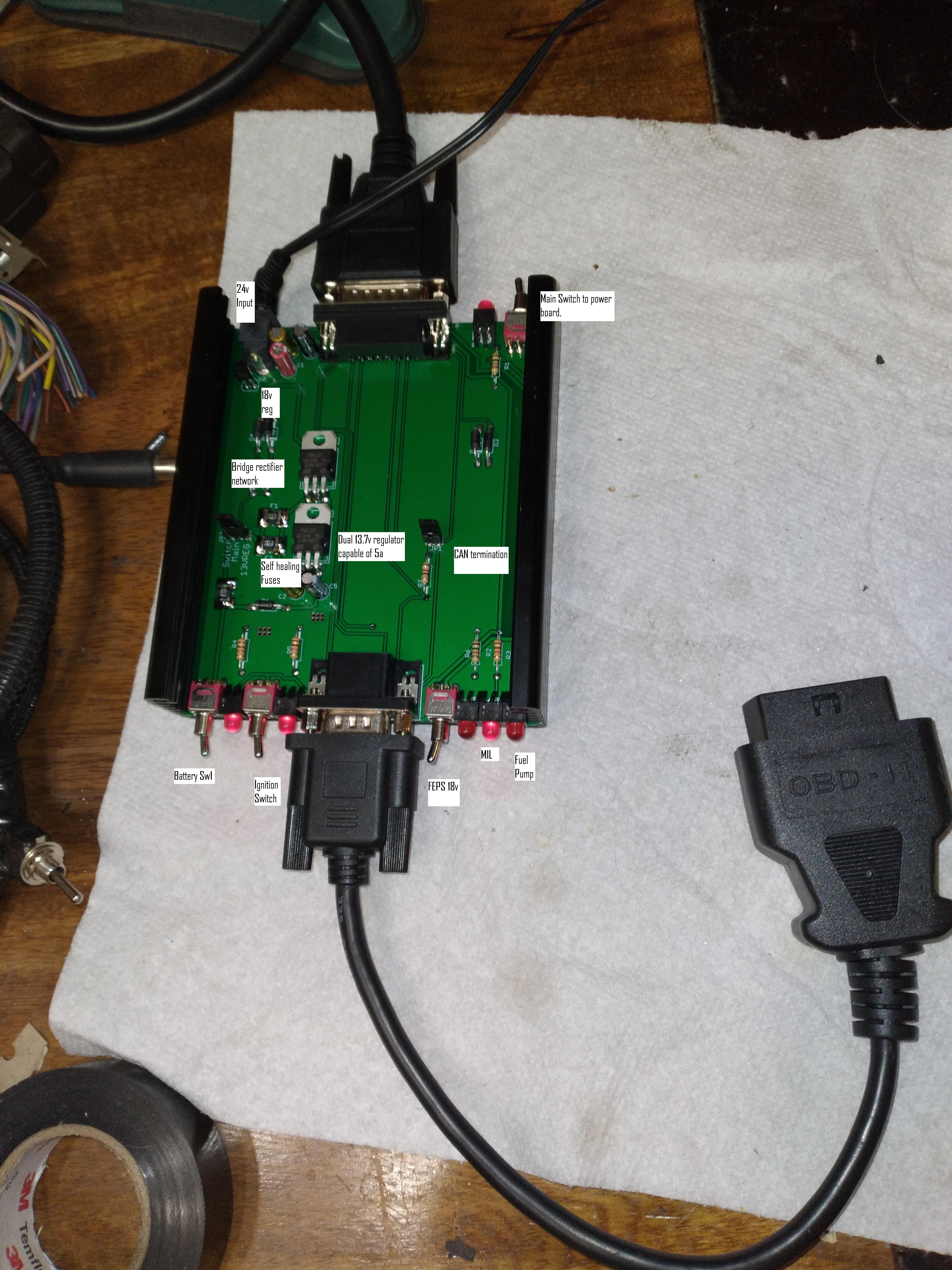

The ultimate bench programming station. The station stays the same, only cords will be changed depending on device. Will do almost all protocols including ALDL, stay tuned
Can use a battery input instead of the wall wart, if desired, via a jumper change.

Thanks bro, the price will be RIGHT for hobbiest as well as pro's ... right now it's looking like $199.95 US, includes the extruded 2 piece enclosure with wall wart 1a power supply and also base price includes the common p01/p59/p04/e54 diesel etc type blue connector. Then if you need mefi, LT1 obd1 and 2, e38, e39, e40, e67, e78, e92 or whatever, those cables will be as reasonable as I can provide too. I also have "universal" ends so you can make up whatever you want for whatever 'puter. I am pretty excited, it's been a road.

Re: The ultimate bench programming station
Dude, that is so awesome, looks real good!
I notice the db9->DLC cable is pretty short, do you have longer ones available ??
Not a big deal, just curious.
Ummm, bit behind are we ...In-Tech wrote:[05:11:45:530] PCM Hammer 014
Hiya Gampy, and thanks.Gampy wrote:Dude, that is so awesome, looks real good!
They are db15, one is vga(3 row) and the other is standard 2 row db15. I managed to get almost all of the protocols including K line and L line, CAN and of course the junk Ford crap
I don't like the 6' cables on a bench setup so I kept it shorter is all for now. Custom cables are weird and pricey(that was a friggin project), If I had your kinda money I could do anything

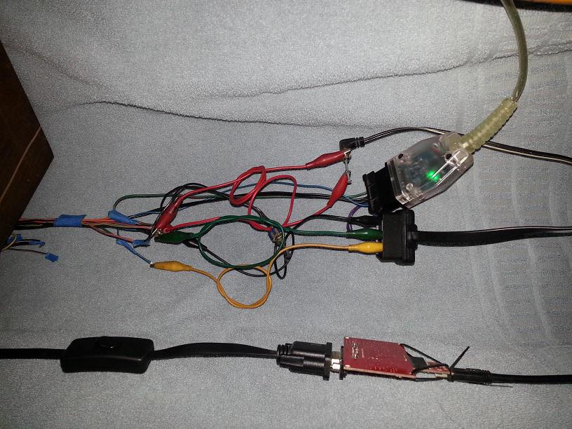

Mine is more sophisticated ...
It's got built in cross talk and accidental disconnects!
Not to mention proper color coding!
