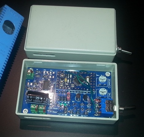

Universal speedo corrector / VSS signal converter
These can be used for correcting a fast or slow reading speedo, auto<->manual conversions, converting a hall effect VSS signal to a reluctor signal (or converting reluctor to hall effect) etc.
Works with pretty much any type of speed sensor.
Conversion range is roughly +/- 800% - i.e. they can convert a 1250 PPK signal to anything between 150 and 10,000 PPK.
They store two sets of calibrations, for easy switching between two different tyre sizes/diff ratios etc.
Price: $90 plus postage ($7 within Australia, PM me for international postage costs)

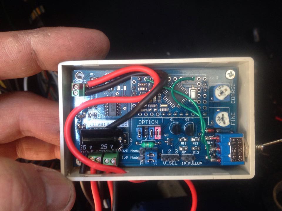

I have the proto type one, very easy to use and works great ! Thanks festy
