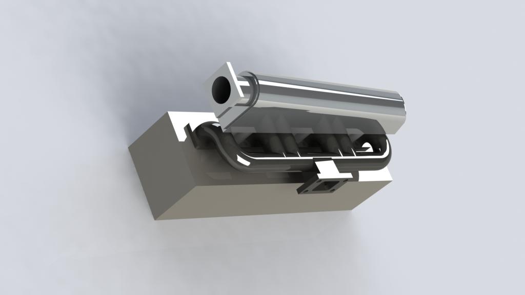

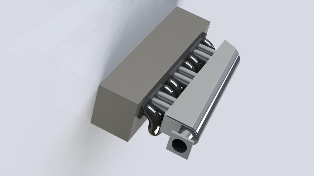

As the topic says I have a 80 series landcruiser that runs a 3f carby engine with points distributor which is very similar to the old 202s with points. I want to convert it to efi for reliability and more power(turbo once its converted). I have just got a 808 ecu which i will be sending off to VL400 for the usb and nvram mods to be done. I have already started drawing my new intake manifold and exhaust manifold which ill fabricate at work.

Intake Manifold - Ill let costs know when i make it. Exhaust Manifold - will use standard manifold while N/A. Exhaust manifold shown on above picture.

ejukated
- Posts: 426
- Joined: Wed Mar 04, 2009 10:52 am
Re: 3F Carby Landcruiser Delco 808
was that drawn in solid works?
SyNt4x
- Posts: 39
- Joined: Sun Sep 13, 2009 3:25 pm
- cars: 1990 80 Series Landcruiser
2012 Kia Sorento
2006 Holden Rodeo
Yep.
Just waiting on my intake / exhaust manifold gasket
To show up from covs to align flange and ports. It was
Supposed to be there today.
I'll draw injector bungs on the manifold once that's sorted
To double check the fuel rail length required then start
Making it.
Making it.
