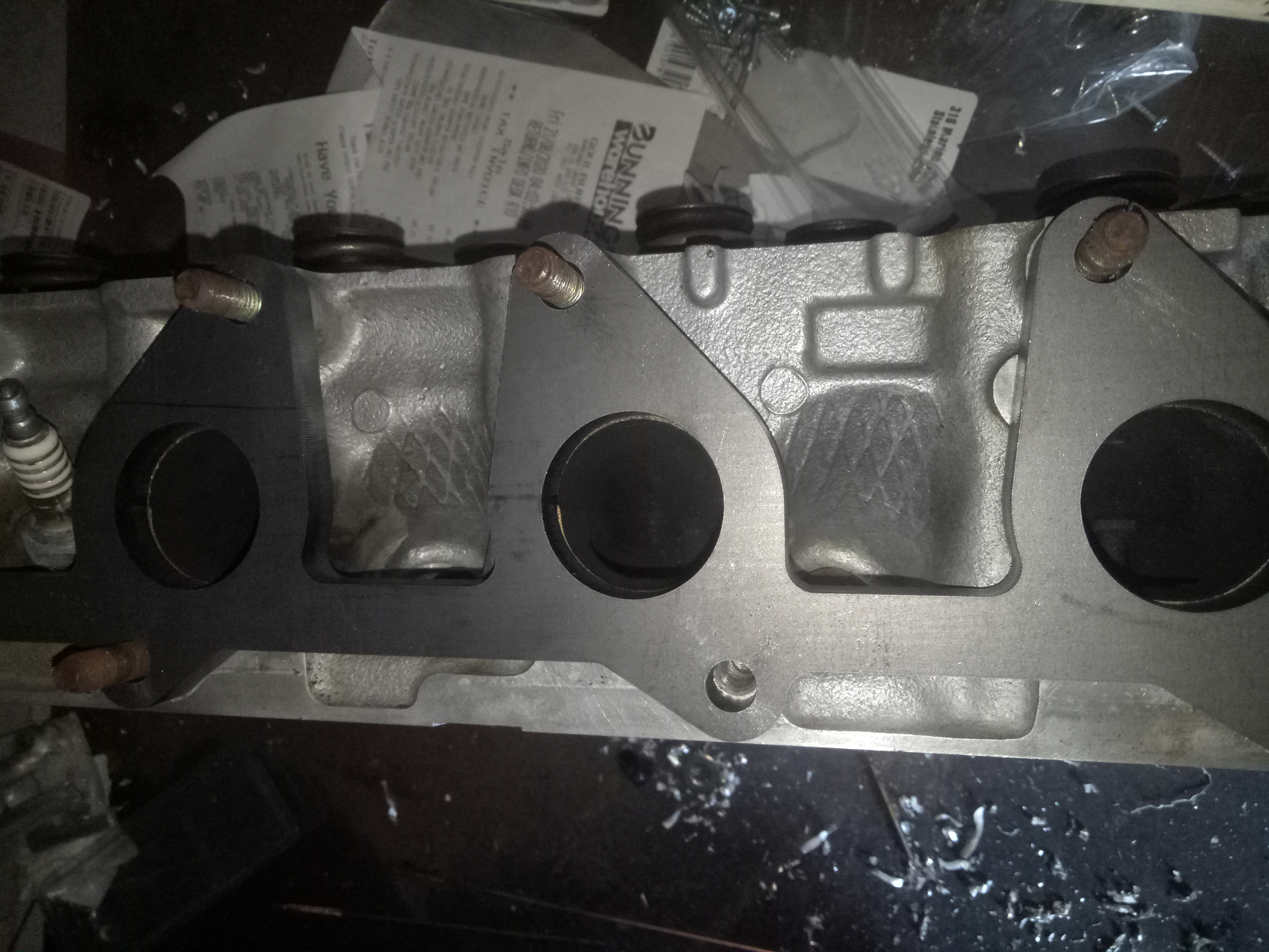

Laser cut exhaust flanges are inbound! All parts were cut within the quoted lead time (5 days), update emails throughout the process, replies within 10min. I can't believe how much of a dick that other guy was...

Re: N13 Turbo - Round 2... Fight!
Who did the layout on them flanges ??
(ie drew them up in cad)
- Posts: 533
- Location: Windellama, NSW
A guy on the Pulsar groups of FB did them up for a tuned exhaust he was working on. They came out perfect!

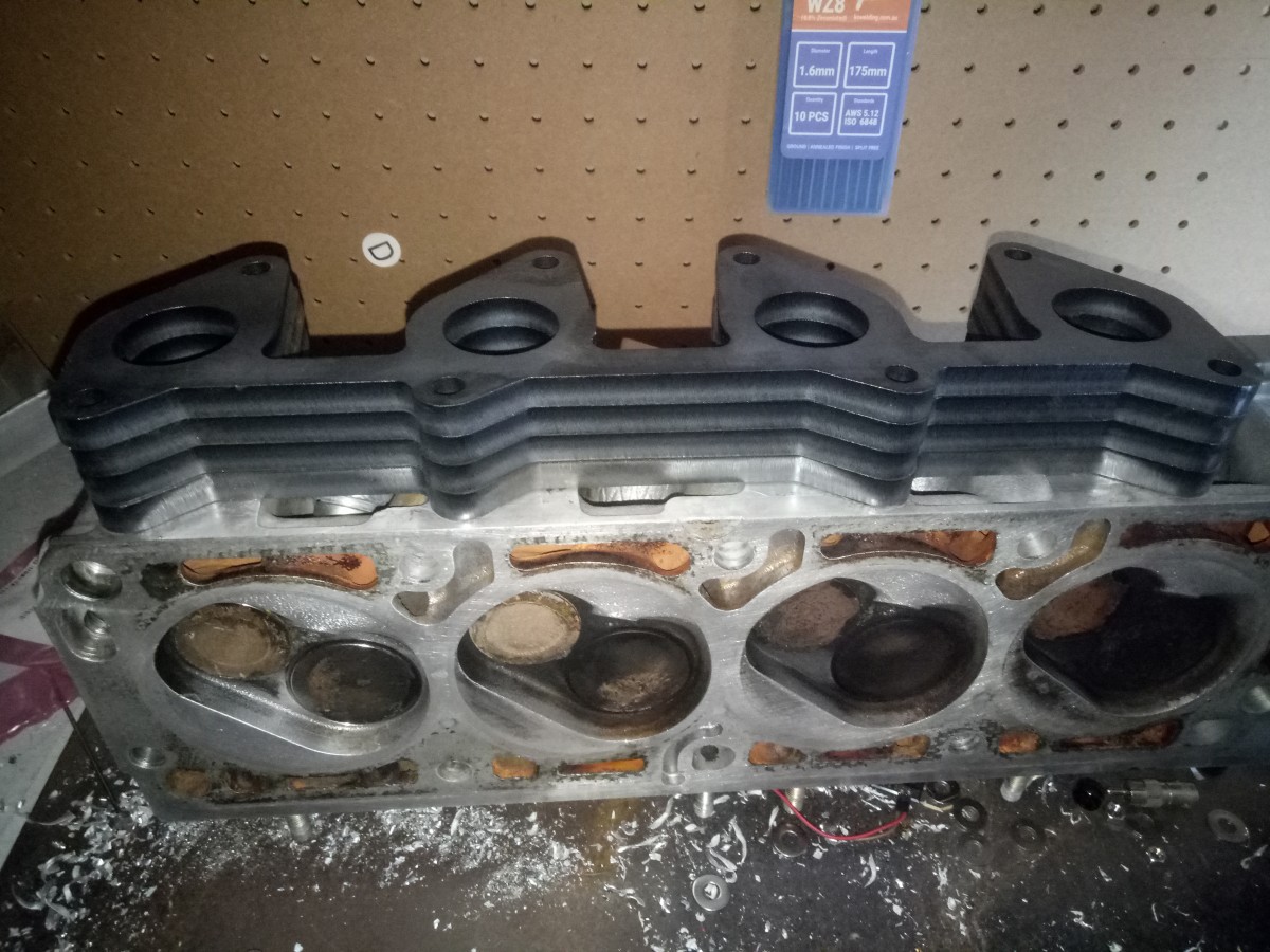

The steampipe arrived so I'll get cracking on this manifold tomorrow, work permitting. I've got 1 1/2" pipe which is a lot larger than my last log manifold and should flow a heap better into the larger turbo.

Very nice lazer cut flange. Looks like mass production occurring.
Yes they do fit very nicely for what you are doing with iron pipe, they would not be so good for tubes.
The image angle is bad, how close is the plug, get a socket on it ok ??
Looks kinds close, could just be the angle though.
