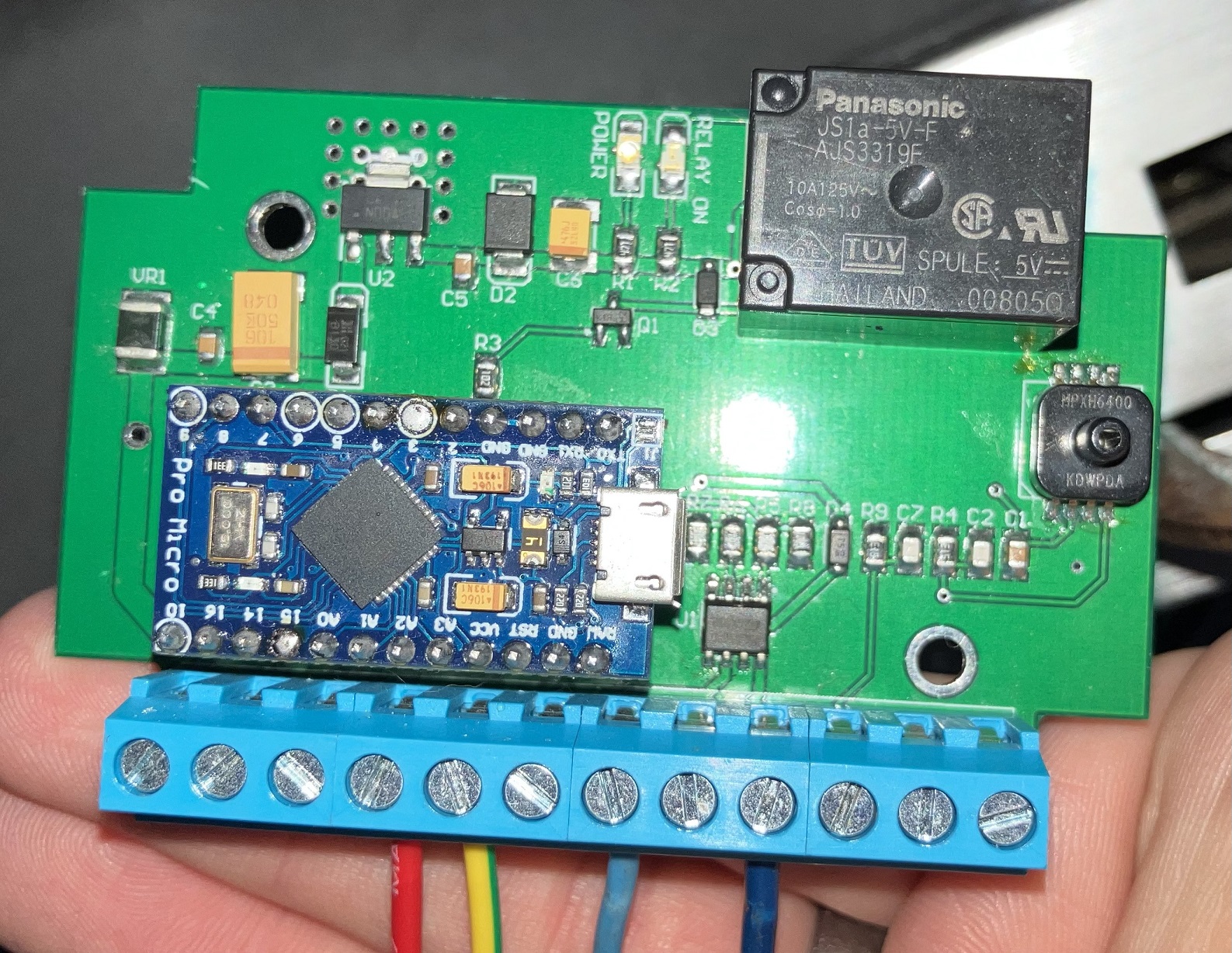

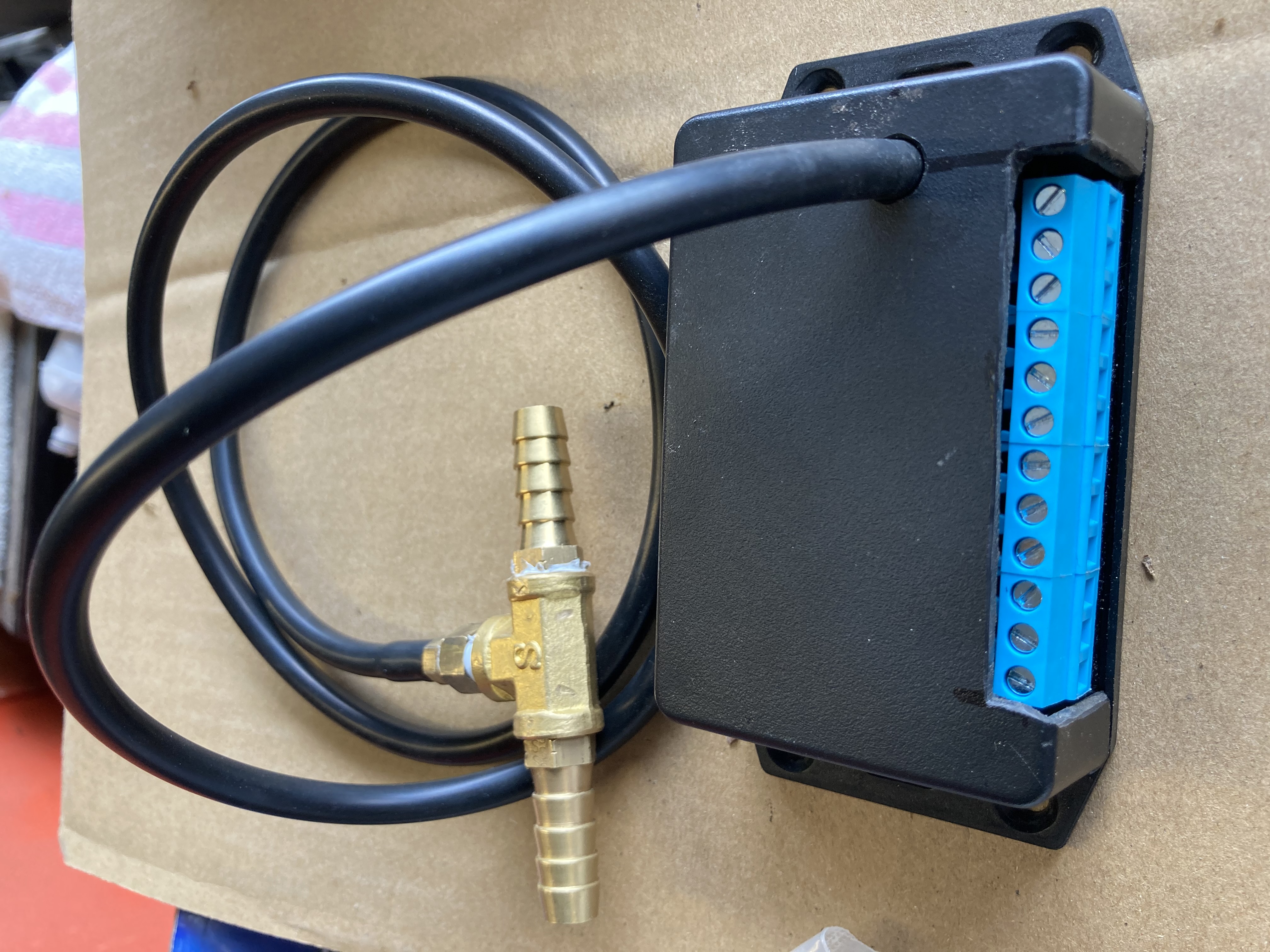

ok so now the long story!
probably like everyone, i've always wanted to do proper boost control with the delco, but sadly it just doesnt have the coding to do so.
So totally un-related to this, when building the FX i got myself a vacuum pump from a Holden, and plumbed that into my brake booster, all worked well except the pump running constantly got hot pretty quickly, so i decided to make a small circuit with an arduino, map sensor and relay control to basically read the map value on the brake booster, and once it dropped to a certain level it would turn the relay on, and then once it got back to high vacuum turn it off.
before i actually made the board, i started thinking of what else it could do, it quickly became obvious, with the right additions it could easily be a boost controller, so i added an on board map sensor, an external MAT & MAP input and a dual channel high current driver which can run an injector / boost solenoid etc. (all circuits courtesy of speeduino schematics)
It worked really well for the brake booster control, and then i got to thinking if you could read the delco flex table output into an arduino then you could do what you need for boost control.

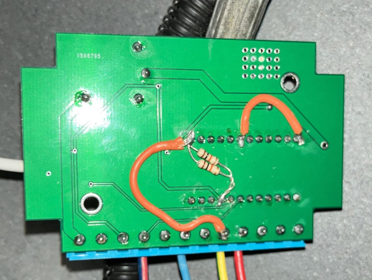

it required a few hardware mods to make it work, but otherwise all good.
with a bit of help from Jayme we got a working input into the arduino, and i tapped into my 3 bar map sensor that the delco uses, and then i was pretty much set for coding it up. I found a PID controller arduino library, and that was pretty much all i needed to make it all work.
So i changed the calculation in the flex table to display 0-30 (PSI) instead of the 0-100% duty cycle it shows, and then basically put in your desired boost, which then sends that value to the arduino.

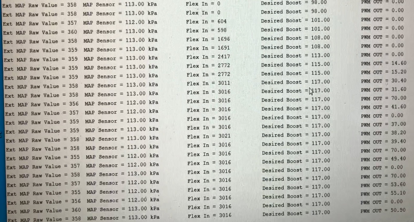

as per below here you can see the raw map sensor value, calculated map value, flex input raw value, then converted to a desired boost value, and the the PWM out is the value sent to the high current output to control the mac valve.
at this stage that is basically all i have done with it, as i do not have a registered car with delco and turbo to test it with. I am expecting the PID values will need some adjustment but the theory is at least proved.
im happy to work with anyone who is in a position to test this

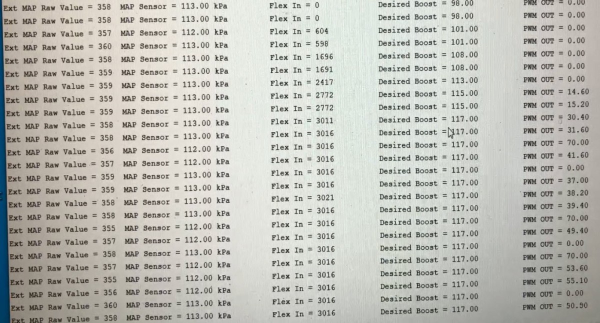

Very nice work! I'm wondering if you could simplify it further by instead just connecting to the serial comms from the delco and retrieving RPM/MAP/Desired Boost as it's all available over the stream. Would save a map sensor and any difference in the ADC between the delco and the arduino. Also conversion back from duty to requested boost would be more accurate.

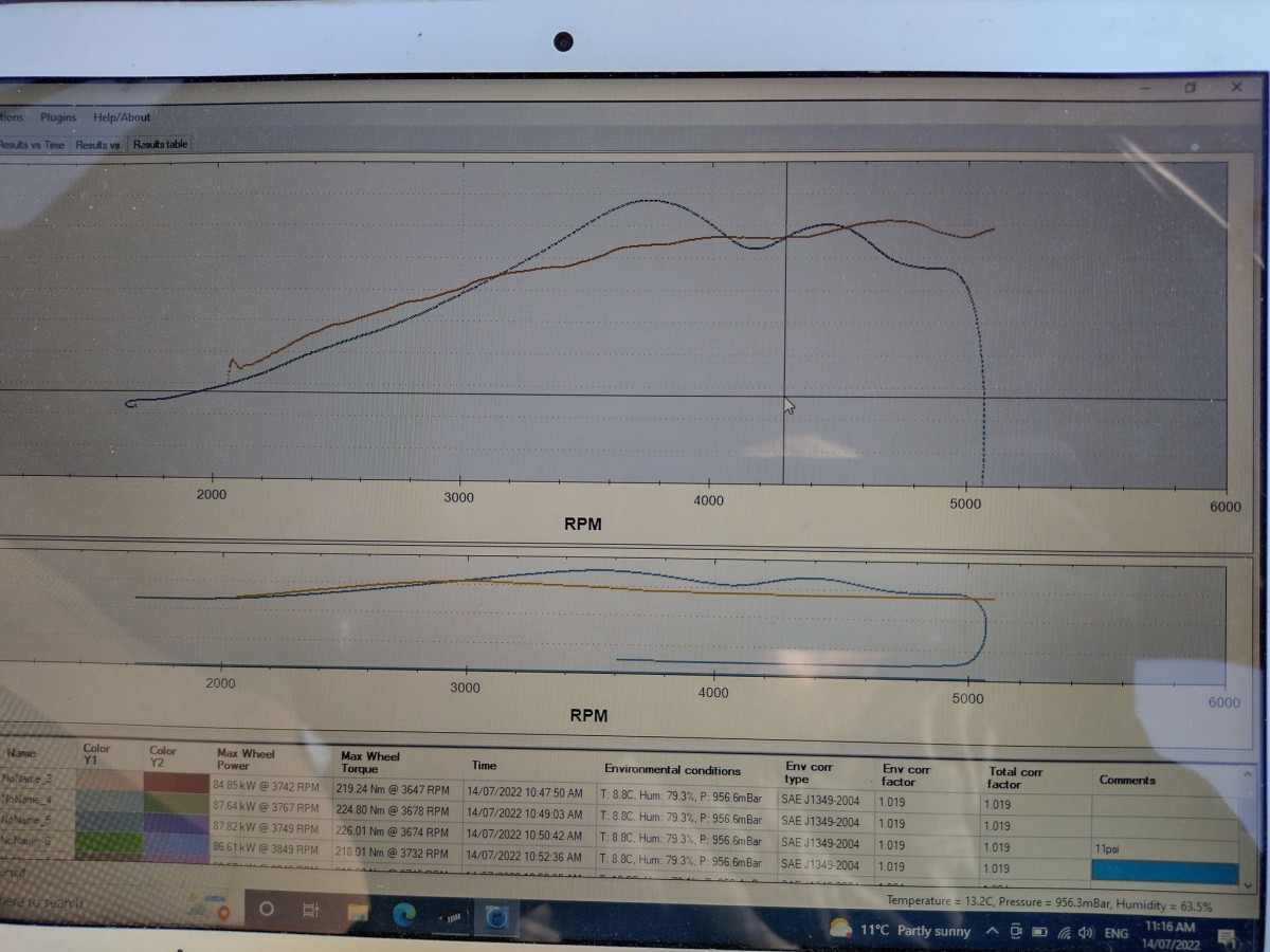

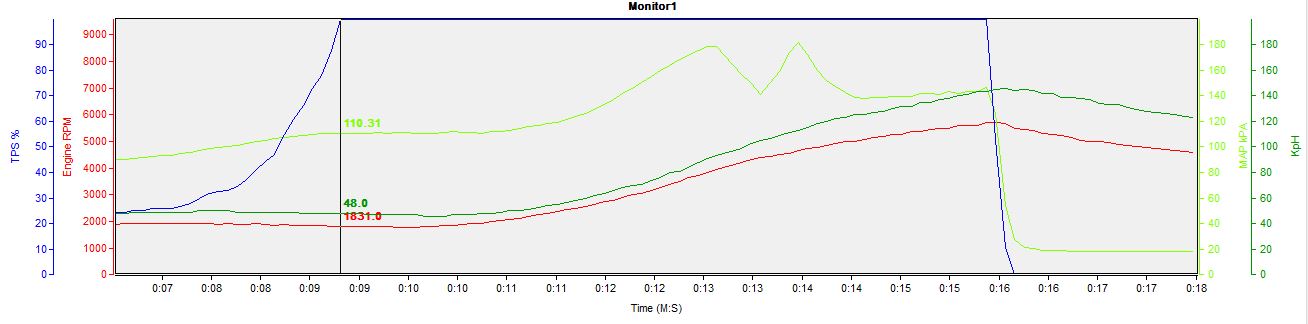

What I thought previously might be a bad coil or bad valve springs, turns out to be boost related (The dyno software was filtering its MAP input so much this spike/dip wasn't present...)
All boost hoses are super tight though I haven't done a boost leak test on them.
All manifold barbs are plugged except for the brake booster feed and map sensor.
Exhaust gasket is new and the manifold was ground flat on a belt sander.
Wastegate actuator was swapped from the OEM saab type to an aftermarket kinugawa actuator. This boost dip isn't present at 6psi, only when increased to 9psi or higher (stock actuator or oem). Switching boost between the two will show repeatable torque curves.
VE doesn't change when the dip occurs. AFR's don't change when the dip occurs.
I'm not sure if its a lack of exhaust flow from the engine which is lowering the boost, or if its actuator/turbo related. Could it be the head lifting between cylinders reducing combustion and exhaust energy? There is no coolant in the oil, oil in the coolant or any combustion gasses making their way into the coolant tank.
This has got me stumped... retarding the timing up to 10 degrees at the higher boost lowers torque significantly though the boost profile remains the same (moves maybe 100-200 rpm higher or lower).
It's hard to hear any boost or exhaust leaks over the dyno at this wheel speed though the induction noise does change during the dip.
Increasing to 1 bar boost pressure makes around 94kw at 3400rpm before the boost dips like the 9psi profile.
The turbo poppet moves freely when cold, the actuator arm is in a straight line to the wastegate arm. I don't think its binding.
I thought it might be the car creeping up on the rollers and off the idle rollers but the same boost issues are seen on the road ruling out the dyno.
open to any suggestions! (regarding valve springs - any aftermarket springs of the same dimensions that i've found have less seat pressure when open or closed according to their datasheets than the stock ones, by quite a margin)
- Posts: 10311
Re: N13 Turbo - Round 2... Fight!
thats definitely a very odd one!
its not spinning the tyres at that point ? do you have a data log of the ecu to see if the speed spikes or something ?
