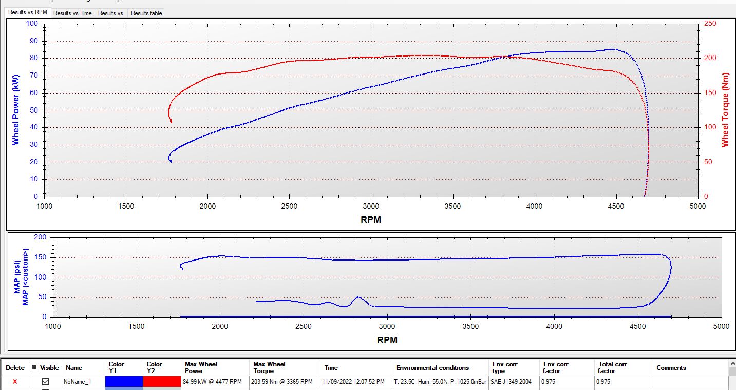

Small update on the boost fluctuation. Turns out it was a leaking manifold gasket which eventually blew out. Didn't leak at idle, only under boost and couldn't be heard over the dyno. After replacing the gasket, we get a graph which looks like this:
I would have thought a turbo designed for a 2.2L saab would have a bit more power in it on a 1.8L but its clear we're seeing boost creep past 4k and diminishing returns on boost past 7psi, plus full boost by 1900rpm. All these together I think indicates we're running out of exhaust turbine and back pressure is now the bottleneck. This is with the cat-back disconnected.
So, now begins the GT2871 (china spec) build!

It was tuned for peak torque across the boost map and 2 degrees pulled out of it just to be safe. Still a whole lot of fun to drive at 85kw, I just need more
2 cylinders are running a lot richer than the other two so I'll be off to the wreckers this weekend to find a genuine set of injectors. 440cc are overkill for this thing, 220cc were getting close to 90%. Wonder what has ~330cc's in them from factory.
