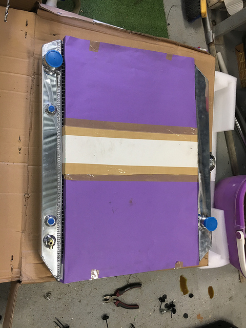

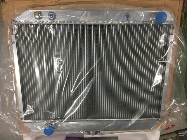

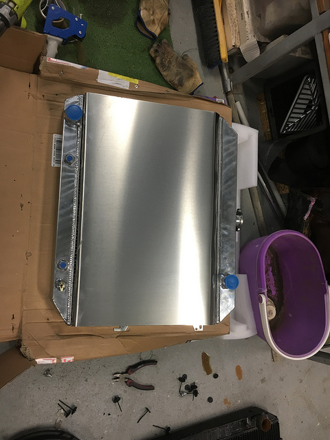

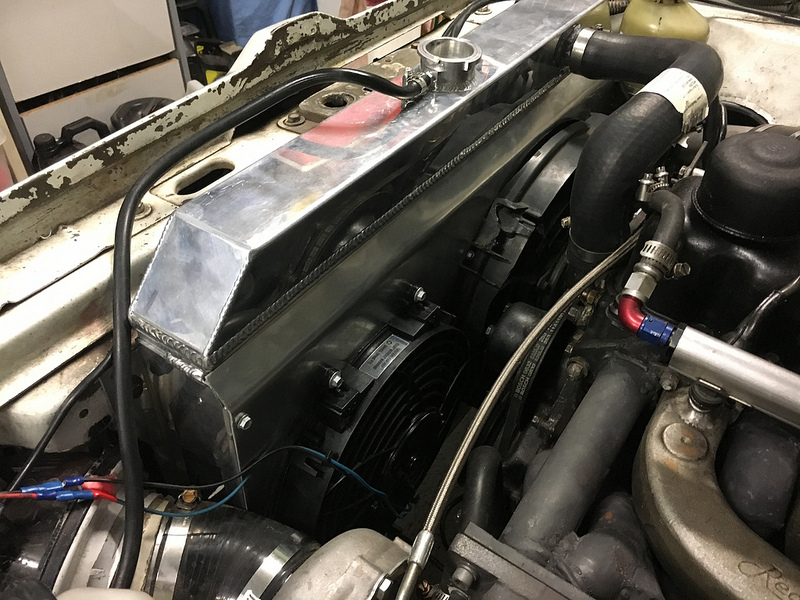

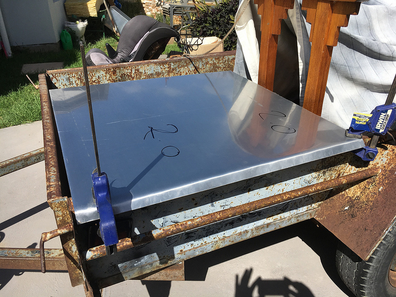

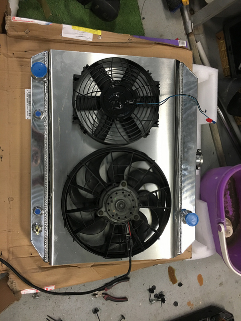

This big ass 3 core radiator from a Dodge big block has solved my overheating issue. Took it for a run up the hill today and at the same spot where it was hitting 100 degrees it only just hit 90 degress. On the flat it sat on around 82 degrees which is not even running the fans. At the lights it would creep up over 86 and the fans turn on and it drops back down again. The shroud has not even been sealed all that well yet, I just put it in to see how it would go and all good so far.

Re: 265 Hemi to efi
Cheers, the trailer came in hand. Who needs a bending brake, ha
Re: 265 Hemi to efi
nice one!
I regularly use my saw horses as a bender
Re: 265 Hemi to efi
Fortunately there a lots of things around a shed that can be used for bending steel if you use your imagination..Holden202T wrote:nice one!
