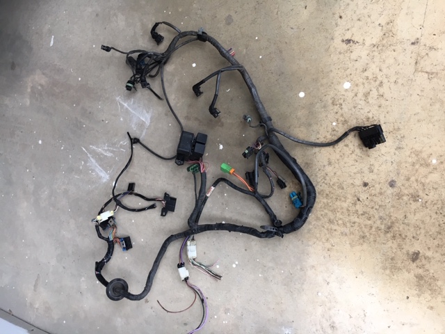

Visited upullit today to get a spare ECM for the Ute and found a very tidy JE Camira that was recently added. I was only equipped with side cutters, a flat blade and Phillips head screwdriver but managed to remove the loom in less than an hour. Hardest bit was a metal loom clip that bolts to the block. I had to wriggle that up a down vigorously for 10 minutes before that snapped and released the loom. I just snipped the head bolt earths. $60 bargain.

- Posts: 5639
Re: 265 Hemi to efi
Good score
Re: 265 Hemi to efi
Yeah couldn’t believe my luck. There aren’t many JE Camira’s around anymore. Even the VN to VP Commodores are getting thin on the ground. Tonnes of VS VT Commodores though.
Re: 265 Hemi to efi
yep get em while you still can!
