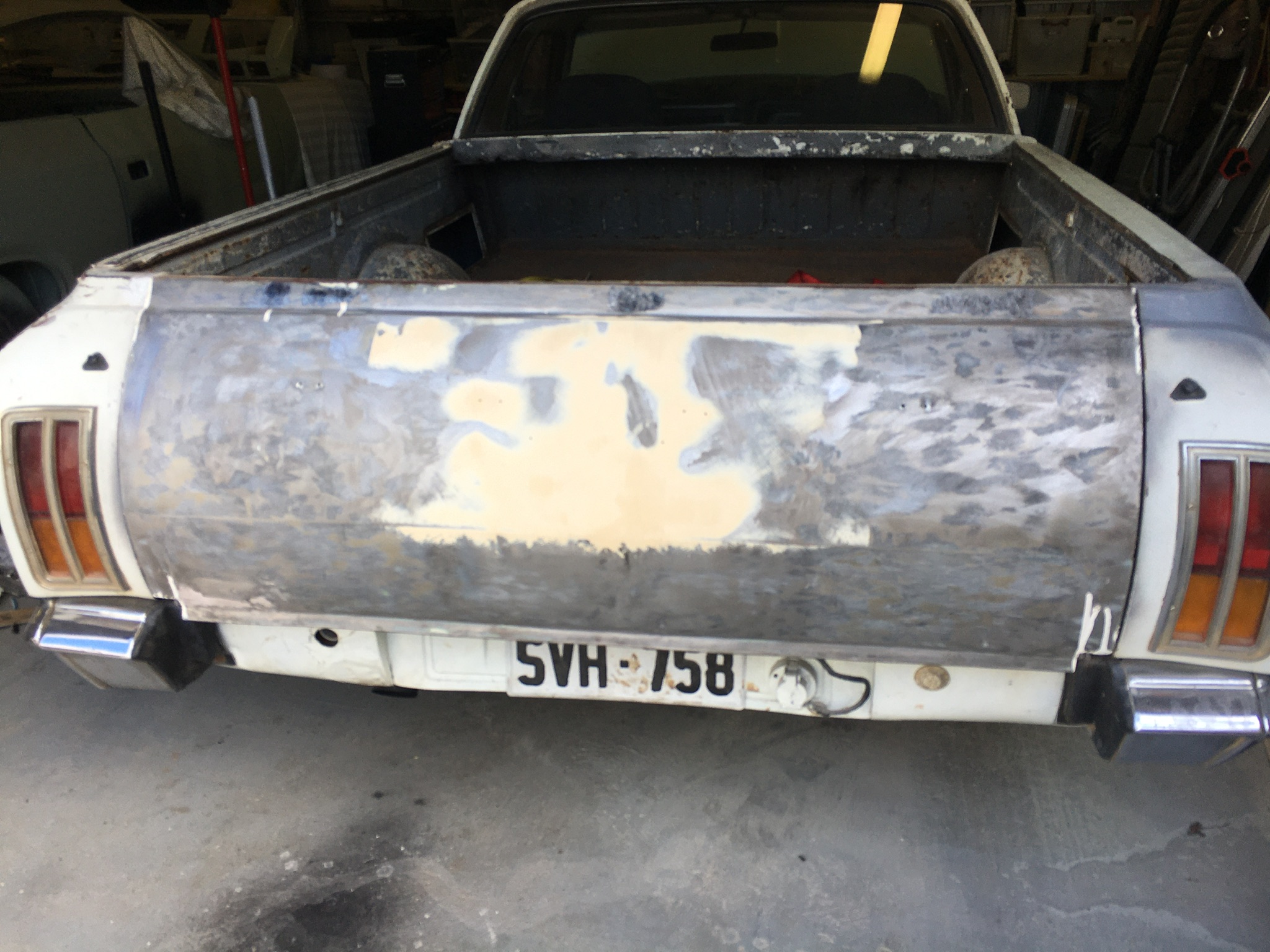

Postby heff0018 » Tue Dec 03, 2019 7:41 pm
Finally got the skin back on the tailgate frame. Hopefully I will be able to get a full skim coat of filler on this weekend
