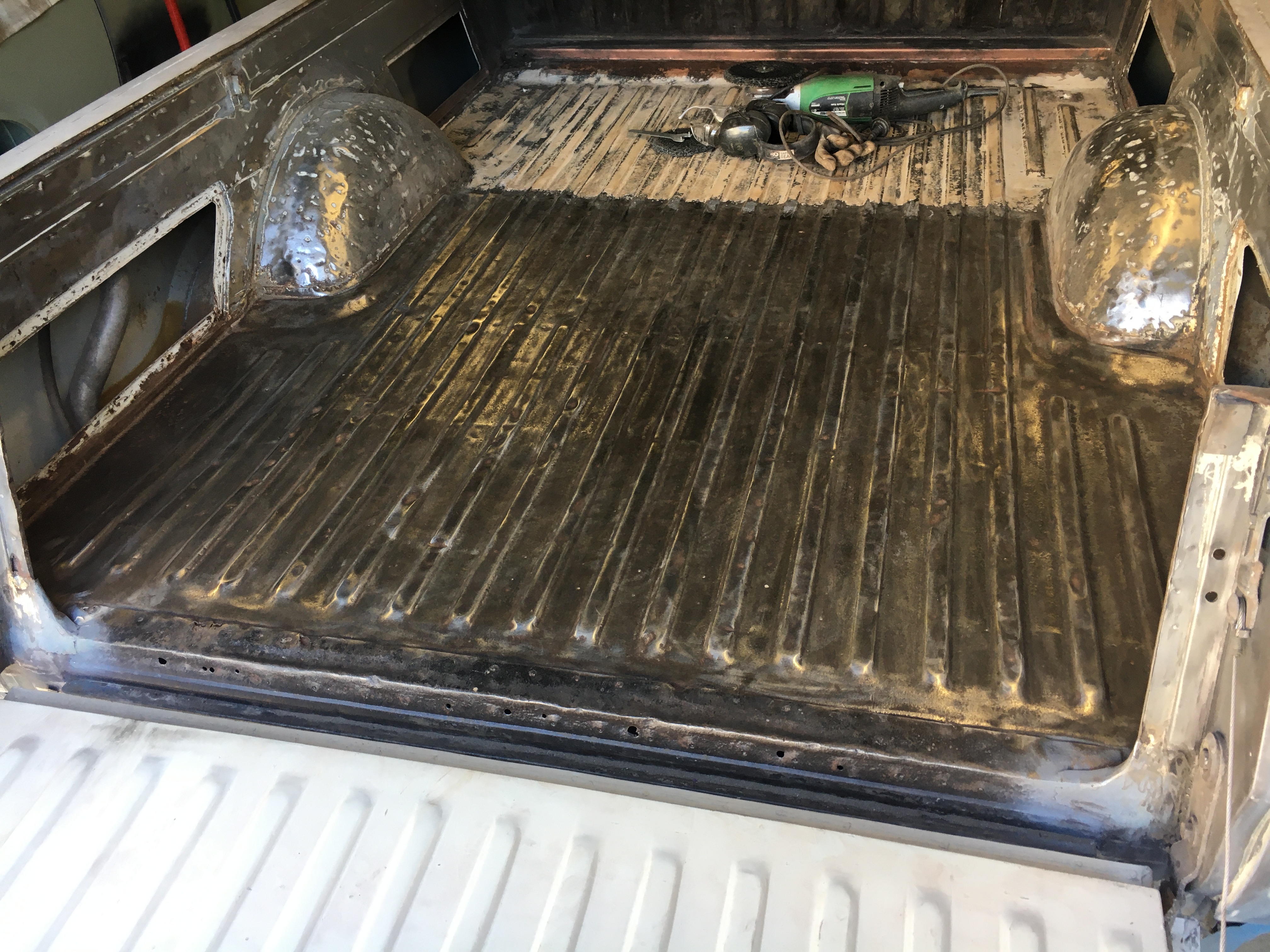

I finally got the tray cut welded back in. Basically it involved plug welding the old spot welds which had been drilled out. And yes it was a freaking mission but looks much better than the checker plate that had been arc welded over the original rusted out panel. Lots of seam sealer and epoxy primer now required

Re: 265 Hemi to efi
Looking nice!
Re: 265 Hemi to efi
man you are certainly dedicated :)

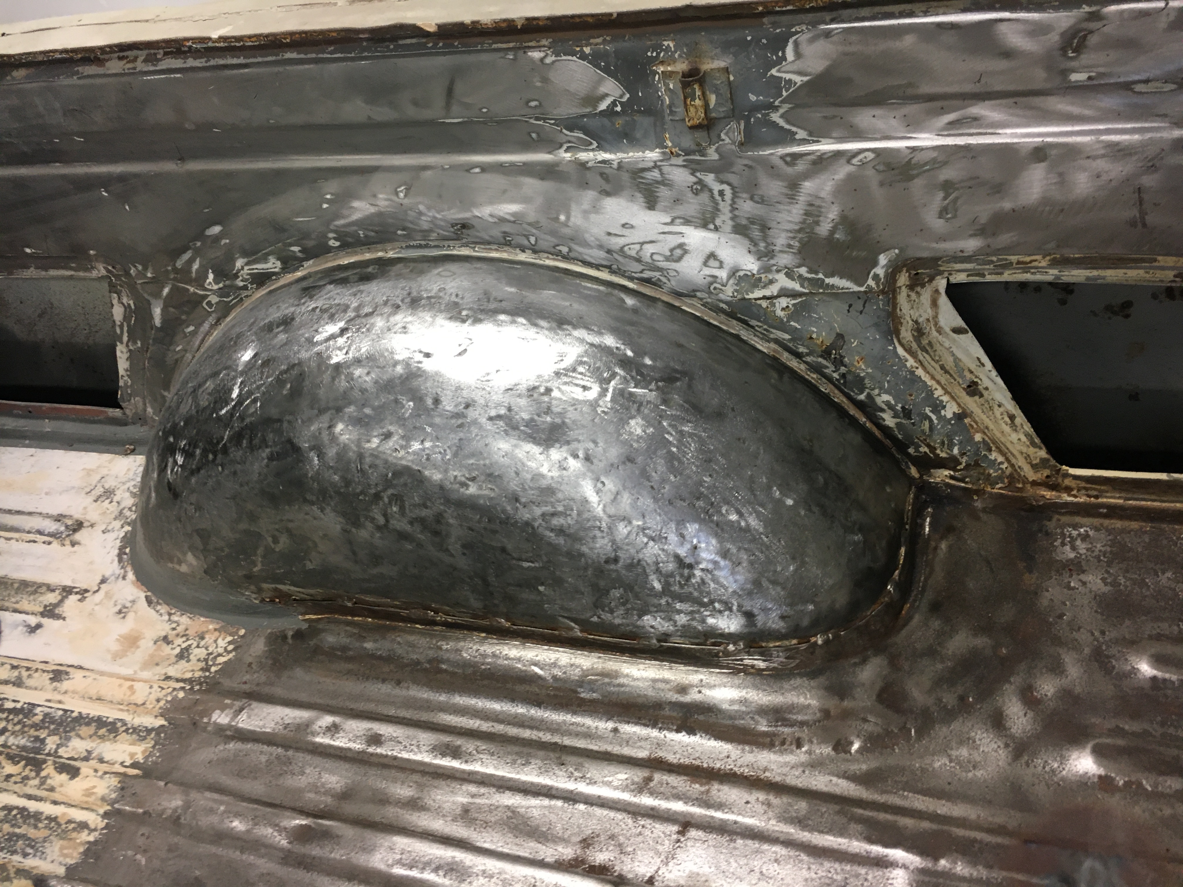

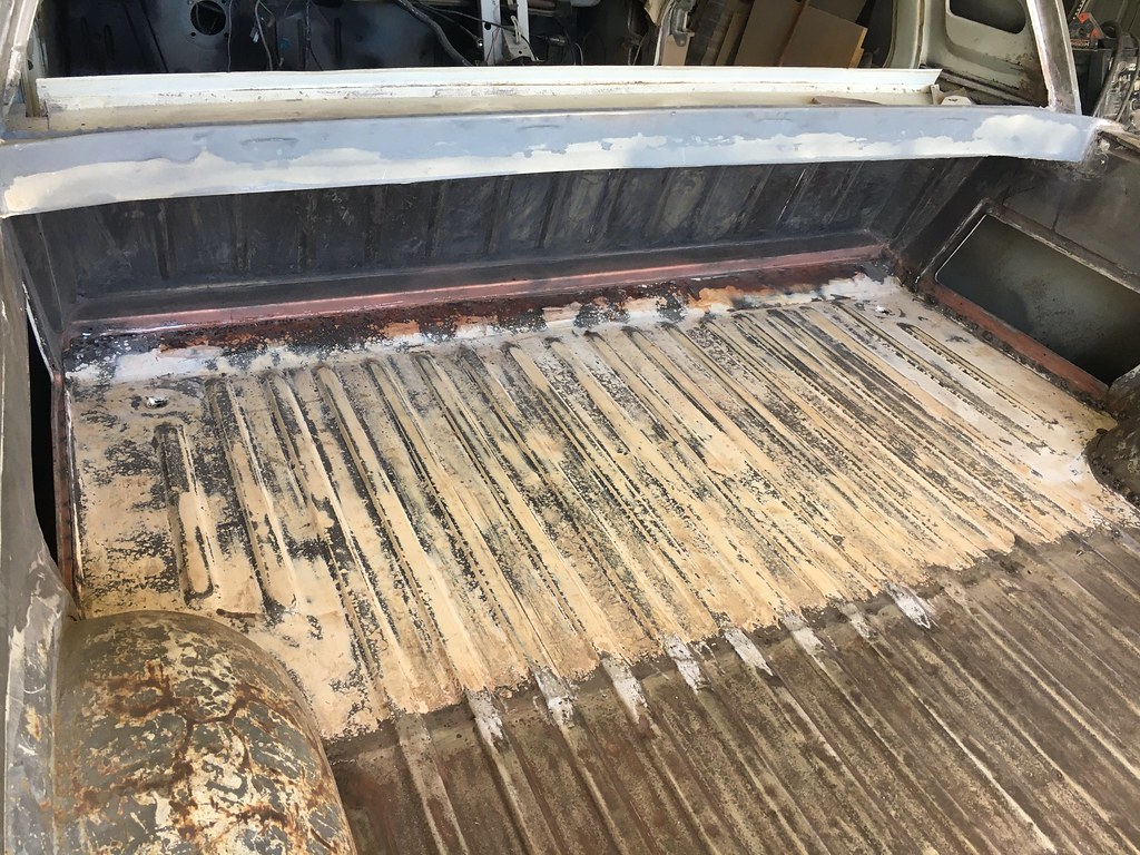

Cheers guys, a bit more dirty work yesterday. Ready for rust converter
Re: 265 Hemi to efi
im surprised there isnt more rust in that lower tailgate seal area!

There was a fair bit that I replaced but yes it could have been worse.

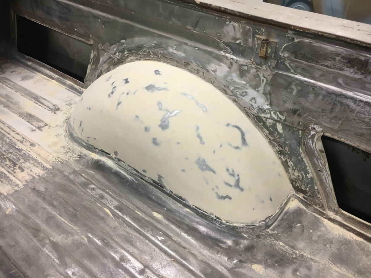

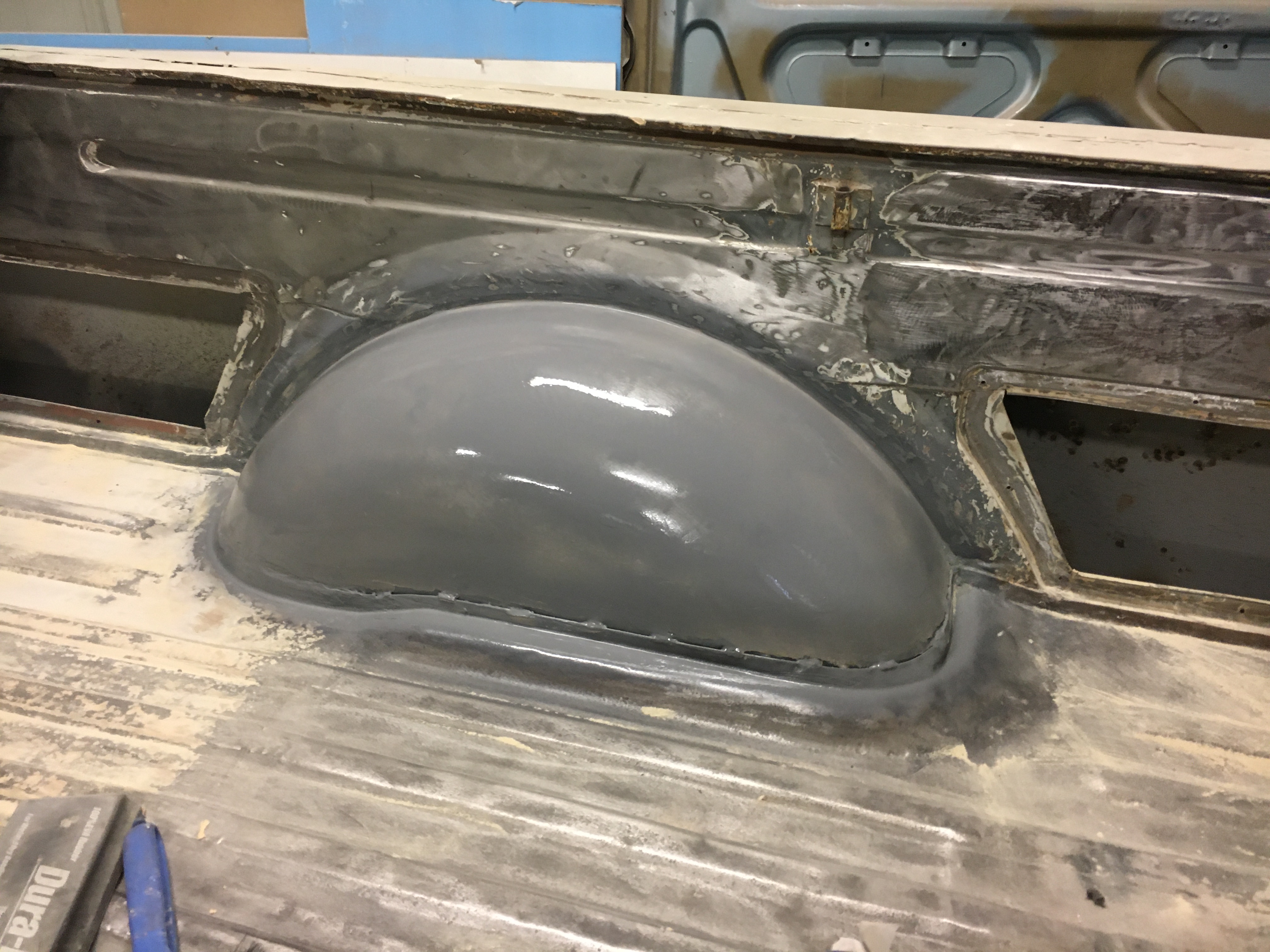

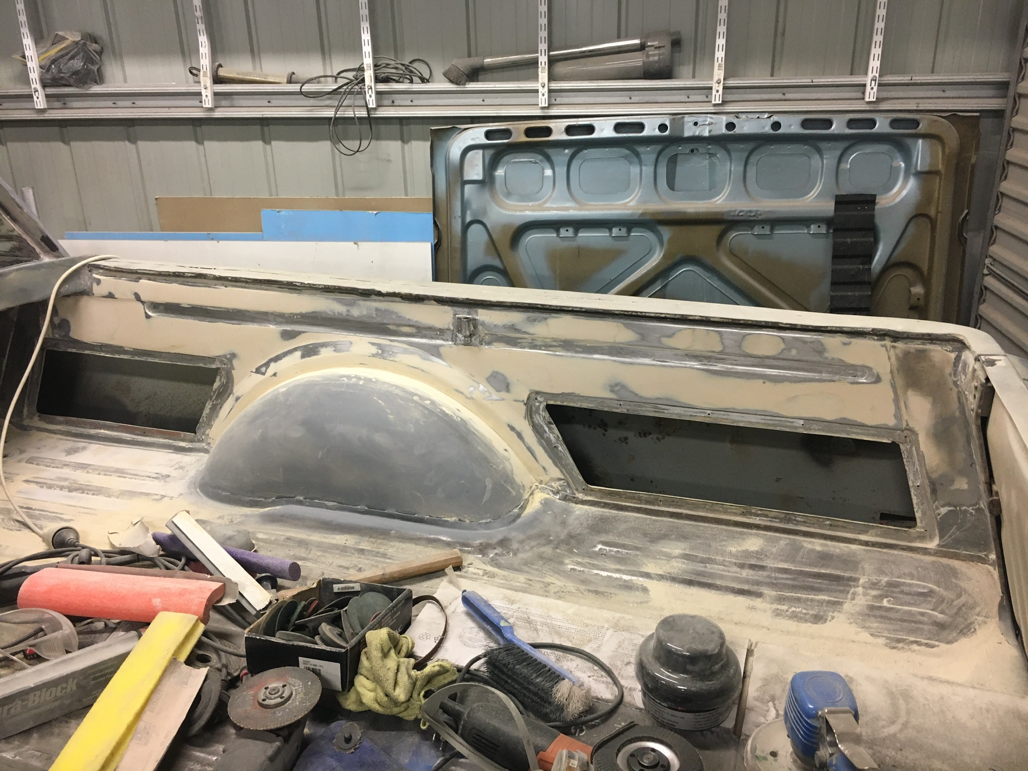

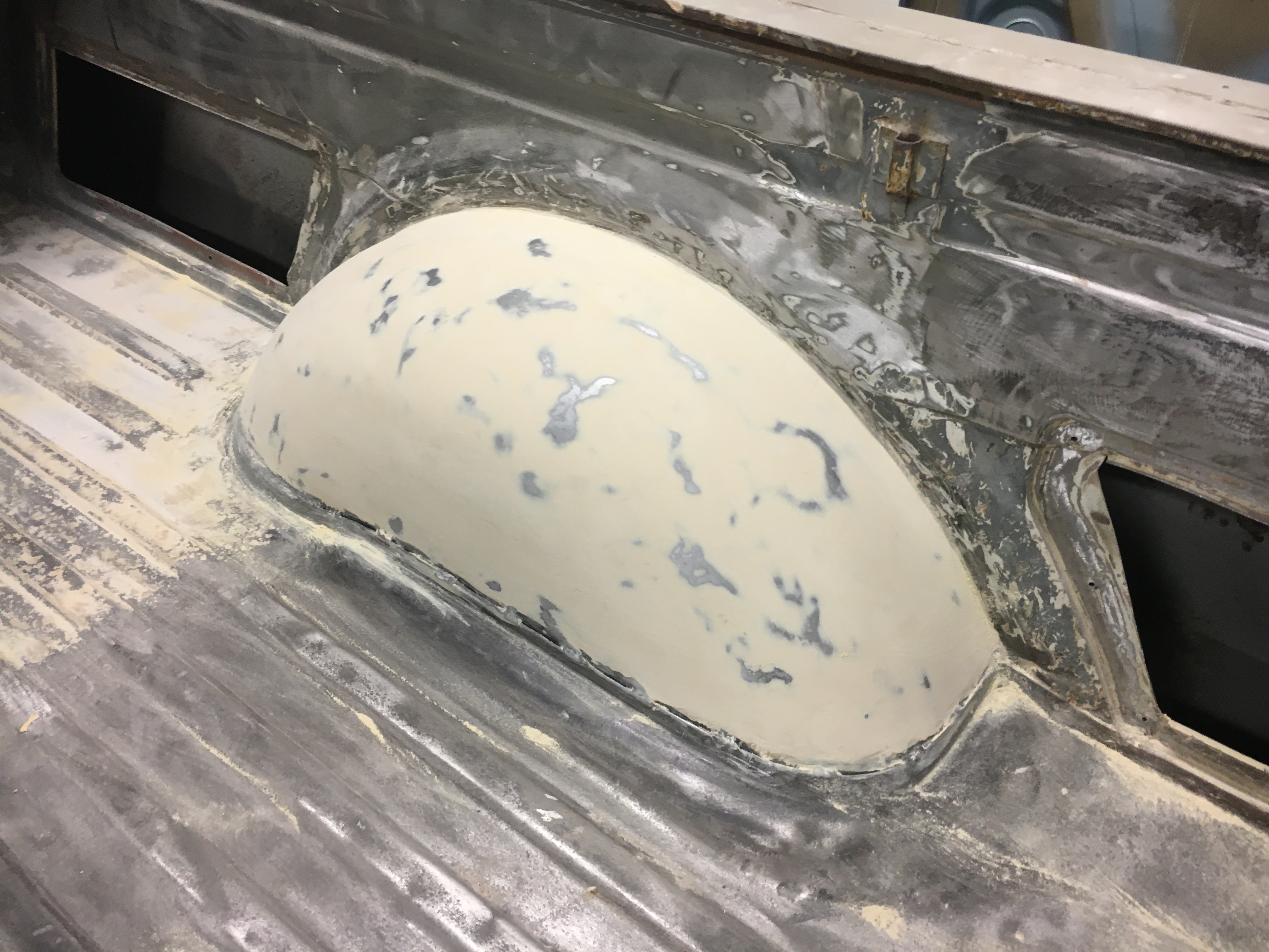

Hi all, haven’t posted anything for a while. Nothing on the Delco front but continuing with panel work so I can get this back on the road and track.The wheel tubs were trashed from years of farm abuse and there is around 3 hours hammer, dolly and shrinking in that tub to get it to point where it just required a skim coat of filler. Cheers

Hey, back at it, looks good!
The amount of work is unreal ... keep pecking away at it, one bite at a time, you'll be proud in the end!

Cheers Gampy, unreal is the word alright. Yes you are correct you need to look at one section at a time. If you look at the whole thing it can become overwhelming.
