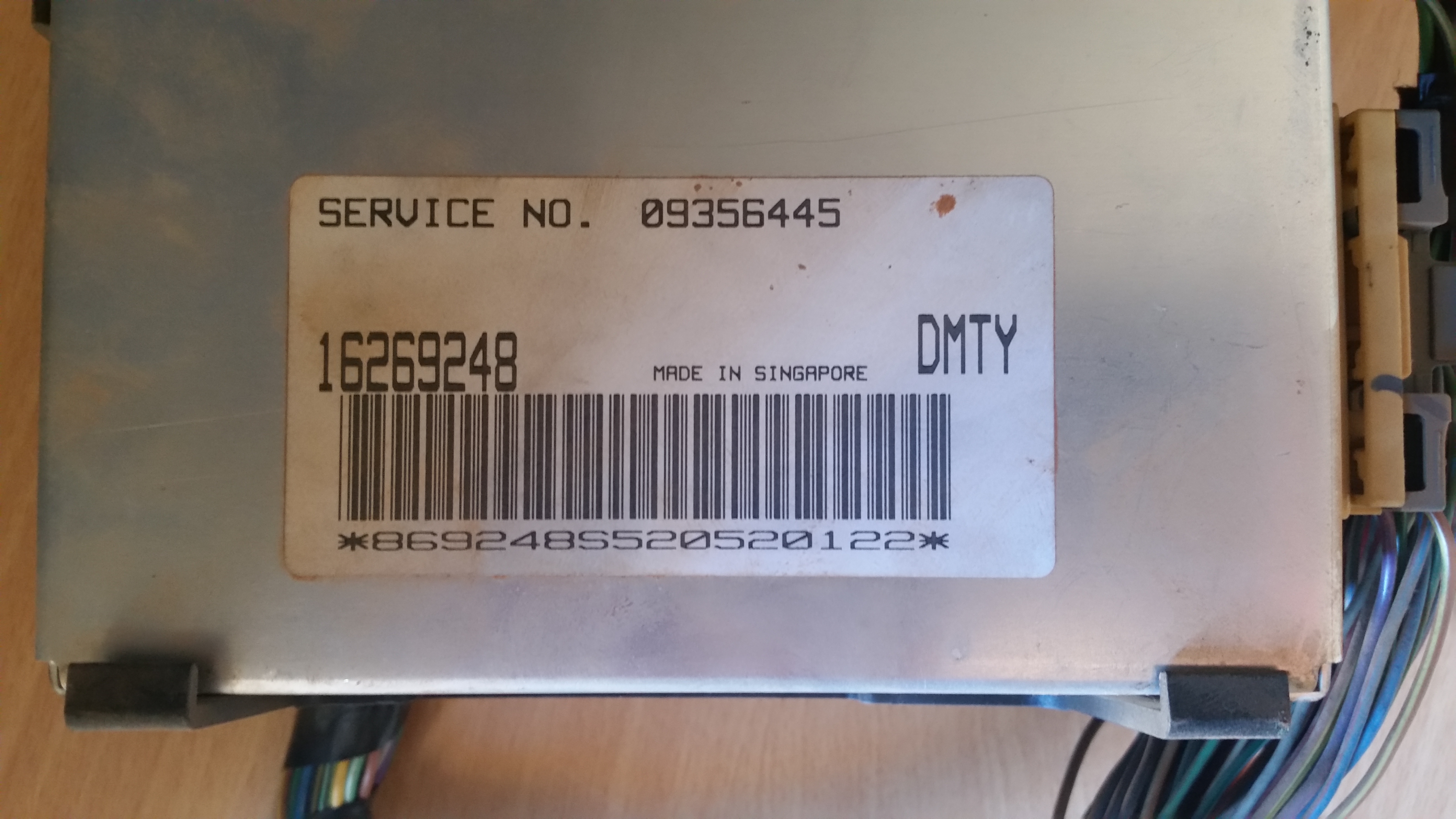

Have acquired a Delco from a VXII commodore - V6 auto sedan - have also scabbed the plug and about 50cm of wiring harness and the ALDL plug from under the dash.
Service number 09356445.
Also has 16269248 above the barcode and *869248S520520122* below the barcode
VXSII V6 Auto
VXSII V6 Auto

With regards to the ECU, (and from what I have read, people suggest that the ECU from a VN/VP/JE Cameria is the way to go (ole 808).
I'm yet to get my hands on the infamous 808, (the VX unit was free), and the seem to range from $150 to a crazy $500 online. They all seem to come without any plugs/harness for them, which is not much good for me.
I have read about bin stacking, and that sounds like a cool idea, although not sure if its really necessary for my needs. The VX unit should have enough space available to do this I believe.
Is it worth my time to hunt down an 808, or will the VX unit be just as good?
If anyone has any suggestions, or advise on extra bits ill need to chase down, that would be great.

There's an 808 from a N13 Astra on eBay for $20 buy it now with free pickup and collect from Woolies. I might need a brushup but I am sure it should have the right memcal for a 4 cyl multipoint. You can use a knock board from a V6 but it's not a perfect match with the correct 4 cyl one for your bore size impossible to get. Run 12P as it's already setup for boost. Your combo should go like a scalded cat. Very light car.

Download the Memcal ID program. It's very well done and has lots of good info on ECU's etc. That ECU is from an auto and I don't think the plug is the same as the 808.
