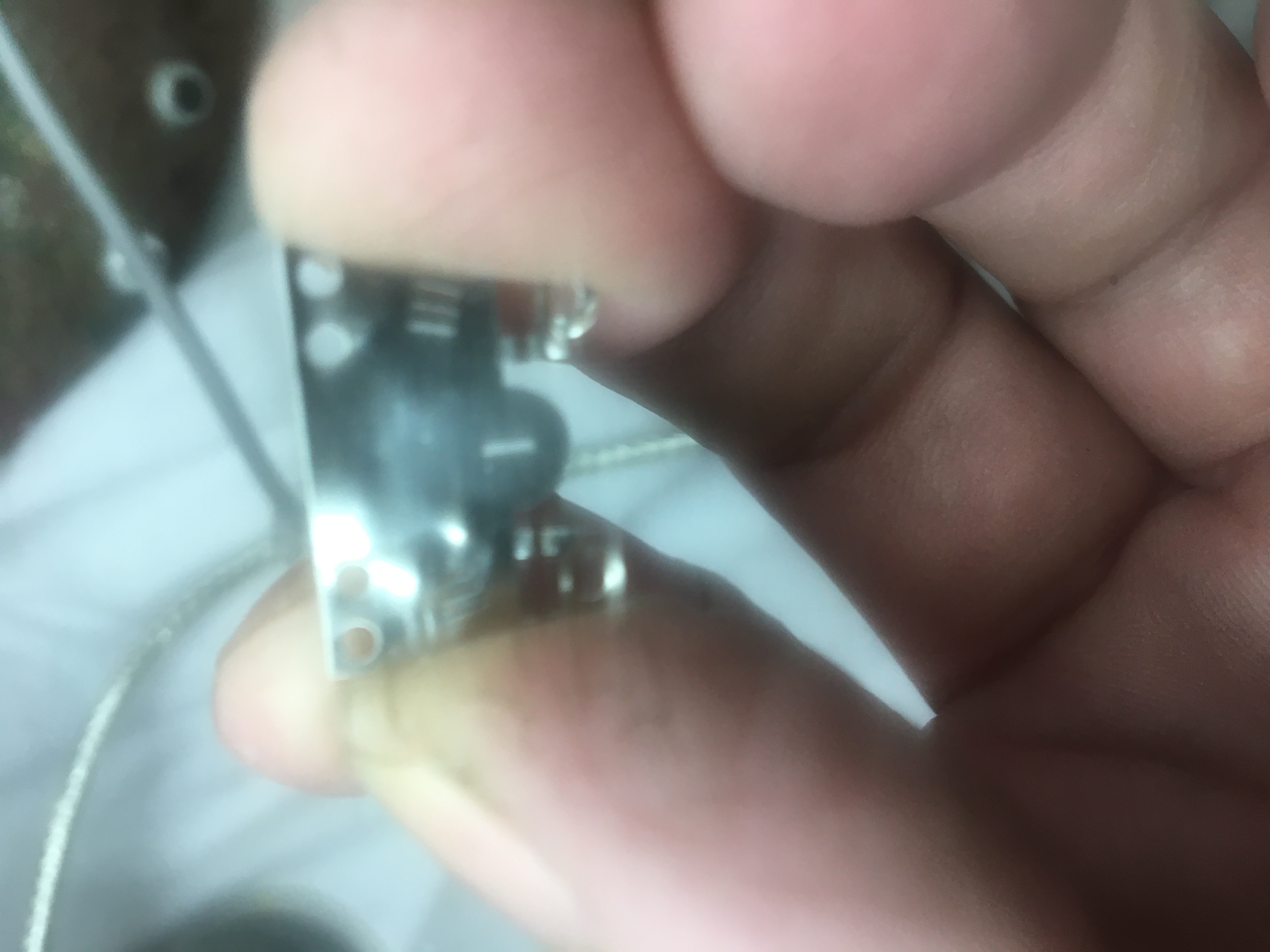

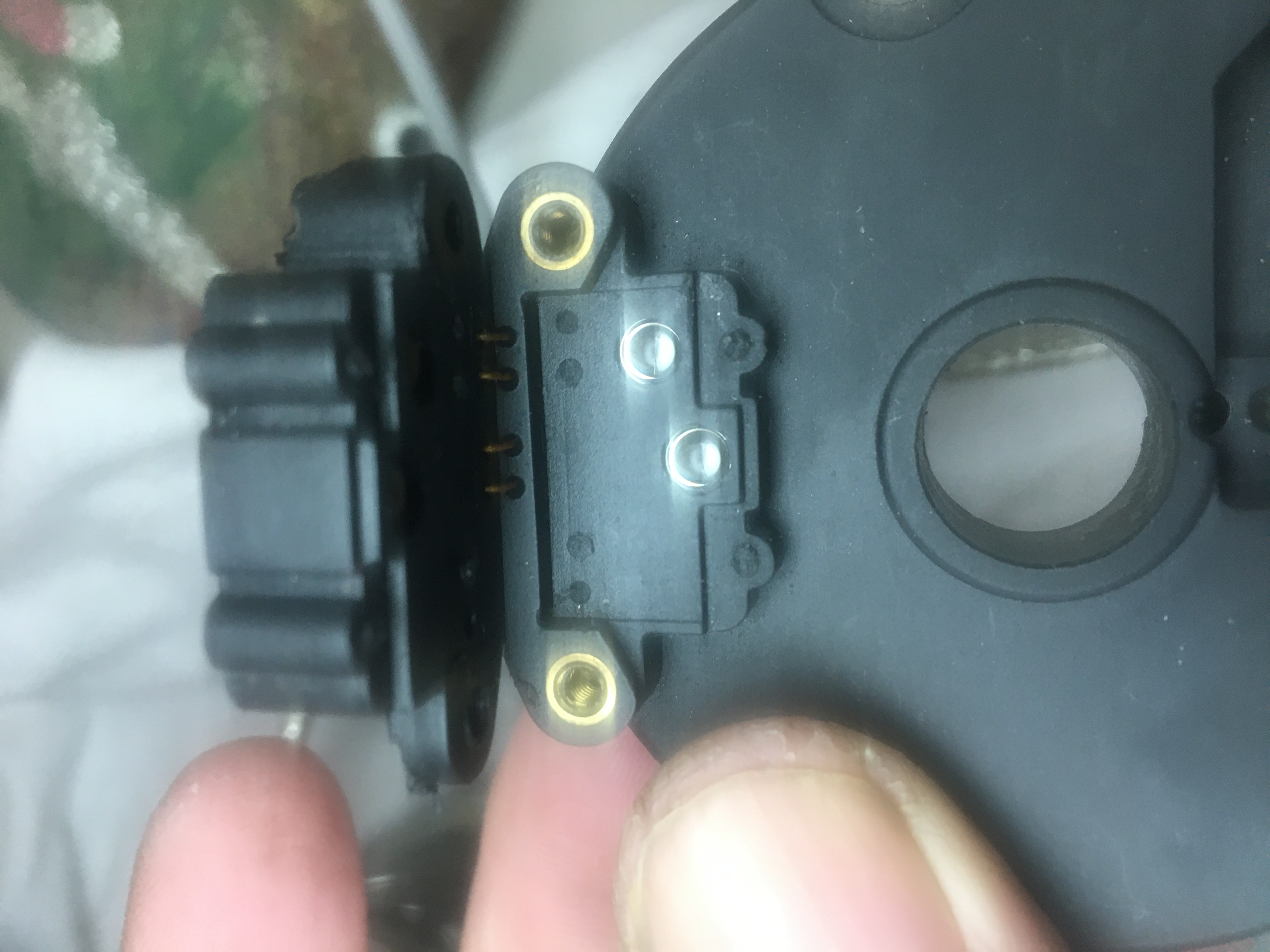

OK so going back to the dizzy after opening up the photo interrupter housing you can see how the beams are setup .There is a alloy cover plate( hard to get good pic) that goes over the photo transistor the center is a single slot smack in the middle (inner ring) the outer has 3 slightly smaller slots about 10deg from center.
Not sure if outer ring with the three slots is going to work as good as the single slot for the inner ring .The delco ign module is looking for number of transitions of (18x) when the 3X goes low. I think I'll have to test and see. Still waiting for new CAS plug so I can get it wired up on the bench.
Preferably I would have liked 2 single slots for both....and this housing is not made to come apart easy .

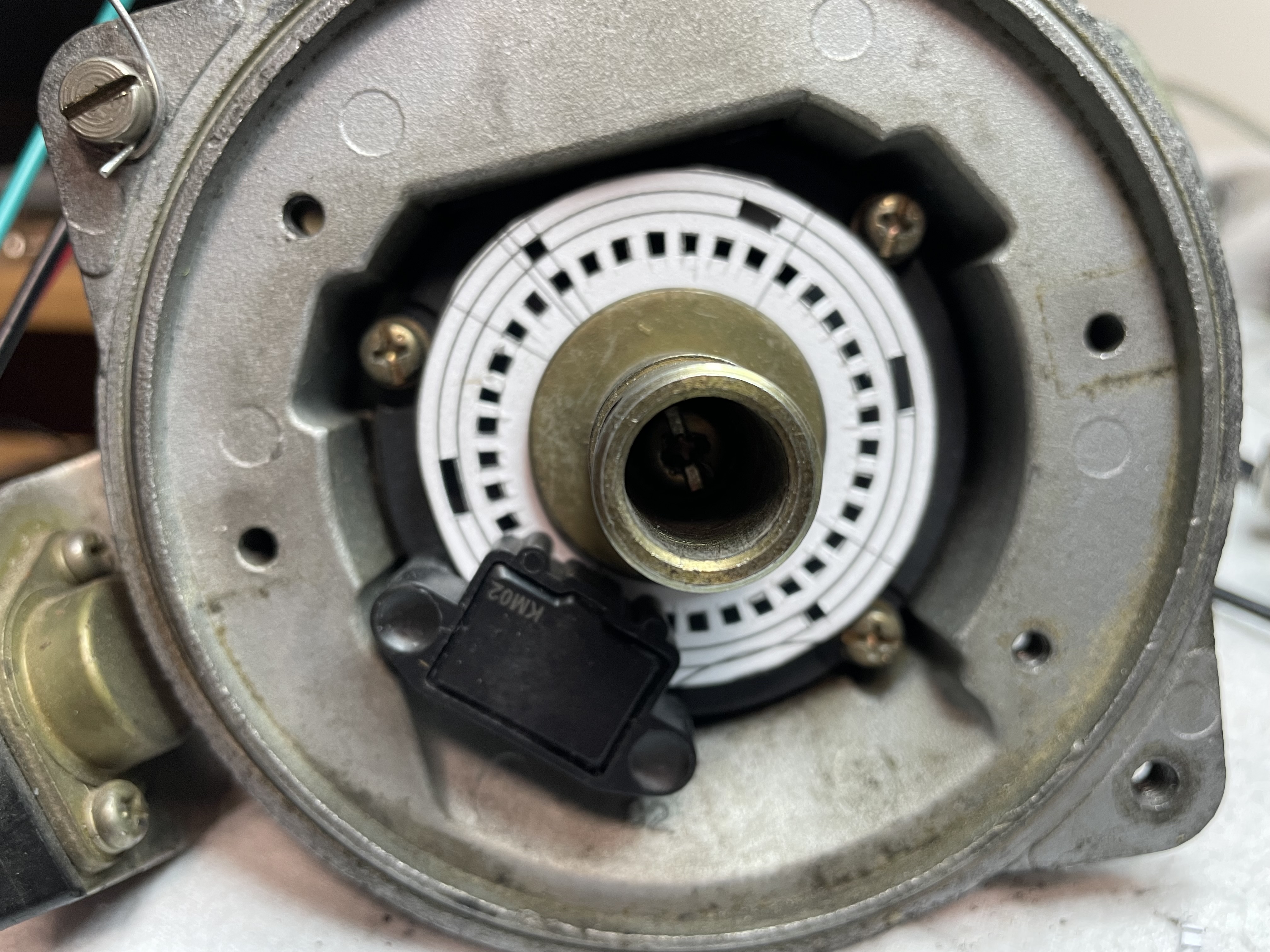

Ok So I have redone my chopper disc so the 18x is on the inner track (single slot for beam) and the 3x sync on the outer track (3 slots for beam) . The 18x is the more important as the 3x doesn’t get used after sync. Well that’s the what I’m thinking.

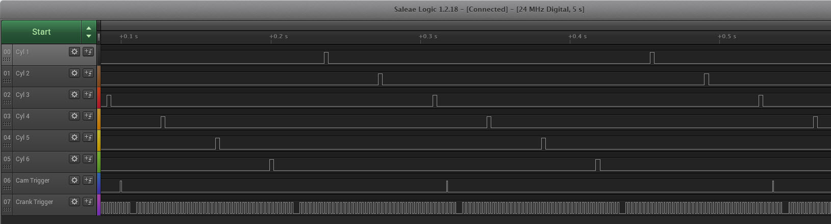

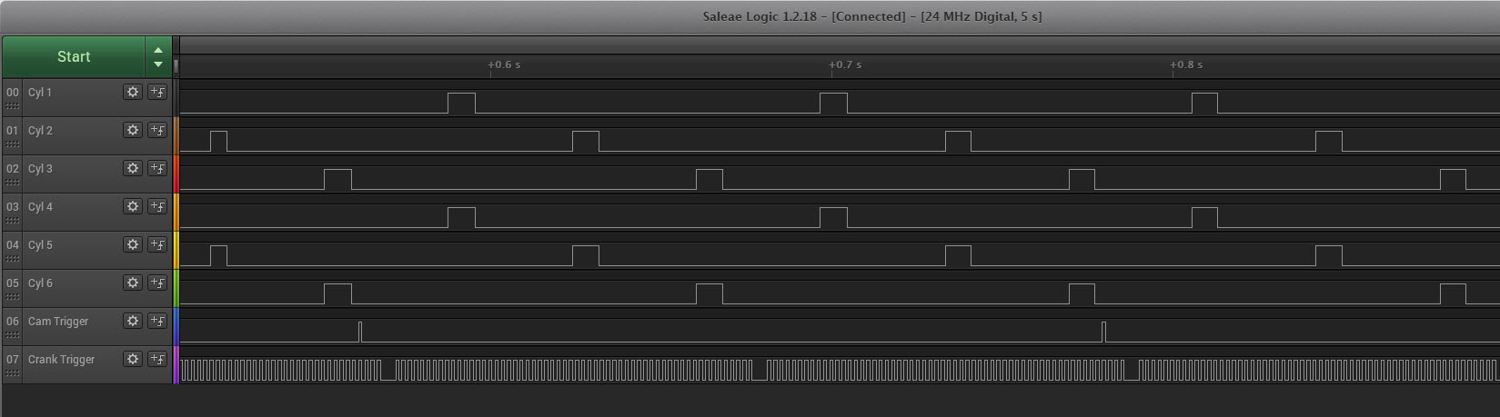

i've used one similar, only 8 channels though, its been great for working out trigger wheels and firing orders etc of some speeduino stuff i've been playing with for an Alloytec V6
60-2 trigger, 1 x cam (simulated from arduino) to test ecu firing order.
wasted spark.
sequential.

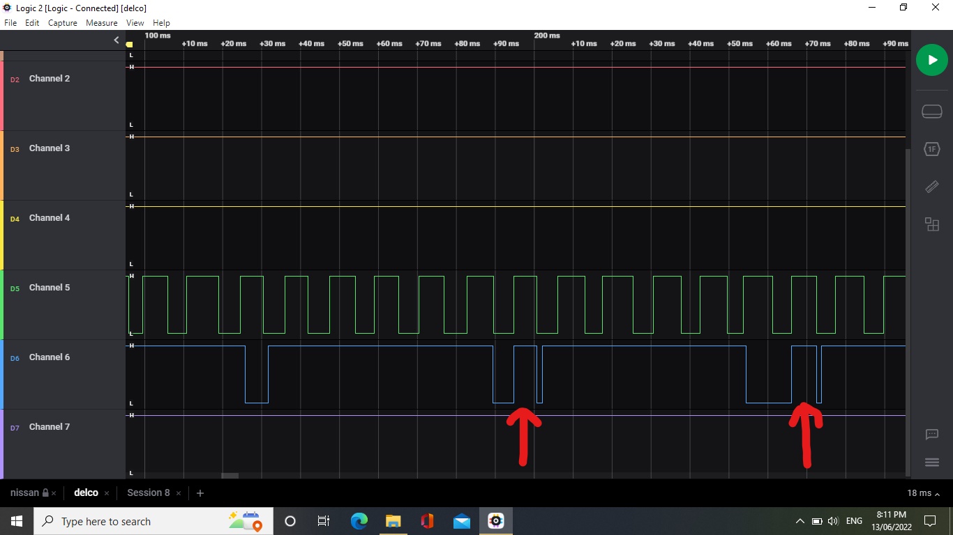

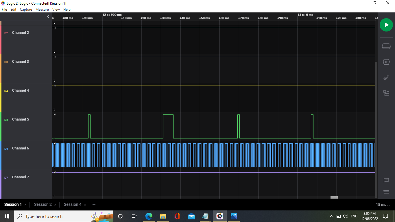

So its been awhile .... Just work and life lol.....I got my ebay digital sampler to check the output of the dizzy . I could see that the coil pack was sort of glitching . I will show screen shot of sample . the sample shows 18x is perfect no problems at all . the 3x side is slightly out of phase (pattern) I can change that but I have not been able to fix the glitch.
Also I am running new cas, and with the nissan disc back in the dizzy the pattern is perfect with no glitches.
with 360 1 deg slots and 6 sync slots (cant fit all onto screen this is the nissan sample)
I was thinking the beam was going through the cardboard so i coloured it in with black marker but made no difference. my slot holes are within a nat of perfect i dont think thats the problem, I am really out of ideas..... If anybody has an idea im all ears!!
