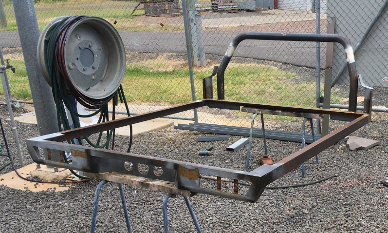

Anyway, have made a start on it again. But during that time the pricing of standard ute tray floor planks has got out of hand - when I started they were less than $28 each, but are around $150 each now so will use the old floor planks from the original tray. I had a complete rethink on the headboard and cut and shut it as best I could. It’s not what I wanted, and certainly not as good as what I have seen on other trays but looks OK (from a distance). The outer frame is made and all welded up and have fabricated new mounts to set it down by 50mm. There is fairly limited scope to drop them down too much and still have clearance to the tyres. I didn’t want wheel tubs in the tray, so 50mm it is. Bought some LED tail lights and recessed them in the rear bar. They are a larger sequential indicator style - not so keen on the slim line lights that don’t offer a lot of visibility – I think you kind of need to be seen and at least these can be seen. It nothing nearly as noice as a HQ bumper would be, but it was something that I was able to achieve and still look reasonable.
Anyway this is how is currently sits. Not much to look at right now, but is a work in progress.

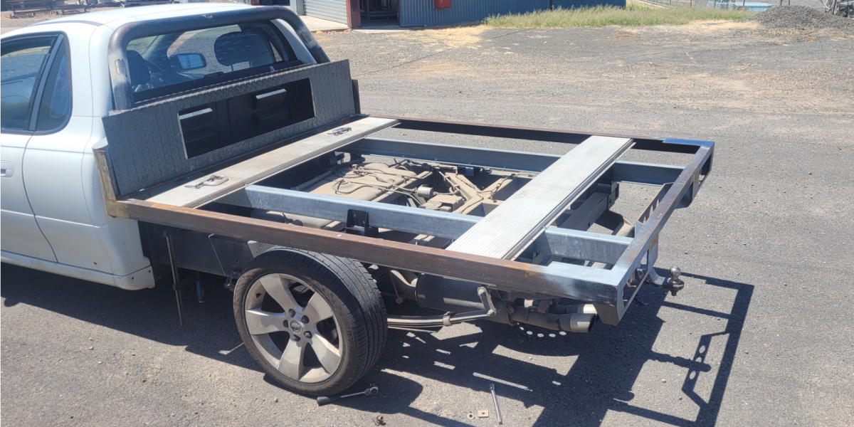

Haven’t made a great deal of progress. Been a bit snowed under work wise – probably no different to anyone else at the moment I guess.
Did a trial fit and the headboard is looking to be about where I wanted it sitting just shy of cab height. The new mounts I made though are completely wrong with the mounting holes. No surprises there really so will start again on them.

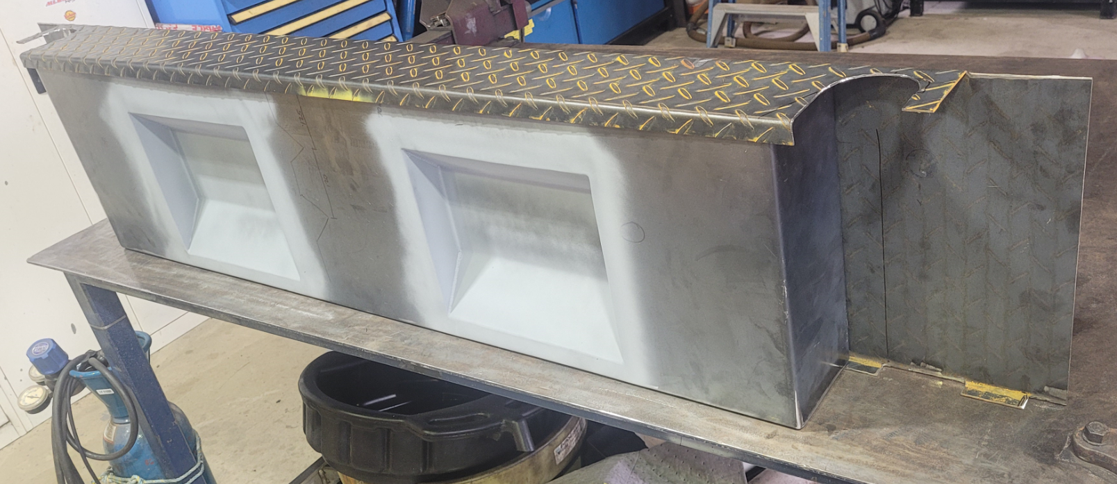

I also wanted to try to incorporate a bit of a storage area between the headboard and the cab. It won’t be very big, but it should get things like the jack, spare tyre winch handle, tie down straps and tools out of the cab. The back of it will need some recesses cut into it to clear the lumps on the back of the cab which will cut back on the useable space so have made a start on that. So far is looking OK and it’s not too heavy either yet – 2 people can lift it easily still. I suspect by far the most weight added will no doubt be in the 400 load resistors that I will need to get the LED tail lights working.

Good idea with the head board storage box! What type of door are you going to fit to it? On hinges or a sliding type setup?

The door will be hinged and will just be the section of checker plate that I have cut out. Have ordered some stainless hinges and thinking a couple of t-handle locks at the top would do the trick. It won’t sit flush with the hinges, but hopefully will look OK while being functional. It won’t be water proof either, but none of the under tray boxes you can buy really are.
If I aim too high, I recon I will get nowhere. So it won’t be too elaborate as trying to keep it within my skill level.

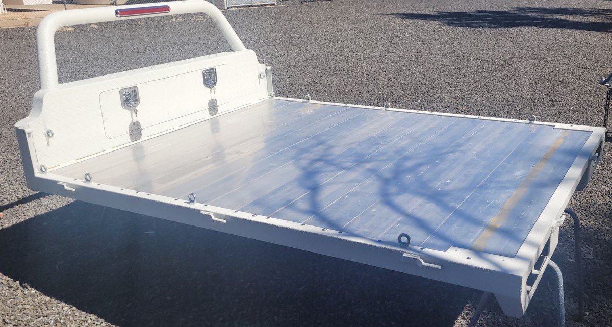

Post by brindo »
I ended up getting some off cuts of the horse float extrusions for the tray floor at a reasonable price rather than reusing the old tray planks. These are a smooth finish rather than the ribs, but have decent load rating. I was intending of using a Ranger high level brake light but had second thoughts once I saw how much metal I would have to cut out. Have painted it in Raptor matched to the cab colour, and can’t say I am entirely happy with how it turned out - but this is purely a skills issue on my part. But bolted it all up and this is how the tray has sat for the last few months - pretty much finished other than the sideboards, which gave me some heartburn.

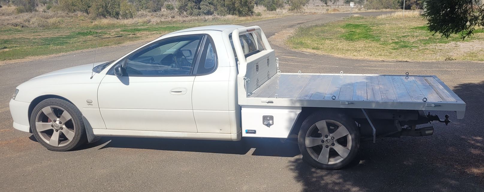

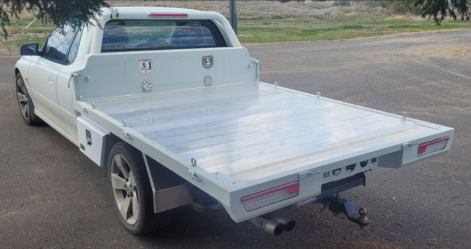

So I had made the sideboards with the old profile and haven’t done anything with the new profile yet, but decided to fit the tray anyway. It’s certainly a lot heavier than the original tray, and am yet to sort the fuel filler and RH side undertray box out yet. Definitely doesn’t look as good as some of the other trays I have seen but it should be functional and do what I need it to do. It’s sitting another 50mm lower and still looks to have plenty of clearance to the tyres. There is a huge improvement in visibility and the side mirrors actually have a purpose now with the only part of the tray I can see in the rear view mirror is a little bit of the top of the tool box. Think I have run out of excuses now not to reverse park and stay in the lines.
Going for a drive, the first thing you notice (other than one of the floor planks rattling at idle :x ) is how much quieter it is in the cab, which I guess is the tray dragging less air. I have only been for a short drive on the highway, but the real surprise is that its pulling another 2-3”Hg of vacuum at highway speeds. Yet to take it for long drive, but didn’t think there would be that much improvement. It might only have another 1” Hg vacuum at 60km/hr if that, but just goes to show how much things like ute trays, roof racks, bullbars etc can affect aerodynamics. I was worried about the extra weight but potentially there might be a bit of an improvement in the fuel economy.
Anyway pretty happy its finally fitted and even if its a case of looks good from far, but far from good.
