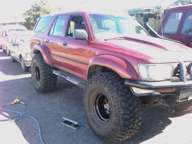

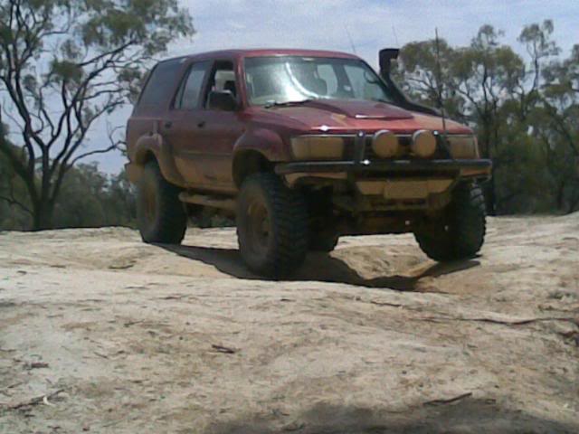

just a few shots of my 92 4runner, currently running a 355ci, previous to that was a 304 (the smoky death), and previous to that was a 3.8.
coming up to tuning time in the next few months so i thought i'd jump on board and pick your brains here and there when i get to it. got a fwe things on the go with the car at the moment as its been pulled off the road to get ready to race short course tracks.
just a quick wheel lifting hill climb vid with the 304

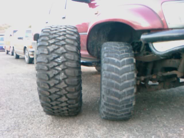

its not too bad but currently severely restricted through the snorkel, it only has a 40mm outlet on it. in the midst of building a twin throttle setup with twin 3" snorkels to overcome this. the new treads to go on once the suspension work is done will need all the torque they can get!

That is one awesome rig man! Lookin forward to seeing it in action with the 37s (?)!! Will need to visit the icelandic boys for some flares :lol:

yeah they're 38's, will be a fair while before its driveable again. its currently in the shed awaiting major surgery. not gonna be much toyota left.
the flares on it currently are 80mm, the largest you can get in aus and as far as i'm aware only available from one company whos name has slipped from m memory.
