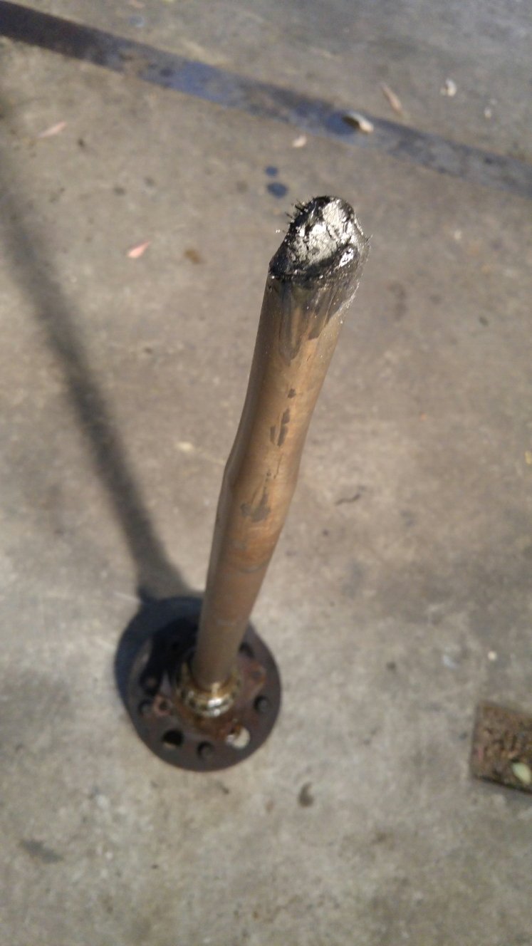

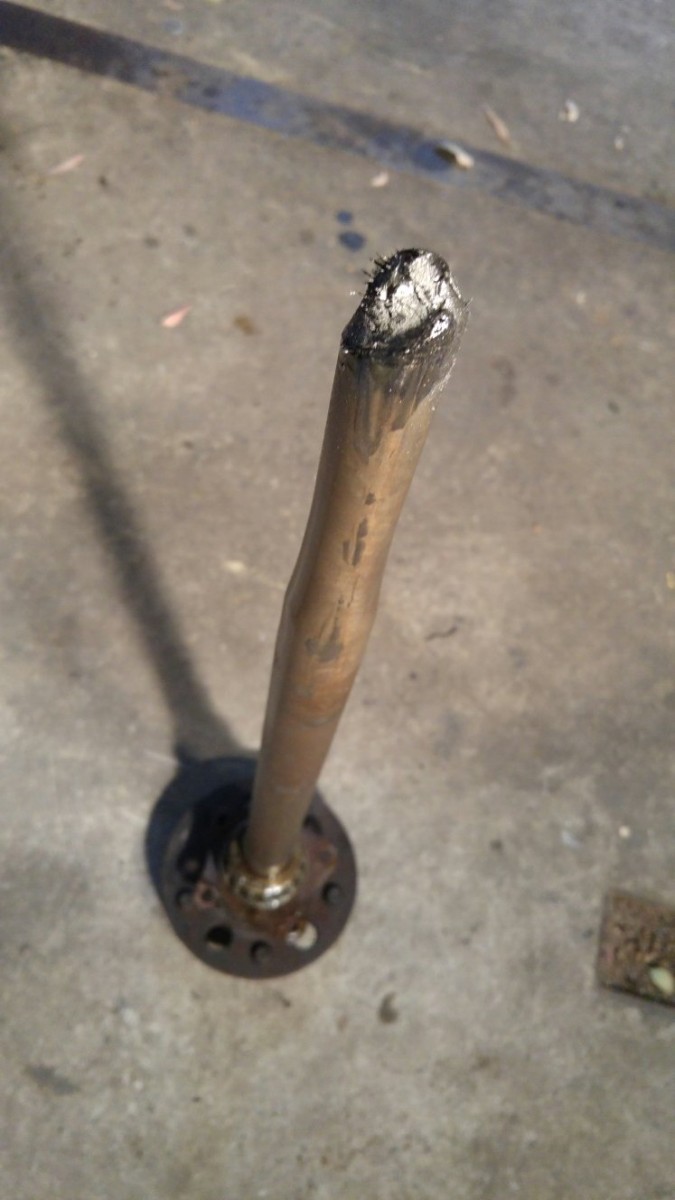

Ive gotten to the bottom of my traction problems encountered this year..... Unfortunately the plans to improve the car at my mates workshop rapidly went backwards at this point.

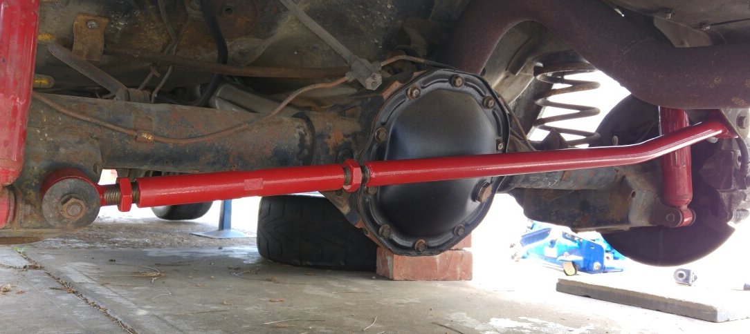

we converted our customers to a shortened commodore unit and trutrac for that same reason, you can buy a torque tube eliminator kit from some where...
I'll do some digging and and find it for you

McDonald brothers racing do a kit for that http://www.mcdonaldbrosracing.com.au/geminicontrol.html

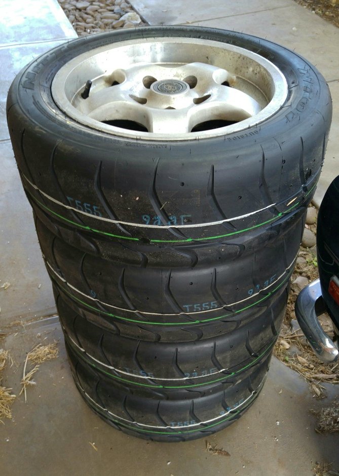

im liking the look of the tyres though :D I assume they are nice sticky compound ?

Actually its a stock centre with heaps of nuts n bolts and metal welded in to make it a really tough locker. Stock torque tube is handling the power fine, they just need good rubbers to keep them located as they should be. The axles are commodore axels for the commodore brake conversion shortened and resplined to suit the stock gemini RTS spine. So re-heat treatment of those axels and the lesser spline, combined with the stress of grippy tyres and slow seed manouvering is probably what broke it in the first place. Interesting that the splines didnt shread, just a pretty clean break. Am considering an upgrade, but want to keep it simple and cheap. Replacing the axle and doing it again is looking like a cheap an easy option. If I get 2 years out of the axle thats probably good value.

Yes those tyres are looking promising, nitto nt01s. They feel sticky to the touch!

I'd reckon that sticker tyres it going to cause more broken axles (I've broken too many to count) remember that the Gemini was a low powered, light weight, open diff vehicle with very small tyre contact patches. Yours is now high powered, heavier, locked diff with very big tyre contact patches with grip that will be awsome!!! Poor little diameter axle ends don't have much chance.
One answer would be to leave the setup you have in there and change to LSD or trutrac (if they make one to suit the small housing), that will take a lot of the torsional stresses out of the axles. As a bonus it will make you faster - take the under steer (push) out of the corner entry and over steer (tail outness) on exit. Locked axles are good for drag racing and breaking axles - thats all...
