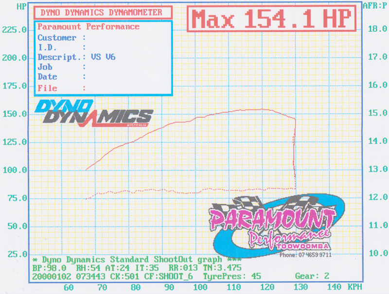

Ok here's the dyno run. Looks ok for amount of KM? slip rpm held ok on the auto

LMAO, sorry didn't reply about pads but yeah like I referred too 1086, but 1376 will do the job I think there just set slightly higher on the backing plate.
Nice with log & graph, my best guess with the rockers & tune should nudge 170, but 154 with the mod's you have is pretty good for an old girl!

not bad at all!
its interesting to see that the black o2 sensor track gets leaner each run you do!!! dyno seems to show its not to bad fueling wise though but should probably go a bit leaner on the low rpm s if you wanted to!!

Re: The1's Daily
Yeah I 2nd that, I've found from my test's can go better anywhere between 12.8 to 13, all depending on other components(fuel, timing & the likes!).
Re: The1's Daily
yeh was rather cool day, had been tuning in 30+ and was doing 12.6 - 12.8, got around 12.4 in the logs, so i guess with each run everything's warming up more, all good, it's either rich best or lean best, probably not alot in it either way? Next dyno will be after fitting 1.95 YT's.

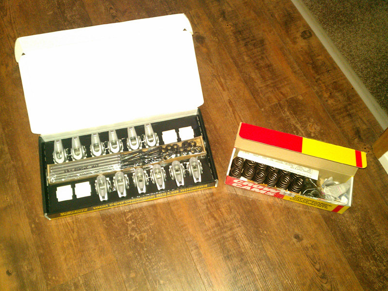

Well i have put some rockers YT 1.95 and 105 springs in yesterday, will tune it up over the next few weeks then get another dyno run done, by the logs looks like 50-80 cylair gain in the low/mid area.

Re: The1's Daily
what percentage of cylair is that do you know ?
Re: The1's Daily
normally gets up to 600cylair, did a wot today, had to change the fueling by one hex value, cylair peaks at 630. I dont think im getting any extra performance, can't really tell any difference, i guess because i already have intake and exhaust opened up so it wont flow anymore. My 0-100KM is still 8 seconds same as before.
Re: The1's Daily
you should notice a bit i would think, i did a change from 1.5 to 1.65 rockers on my 202 and i could feel that mostly mid range. it never used to break traction once i got it moving, but once i put the rockers on it did at about 3500rpm!!
i guess the dyno will tell the tale!
