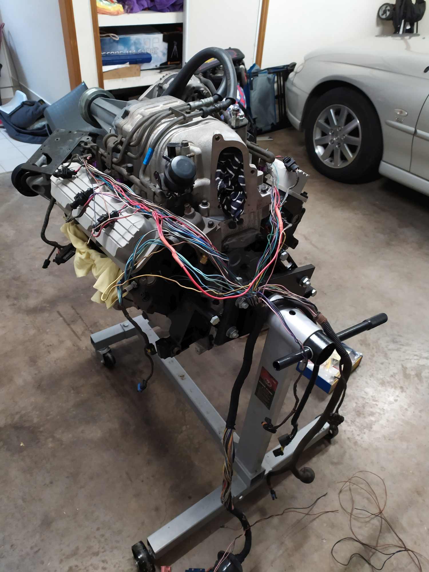

couple of phone pics, i have others on my camera ill have to get to sometime.

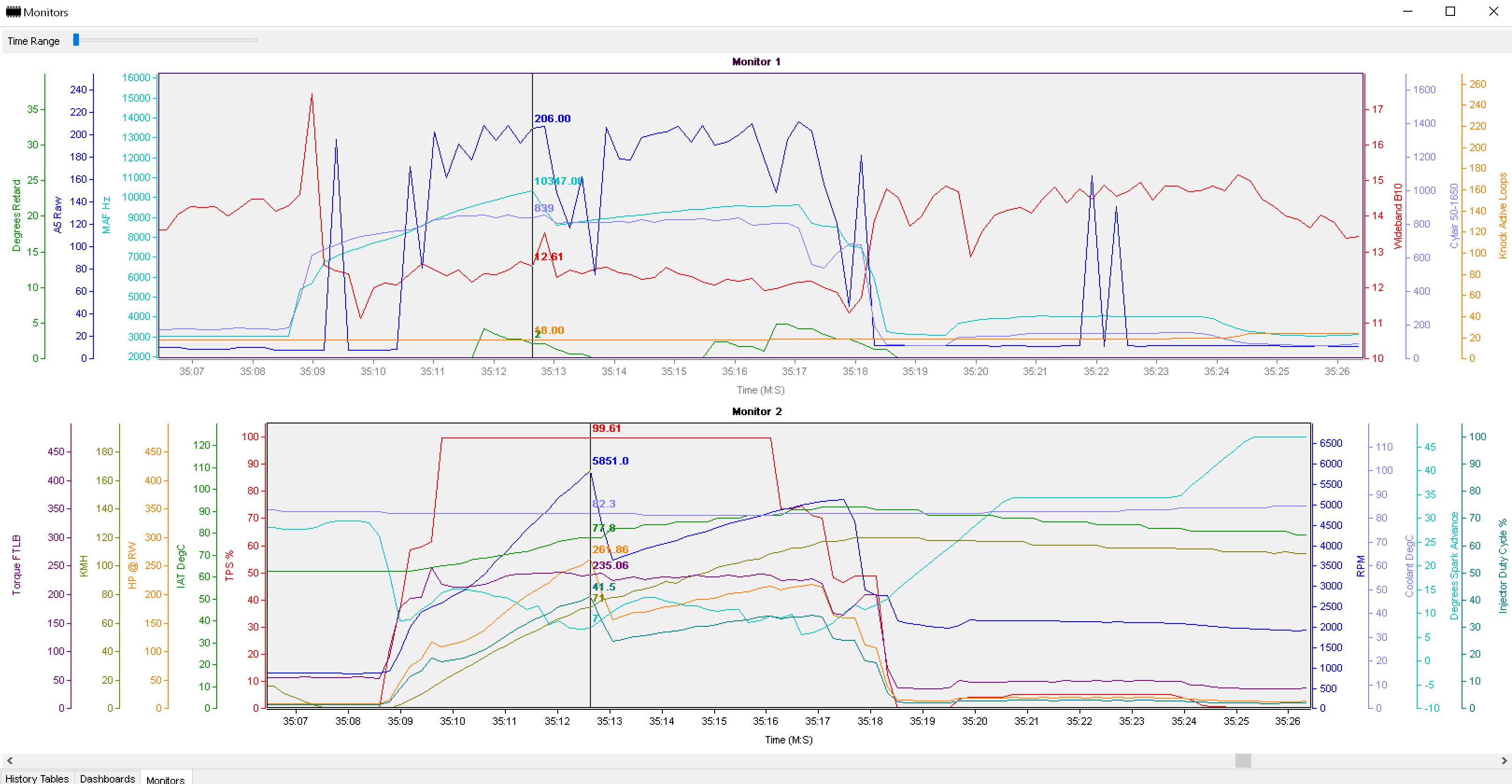

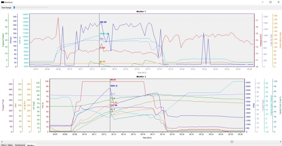

Tune is still ruff but did a 0-100 today, about 6 seconds so happy with that and some tuning to do still yet, will get a 2 bar map on it to sometime so i can log with that also and see what boost it's putting out, will be less than 10psi with the cam, about 260HP at wheels for an estimate from the log. Hopefully with a fixed tune it'l make the 200rwkw.

The1 wrote:will give them a go and see what they say. Ive done like the above so far with some VE connectors
Whats the cable thats hanging off the hook bracket on the firewall there. The one with the steel spiral outer sheath?
Throttle cable
