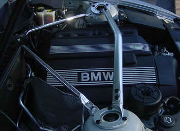

the welds break from up and down pounding, not smooth sideways flexing (unless sliding sideways over a ripple strip or similar) which no strut brace currently available helps much with due to having a clevis type design, not a solid 1 piece design like its suppose to be. Been down this path before, not feasible unless I custom make a brace that requires a hole in the bonnet to fit.
To be any good in that respect you need a brace design like this but even then it still won't stop up/down flex much but at least it will work correctly for what they are suppose to reduce, sideways flex.

If you look at the inner guard you'll find they distribute flexing over a large area in sideways dirrections, also coupled with the fact the only real sideways loading is due to weight transfer during cornering which in nature is a just smooth loading and not shock loading.
For up/down loading the inner guards and towers don't have much give (like a tin's strength up/down verse across its width) and that coupled with shock loads seen with suspension travel the welds get stressed much much more in this scenario. Therefore a brace and also the fact they do not brace at all in up/down movement by nature and more so that these have a pivoting clevis won't prevent welds breaking in extreme shock loads or in the case of solid strut tops.
The argument was nothing about handling and purely about complete lack of up/down bracing where breakage would occur.

Your theory is based on a clevis joint that is free to move in the vertical plane which is not the case with most strut braces.
A simple test would be to jack the front driver side (like you would to change a tyre) with and without a strut brace fitted. If you are correct than the body pan would twist the same amount regardless.
If there is less movement in the chassis then the suspension is better able to do it's job.
