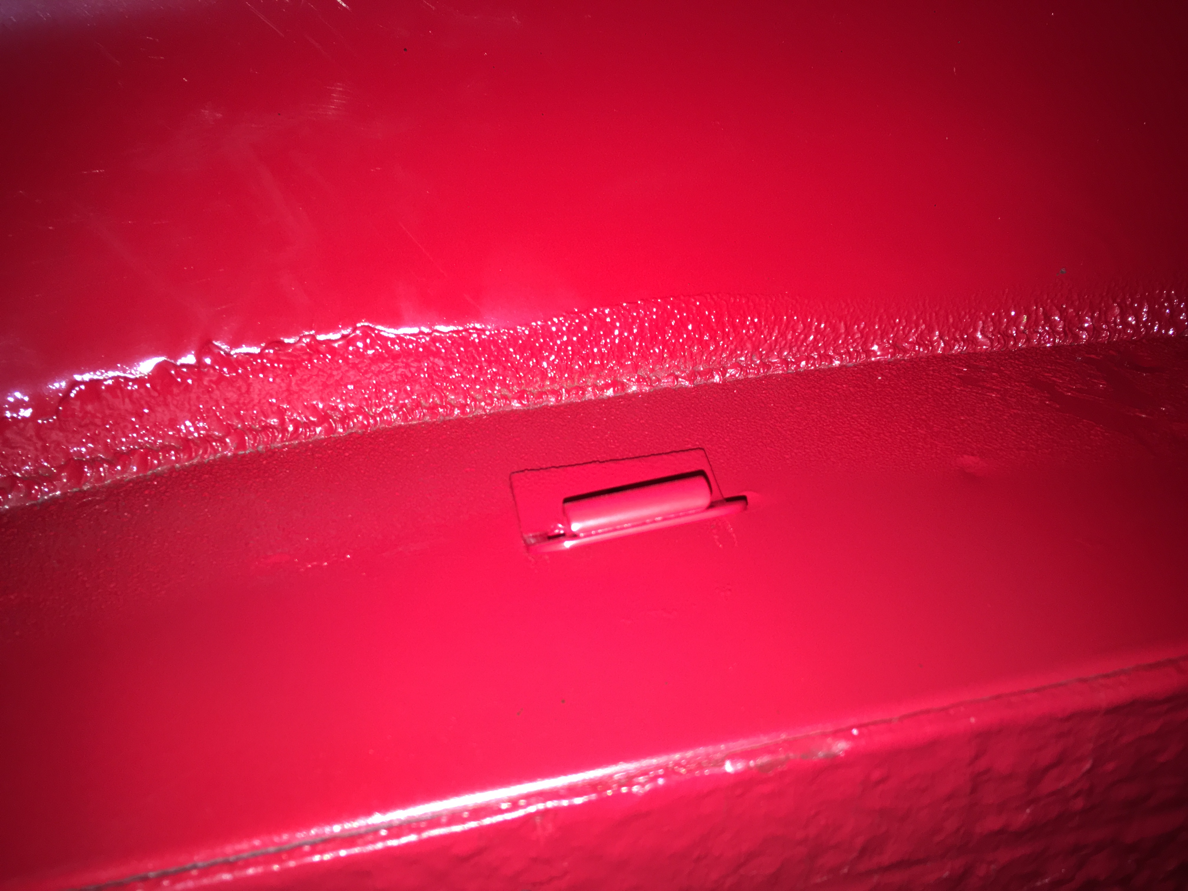

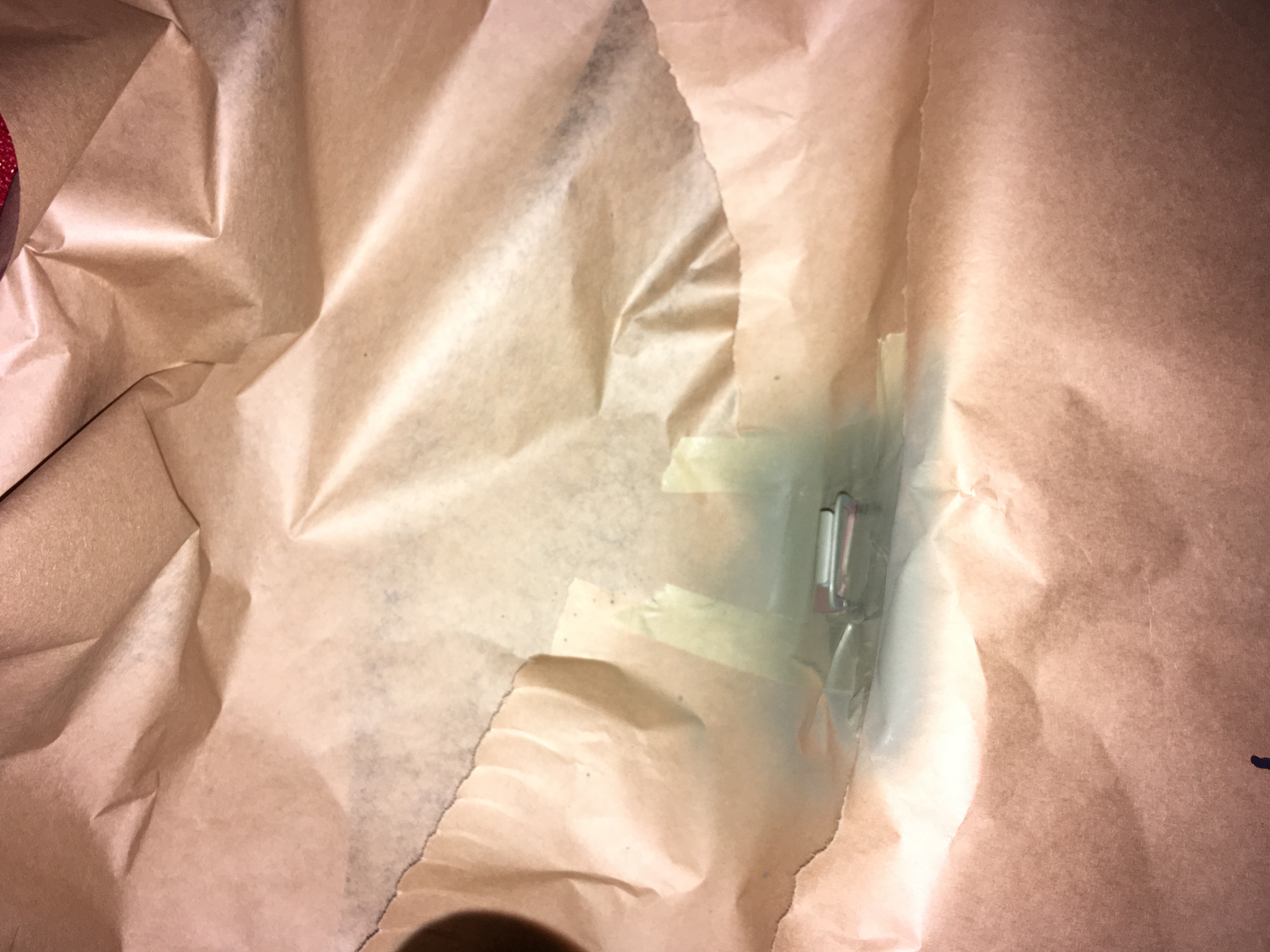

In the spare wheel well the lower hold down point was missed for de-rusting when the car was done and it had a good 1-1.5mm thick crust of rust that was painted over.
I used the corral type wheel and wire wheel to get it all bare and masked and primed it.
Then removed the mask and gave it a light blow over with colour coded touch up can, damn perfect match. I honestly can't tell.

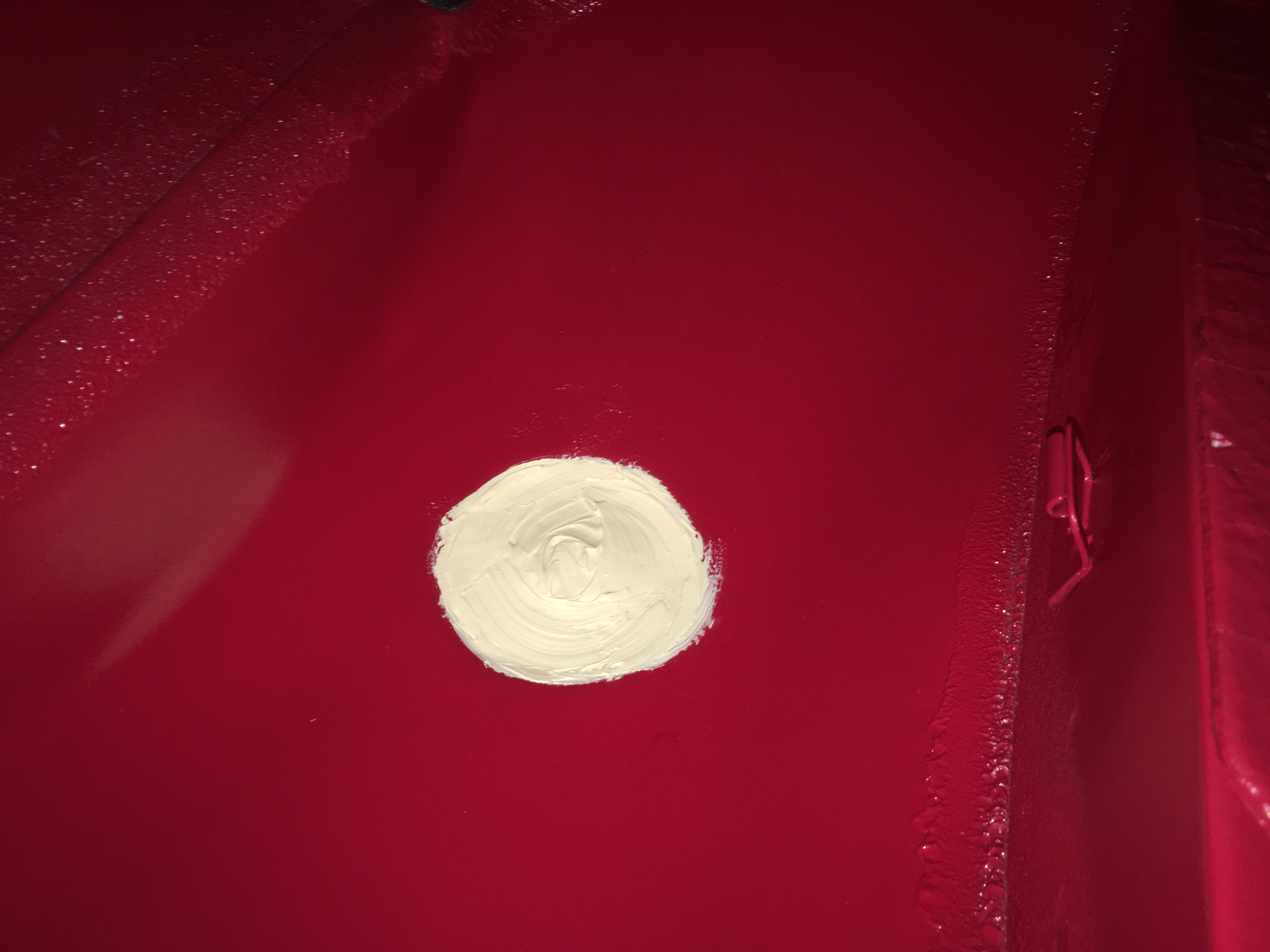

Then I finally got the drain plate covered in the correct seal sealer. Henkel product I believe.

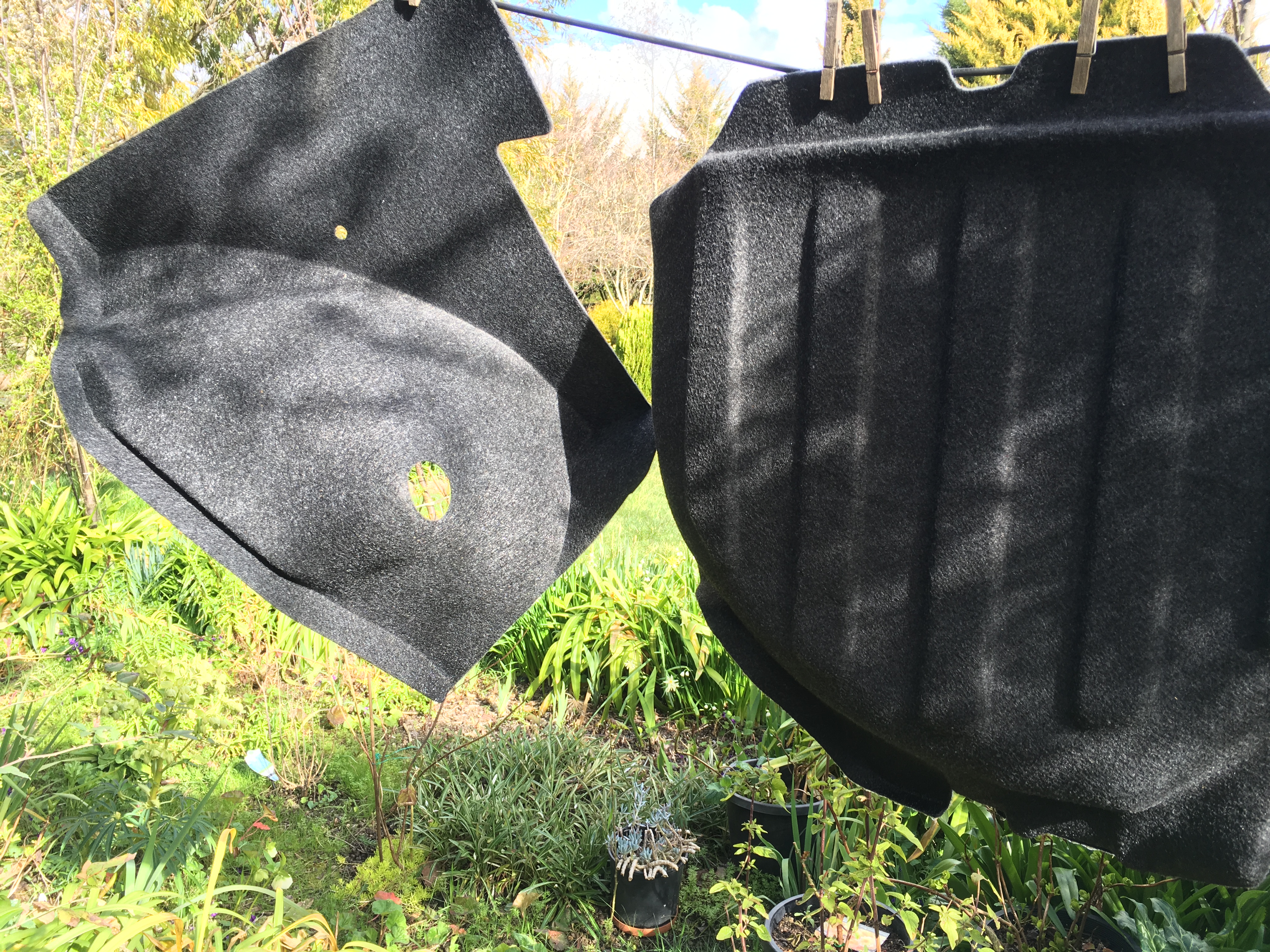

Got out all the felt carpeting except the main carpet (needs the underlay replaced) and washed them all.
First one in and I also got my restored jack with correct repro decals in. I gave it a spray and wipe down with Rem oil to preserve the nice zinc planting.

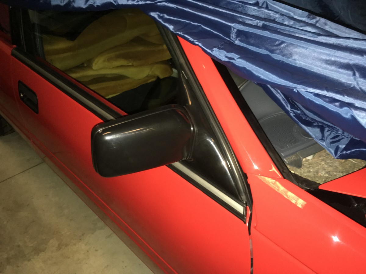

Aftermarket mirrors arrived, not bad at all. They operate much smoother than the originals. Moulding quality is not 100% but pretty decent. I found later the originals are a completely sealed unit, the mirror and motor unit are plastic welded into the mirror head casing and can't be removed. These aftermarket actually have the unit screwed in just at the corners behind the glass, so you can pull them apart.
Also if you remove the spring on the factory ones, it's one big spring that loops around the length of the inside of head so good luck getting that back together. I sacrificed one good used mirror to find out ahh nope. Don't bother.

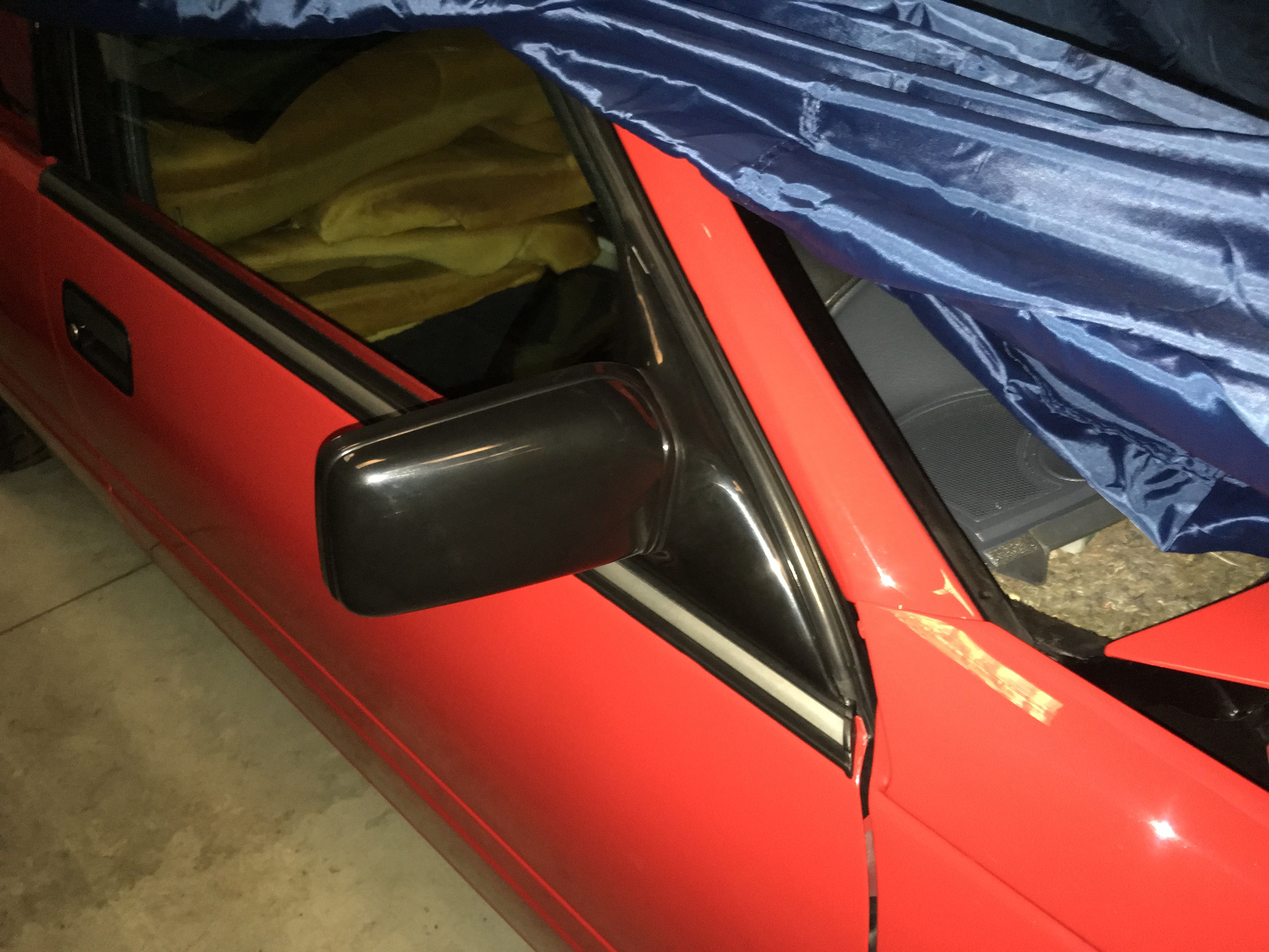

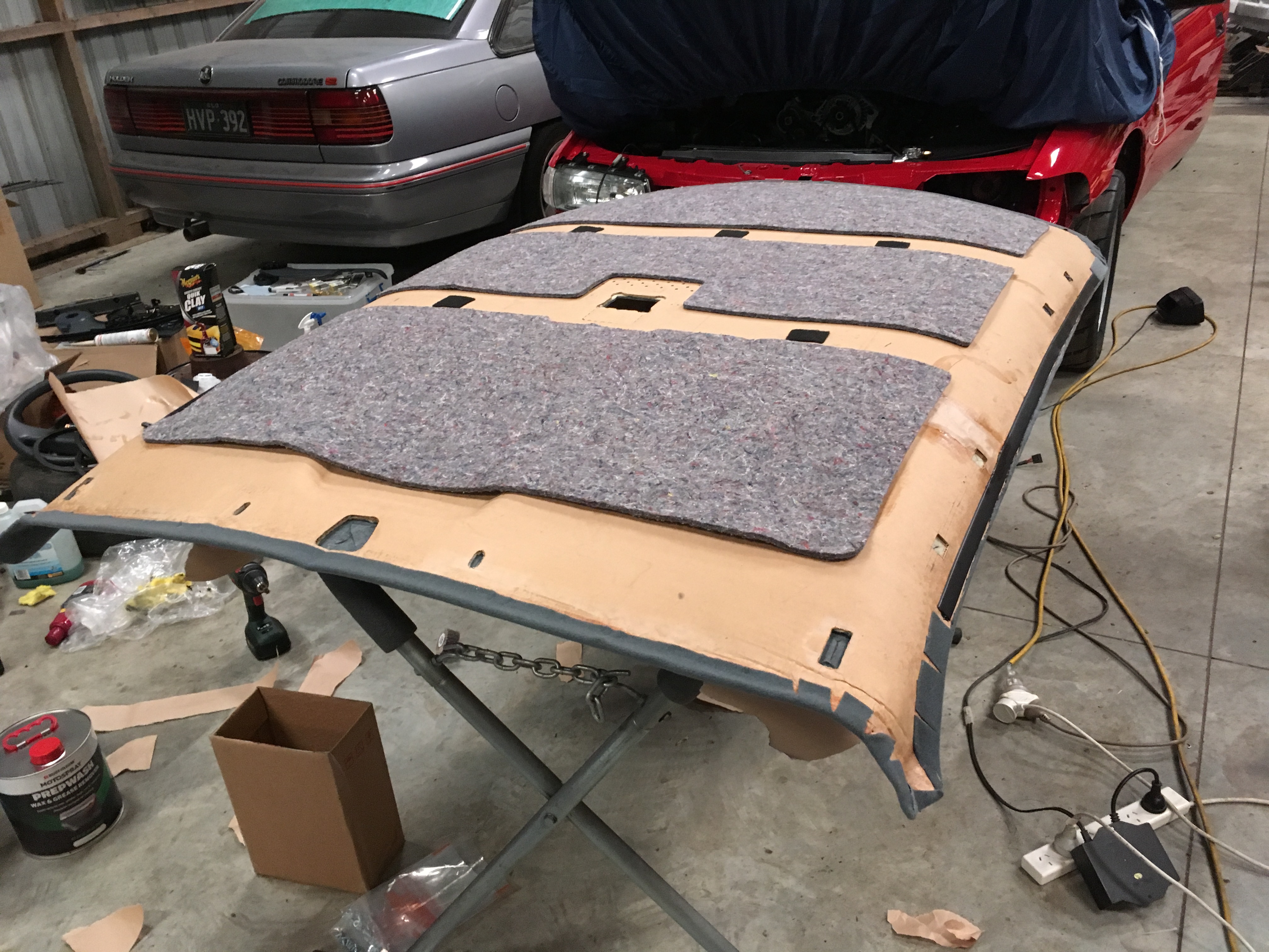

Had my new lining waiting under a cover since 2015! Got it out and it had the plastic side stiffner strips missing, so I got a bunch from the wreckers and trimmed the fabric off to make room for those.
Sika flex'd them on and held them in place with cloths pegs, about 50 of them and let set overnight.
Today I finished off by measuring and cutting 2 holes for the front passenger holy shit handle as this one was missing the holes for them, must of come from a VN I think?
Then I glued the felt padding on as the factory leave them loose on top, but they cause havoc when installing the liner and get caught on the velcro tabs.
Then I installed the rear left and right side trims over the quarter windows but left them not pressed in all the way to give a 10mm or so gap up top for the liner to slide over and into them.
I then put sheets of masking paper over the velcro patches to stop it sticking until I was sure everything was in place and lined up.
So spent the next hour or so getting the trims in place and installing the holy shit handles, dome light and to make sure everything was lined up and then I held the liner up against the roof and pulled the sheets allowing the velcro to stick. Finished the rest of the trims later in the day.

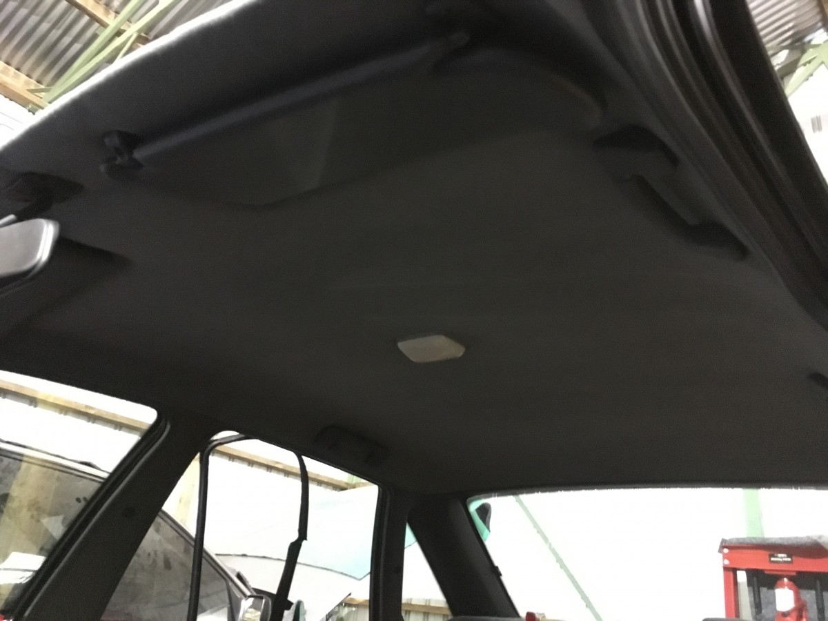

So I finished off the day with this. So nice to get to this stage. A lining makes a big difference in how complete a project feels.

Looking great. I am concerned over one small thing though, that being your drain plug. Every commodore I have had that was in this configuration (ie spare to the passenger side rear rail) the drain plug was only clipped in and had no sealer. Now while in the 6 early configurations I had only two of them were brand new. They were all the same no sealer. My understanding was that the plug was designed to drain any moisture out but nto really let any in. In every commodore I have seen with the hole plugged the spare wheel well has rusted out.
Where did you find the information for the plug to be sealed as I am very curious now.
