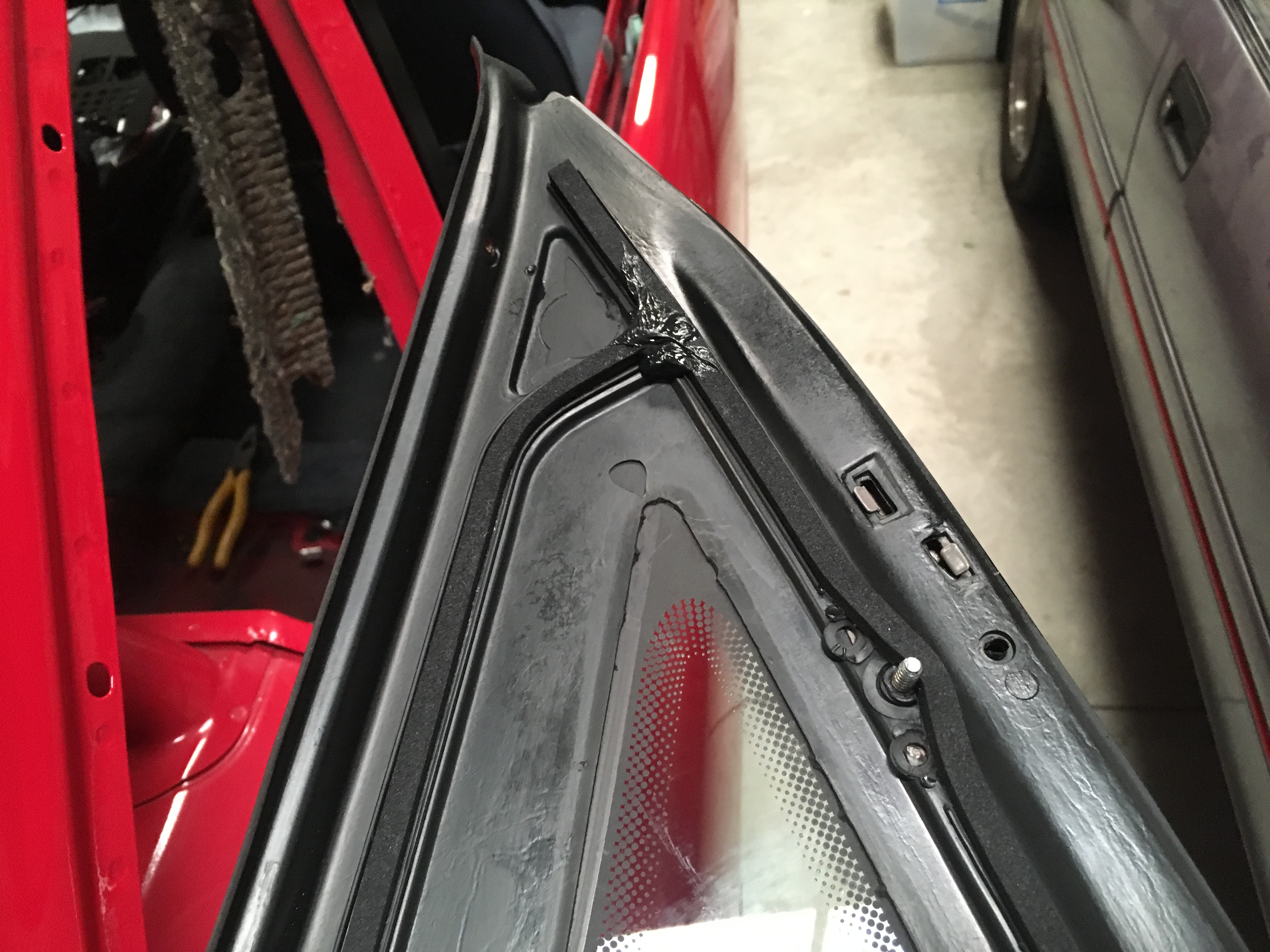

Finally got the EPDM foam seal. I got 4m of 48mm wide this time so I had plenty in case I fucked up as I needed to cut a 6mm wide strip while its 6mm thick so its a bit hard holding it, but this time its 48mm wide so much easier than the 12mm strip I got last time.
Turned out great!
Some butyl mastic on the gap as factory.
Fitted and looking NOS even though its a Vlad's special restored original and not actually NOS.

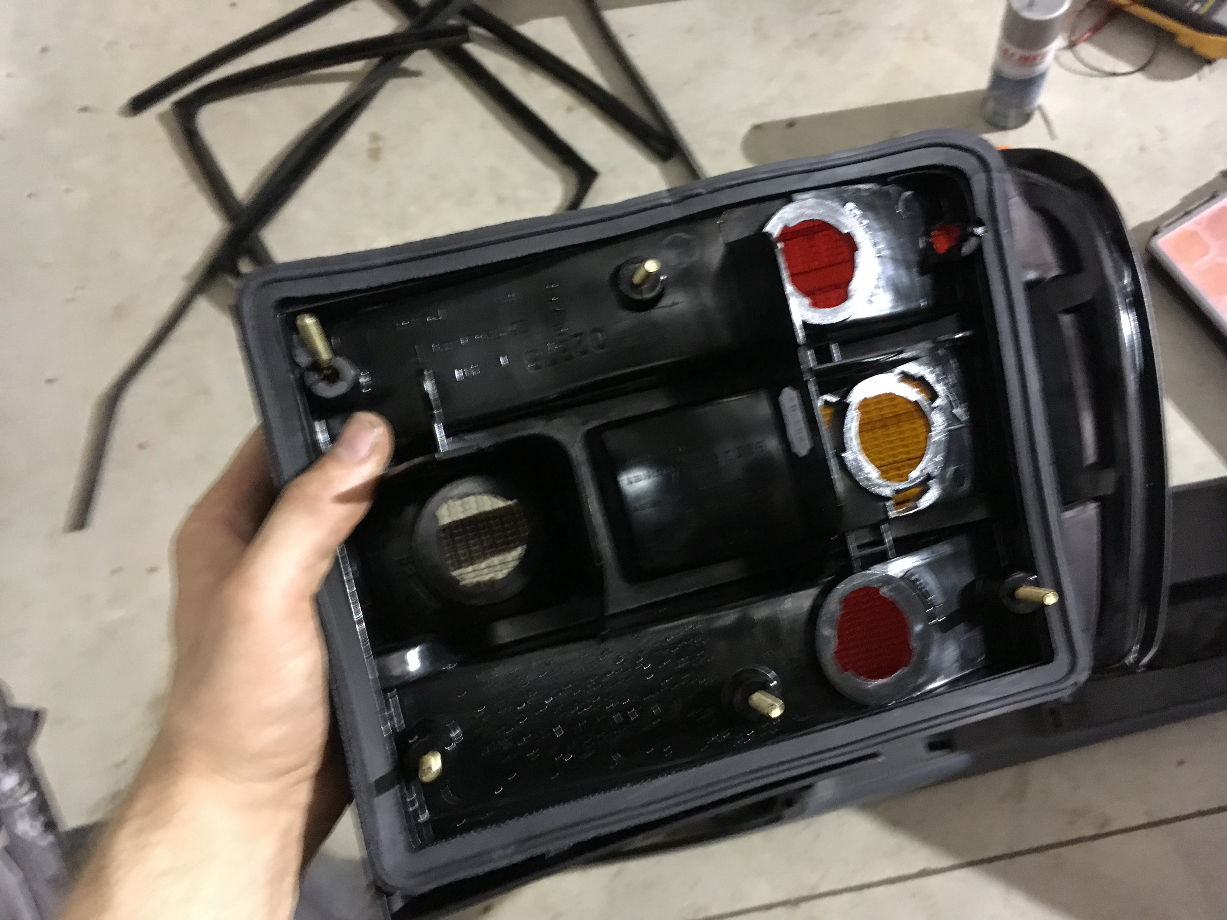

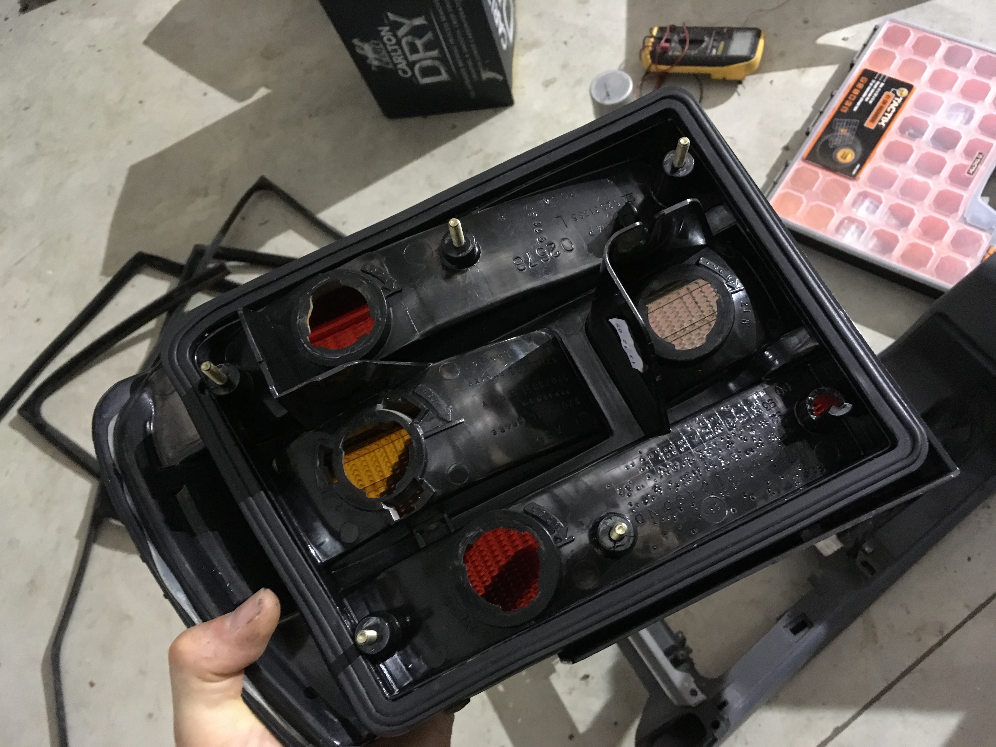

Some NOS stuff isn't good though. As with this tail light, so brittle and weak I barley got them nipped up and all the posts broke, the already slightly cracked used one fared a little better but also broke. I was even able to crumble the plastic with my finger nails lol.

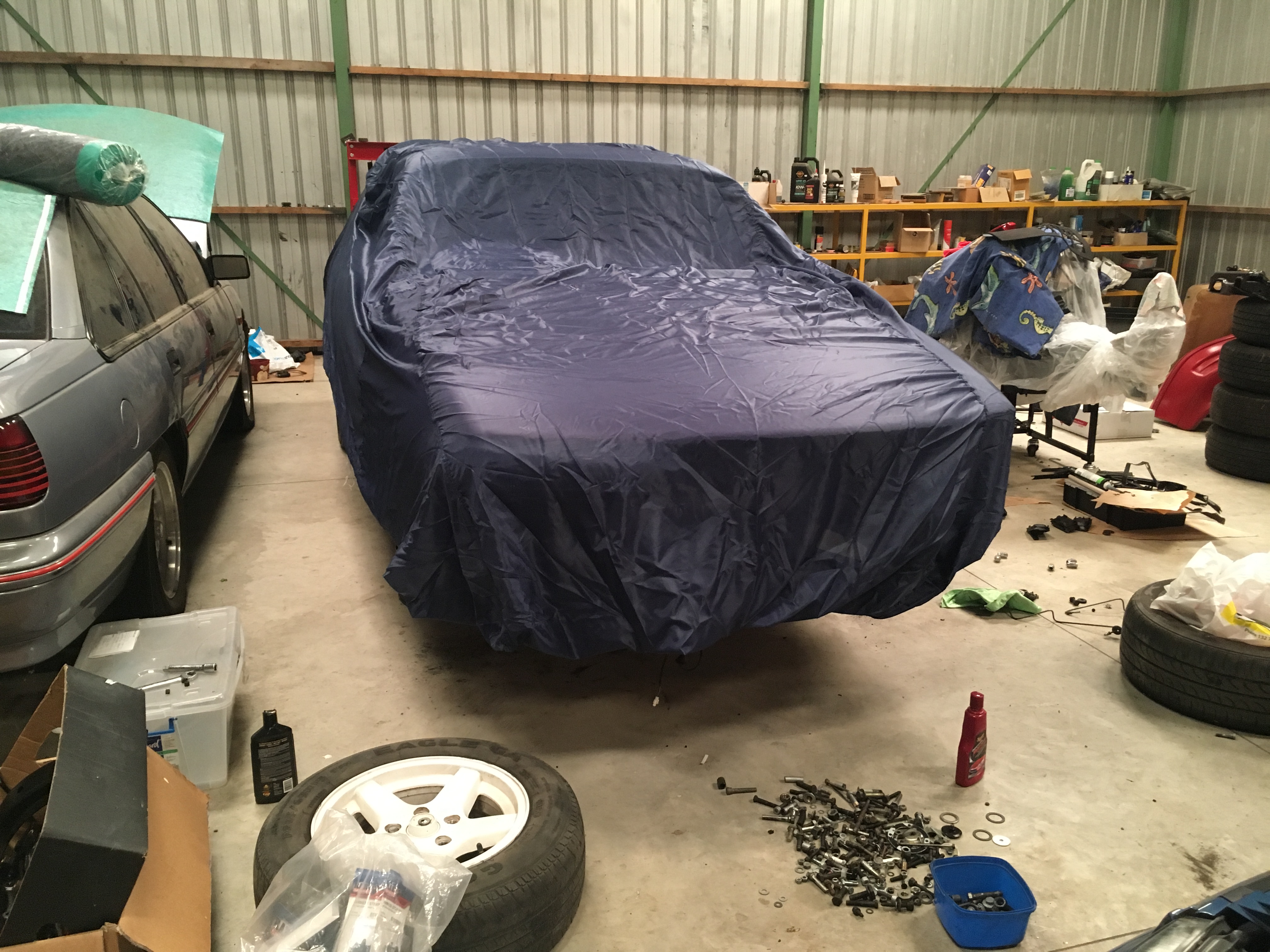

I also got a cover for the car to keep spiders off mainly as their shit eats paint like paint stripper, have already had to re-cit and polish a few areas they shat on. Bonus is it keeps the dust off too
Turned out great!

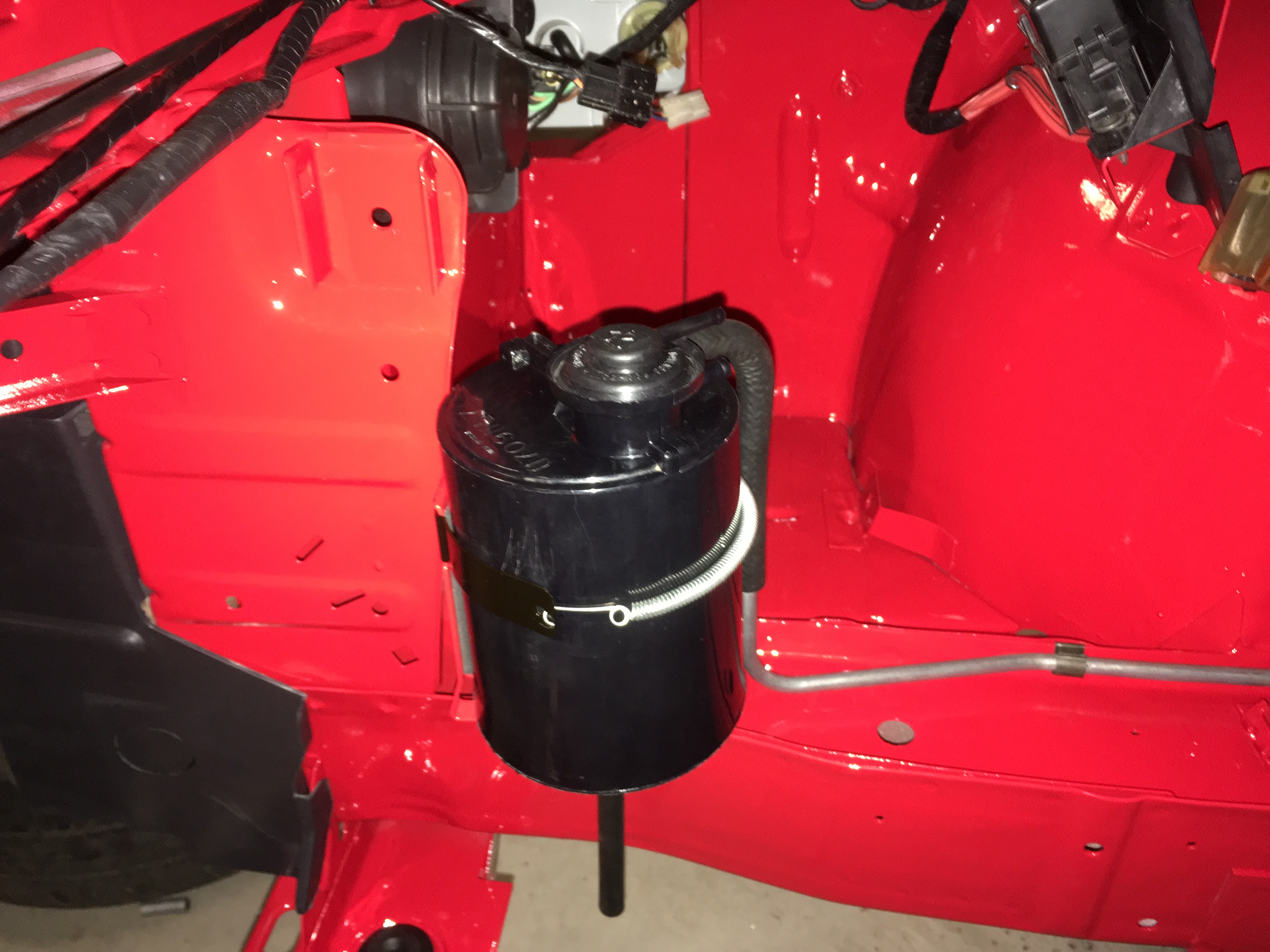

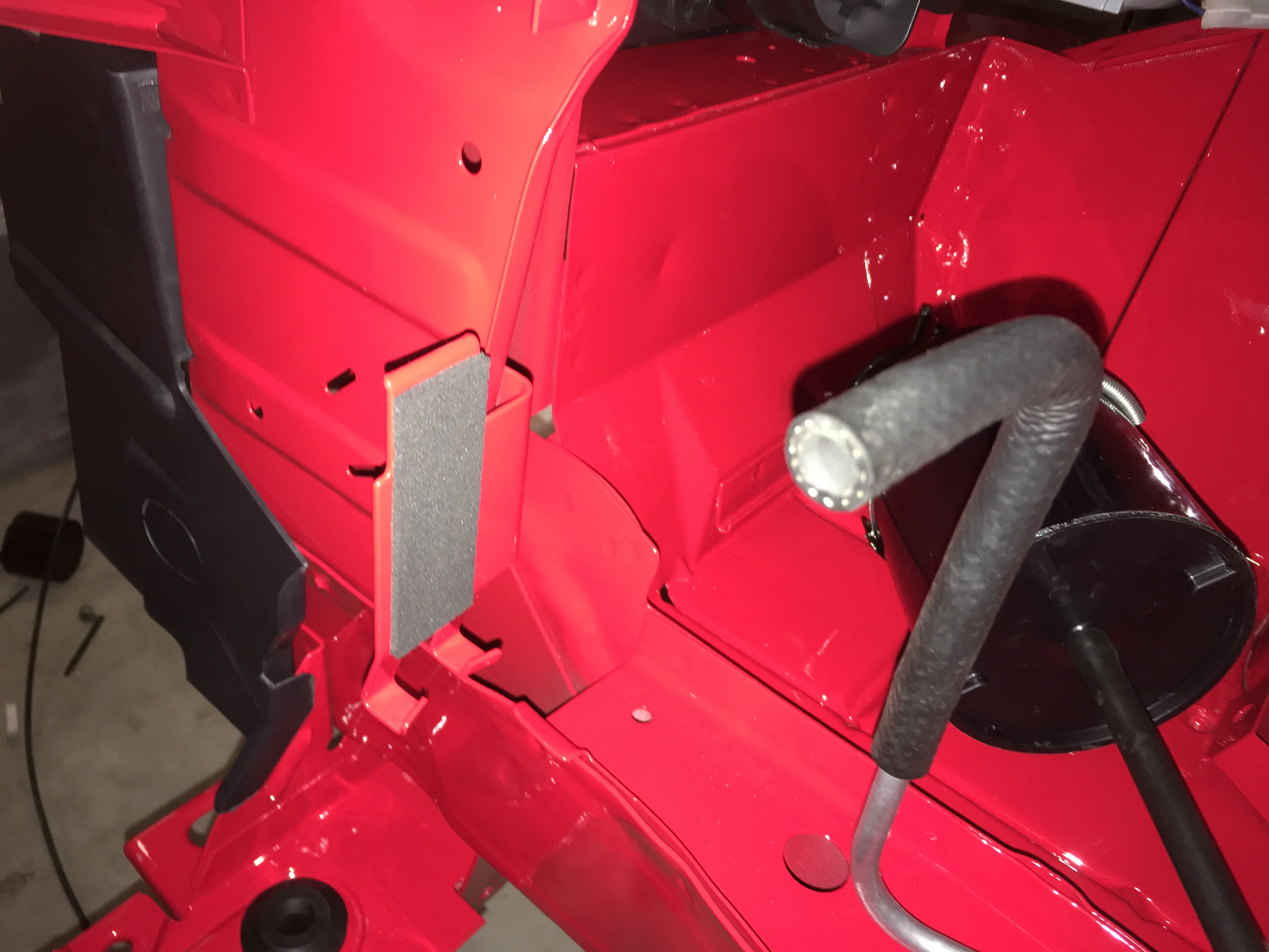

Fitted the charcoal canister. I put a strip of EPDM to stop vibration from fretting through the paint.
Lucky I found another canister in my parts boxes as all the other ones I had were eaten by battery acid and had deep ulcer like craters all over the side facing the battery. Gave it a wash and polish, fitted the e-coated bracket and zinc plated spring and looks mint now!

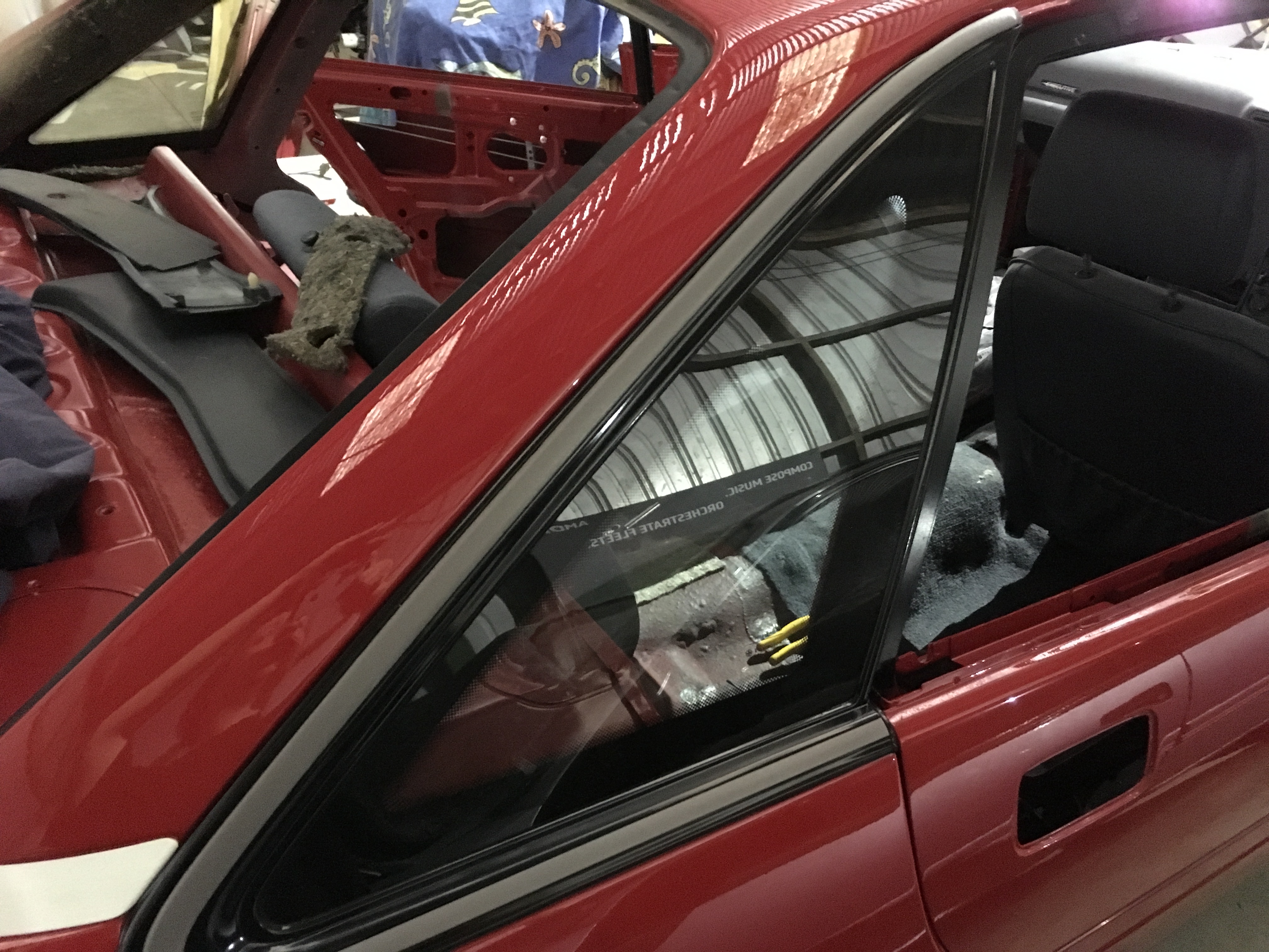

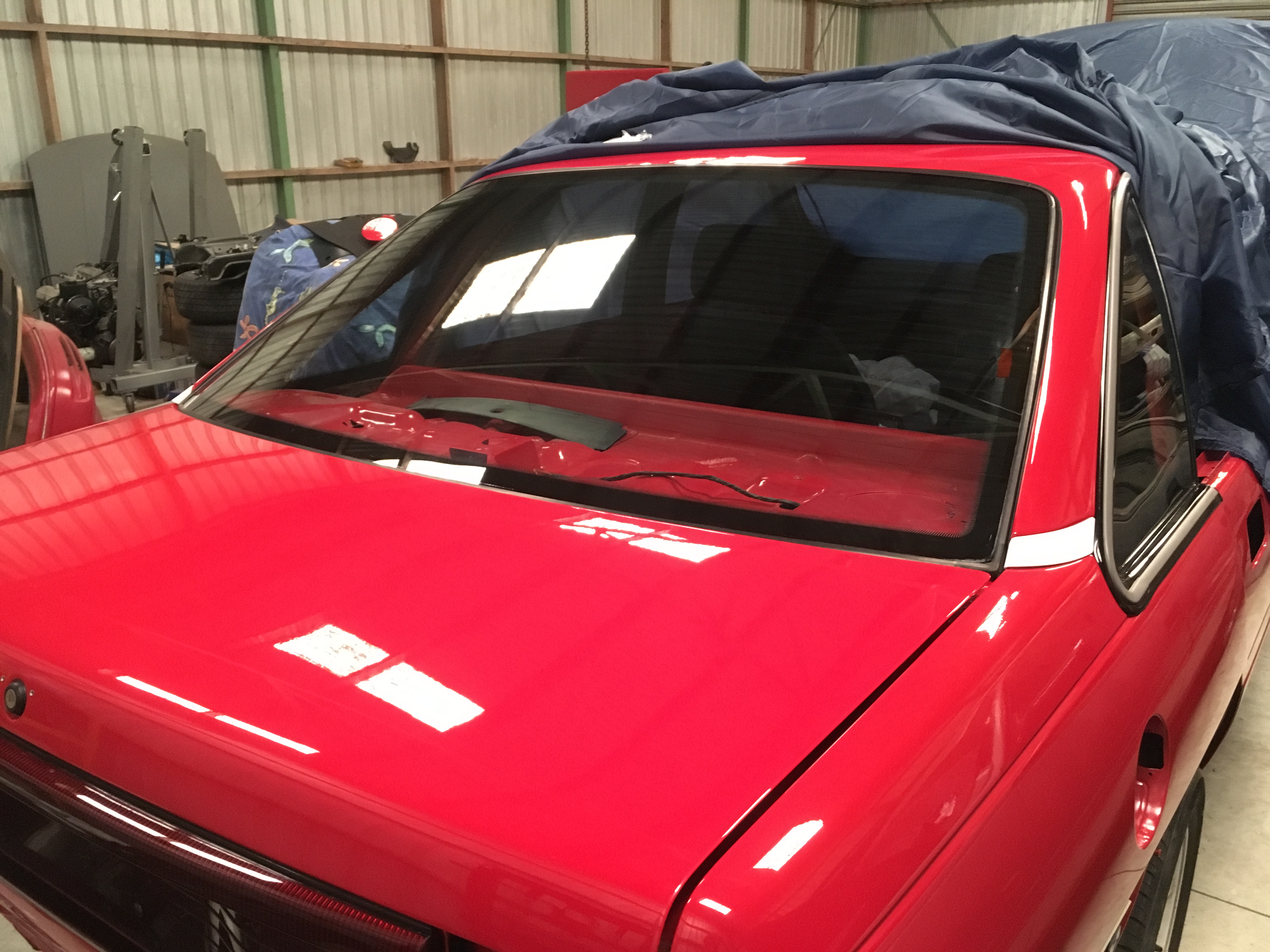

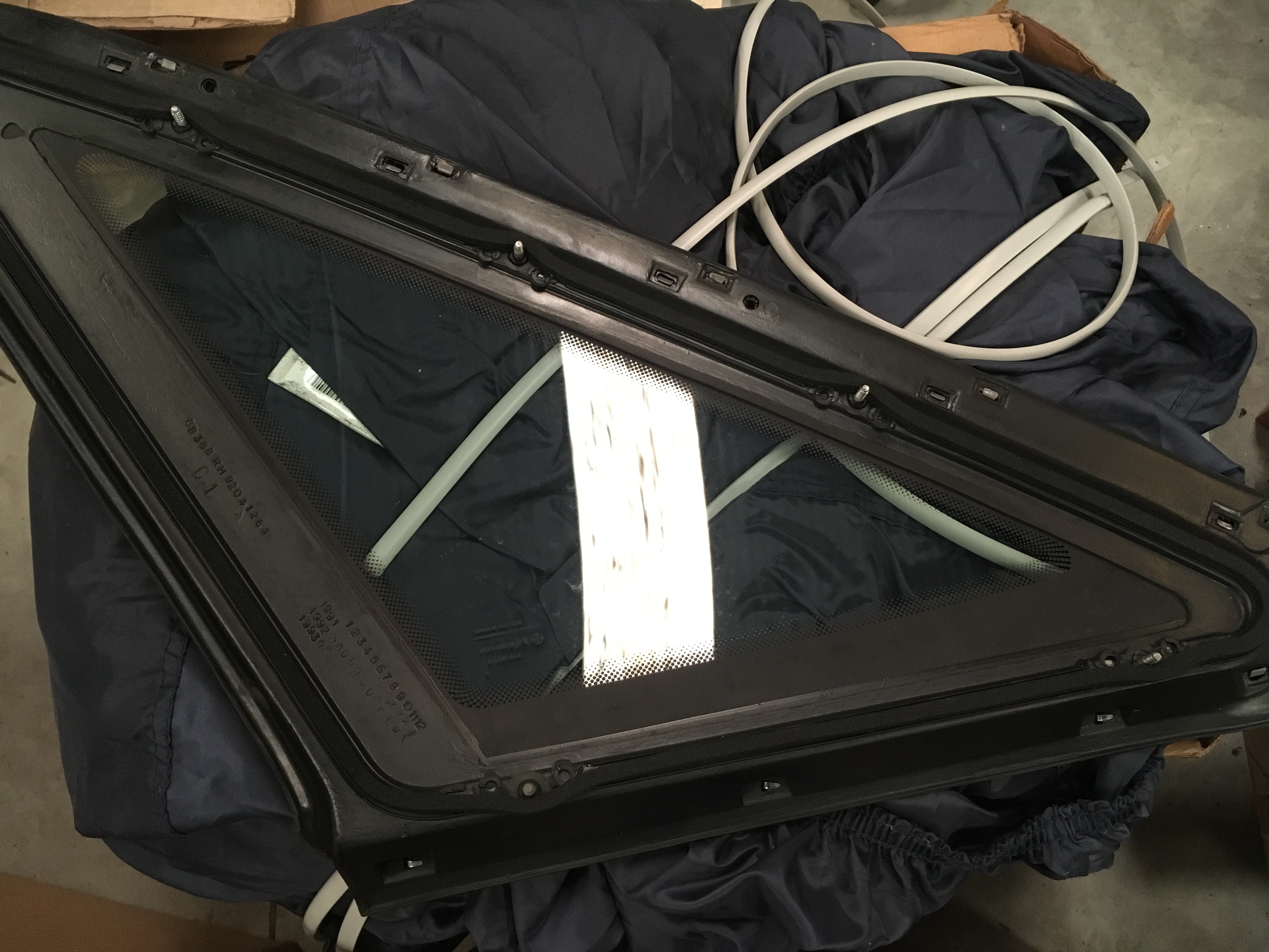

On Tuesday I had the castle looking place install the rear screen with my used but mint seal I salvaged off a VR at wrecking yard. Came up good, though I need to get the glass polished as there is several light scratched and marks. Turns out the guy told me where to buy the tools and powder to do it from a place in Bendigo. The compound is cerium oxide powder. Will practice on a spare glass before I try as its fairly easy to over heat the glass and crack it I was told.

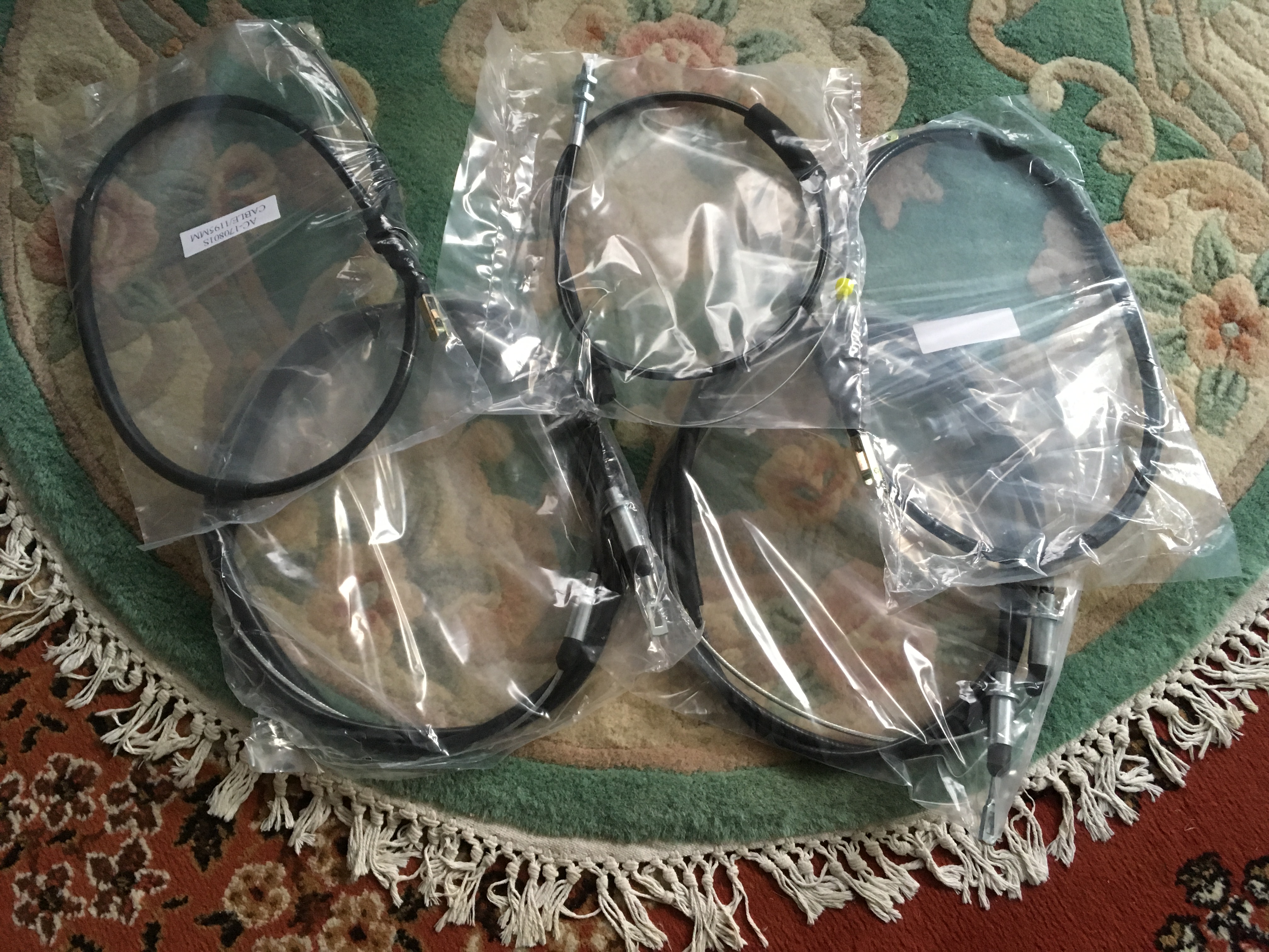

My cables arrived the other day from Auto cables, now known as retro spares and wow what a fantastic job.
2 sets of hand brake, 2 sets of clutch, and one accelerator as they need the original accelerator cable to rebuilt from due to not having the firewall end parts, I only supplied the one.

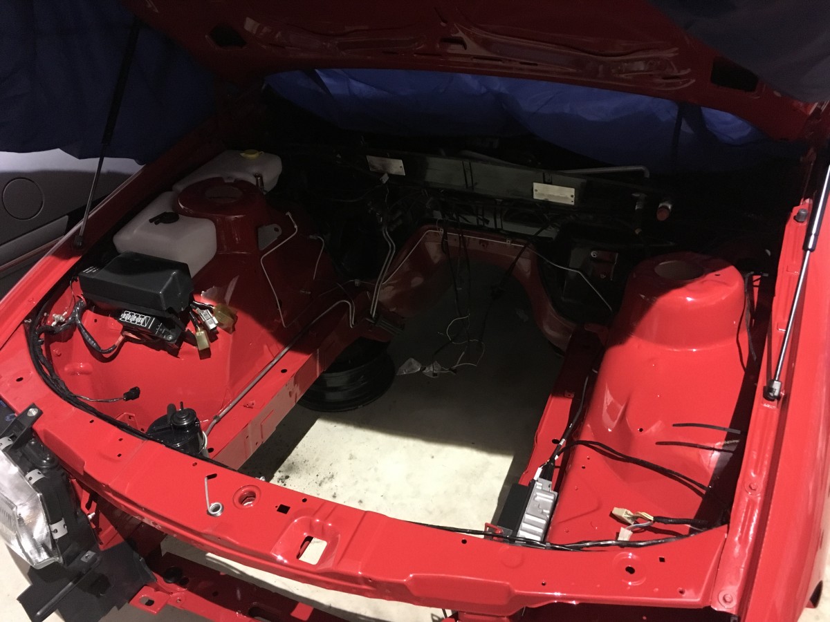

Got a lot more done in the engine bay. Got all the wiring in place except the engine harness obviously and haven't done the hole through the firewall for the cruise yet as I need to get a new climate control unit when I replace the dash. Turns out some dick fucked around when changing the heater core and ripped some of the studs clean out of the climate unit housing leaving big holes.
Off to pick a part for that one. So once I have that it will all come out and then I can punch the hole in the firewall while its all out to make it much easier.

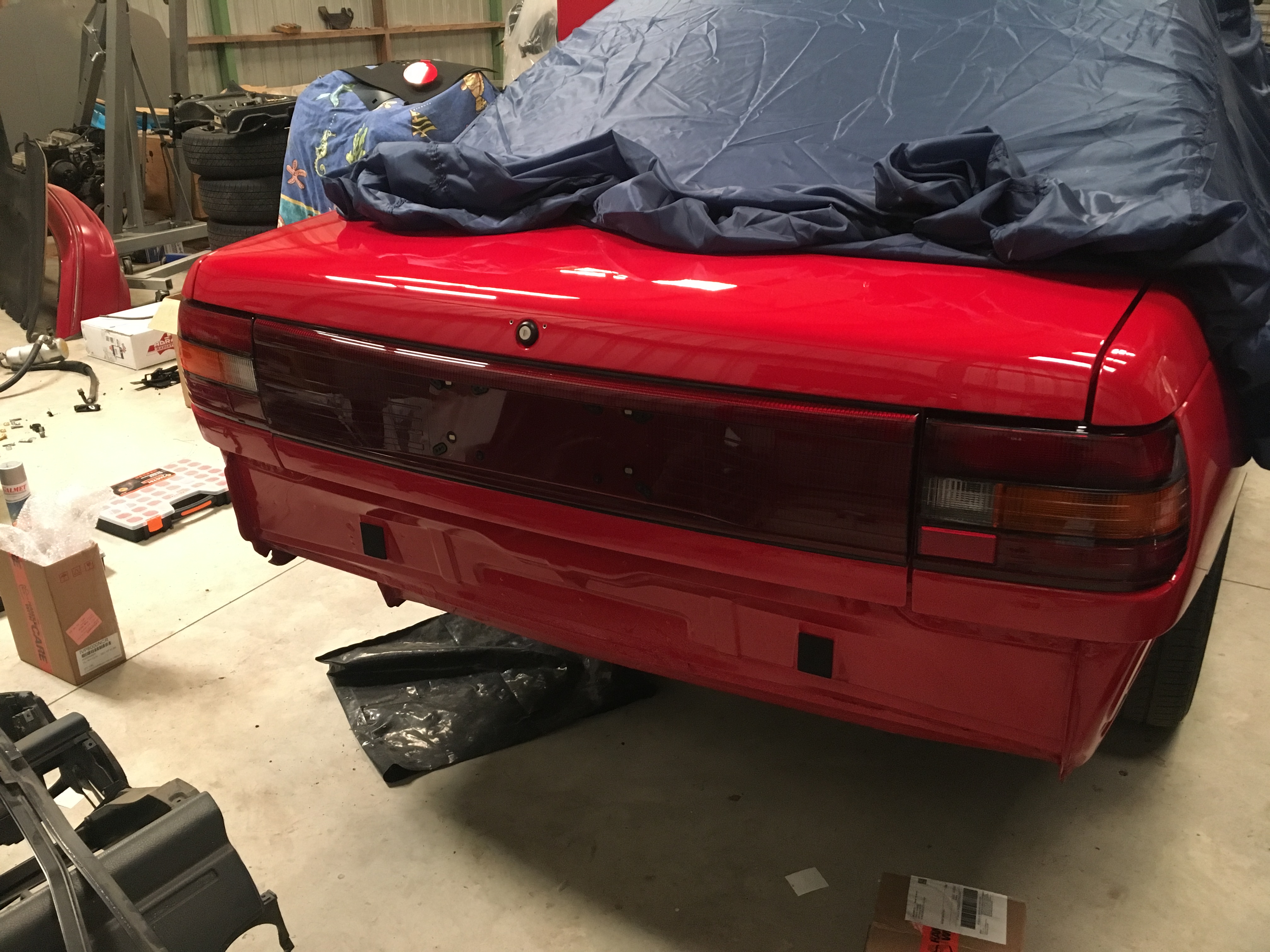

My aftermarket tail lights arrived. They don't suffer the same issue of the housing plastic and posts breaking, not quite a good fit as the posts are a little short on them but can be compensated for with some plastic spacers/washers if you really want to but the seal keeps the light to the body tight enough anyway. There is a little trimming needed on the right side light as the top lip will dig into the seal sealer strip on the rear quarter, its actually more of the issue with the VN/VP tail light panel being out of whack on both sides from factory, left side the light kicks out by 5mm+ while on the right side it sits in too far where the lips around the lenses are almost in contact which they do in case of aftermarket.
The nice thing is the seals on the aftermarket are heaps better, the housing plastic and stub/post constructions is a million times better, the lens colour and design is practically spot on and one of the best things is they don't fucking leak! Only down sides is what I mentioned, posts are a little short and top lens lip is a little longer. only minors really.
They are cheap as too. I paid about 80 for the pair.

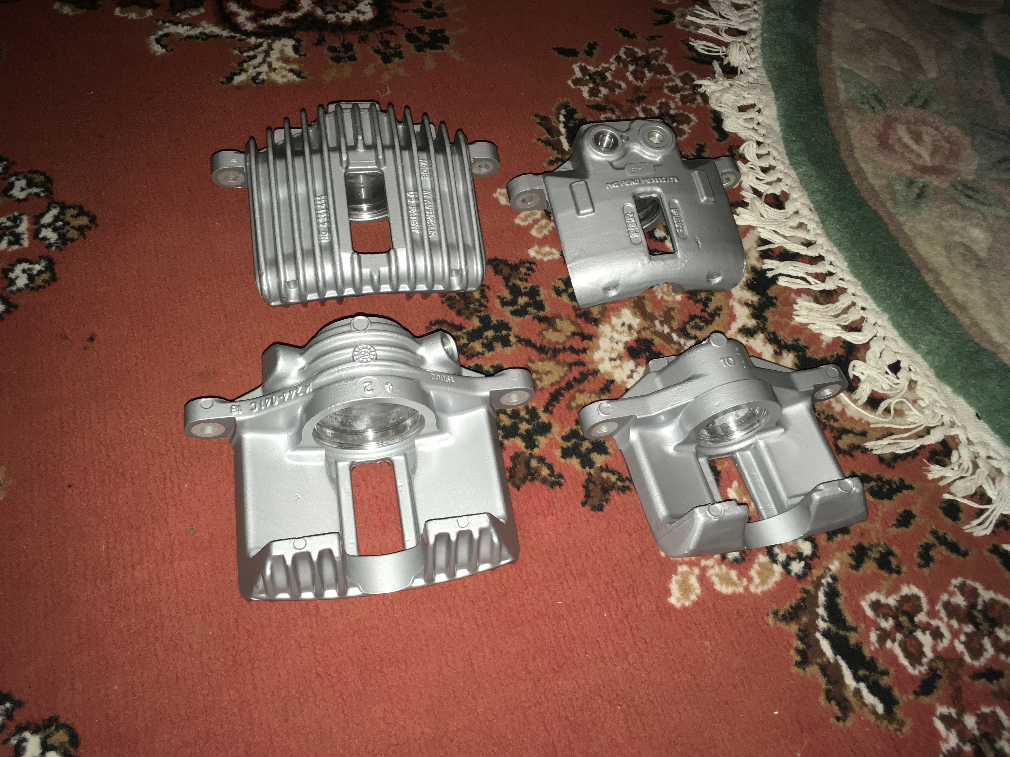

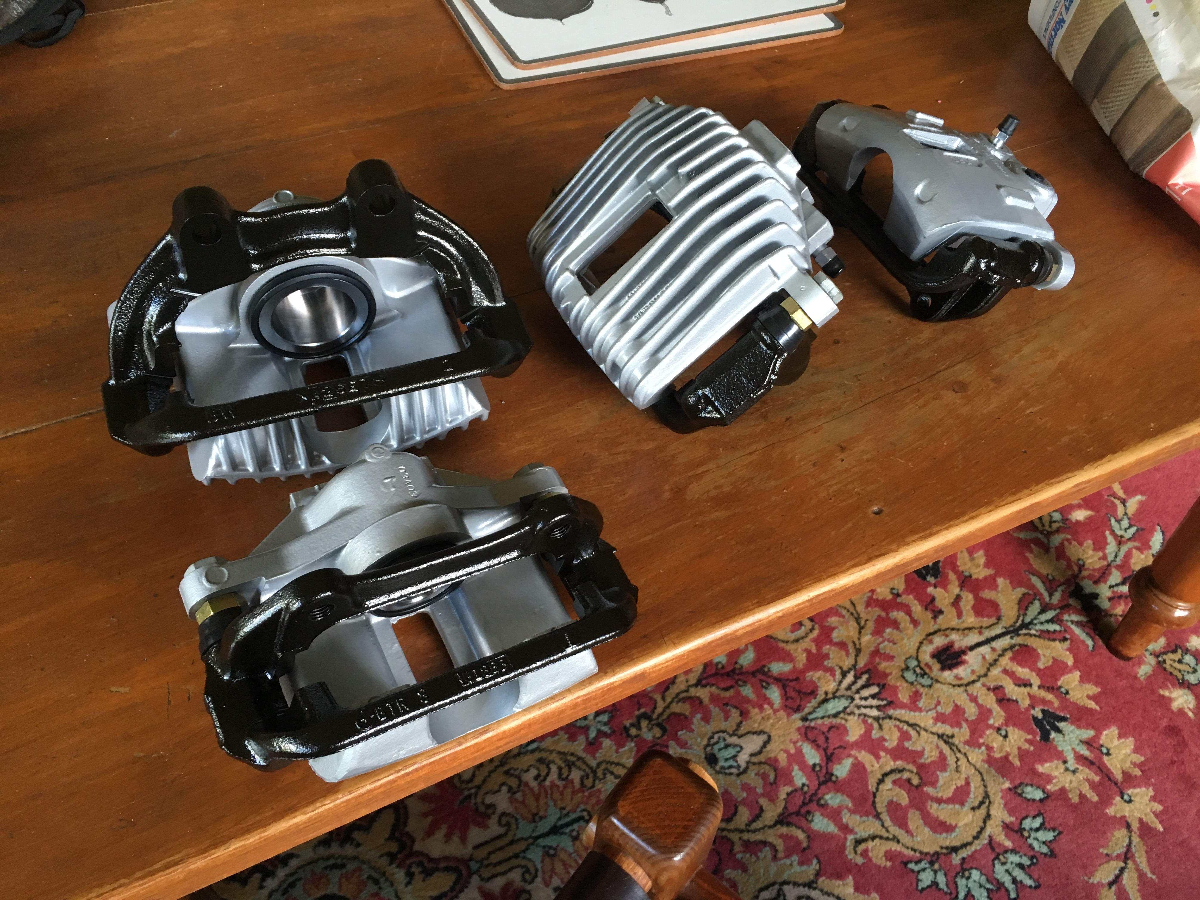

Then it was on to the brake calipers.
I got them blasted along with the last lot of stuff to be e-coated.

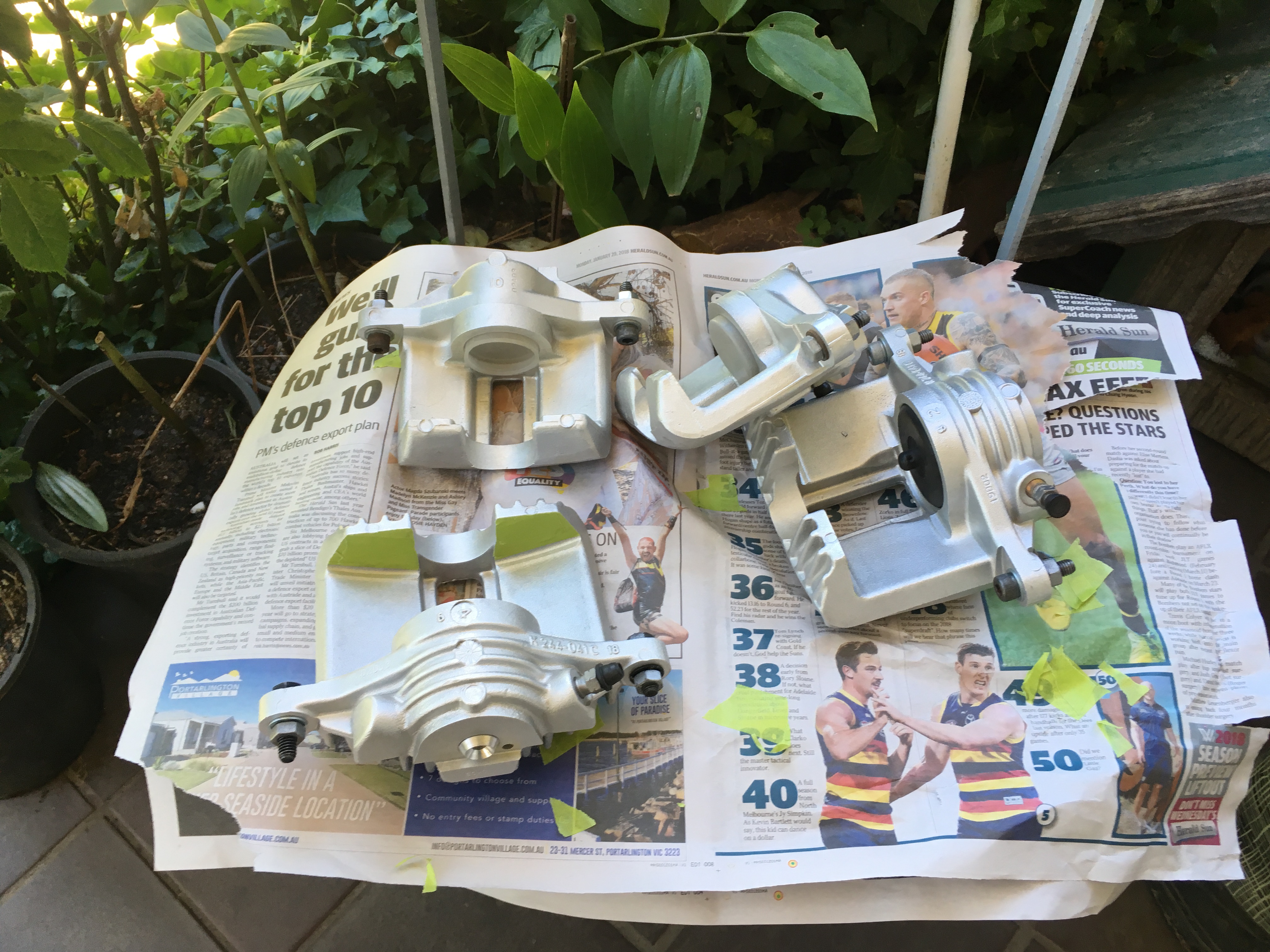

Did a final wash and masked all the areas I didn't want painted.
Painted in good old rust bullet. Love this stuff so much! Came up awesome as always.

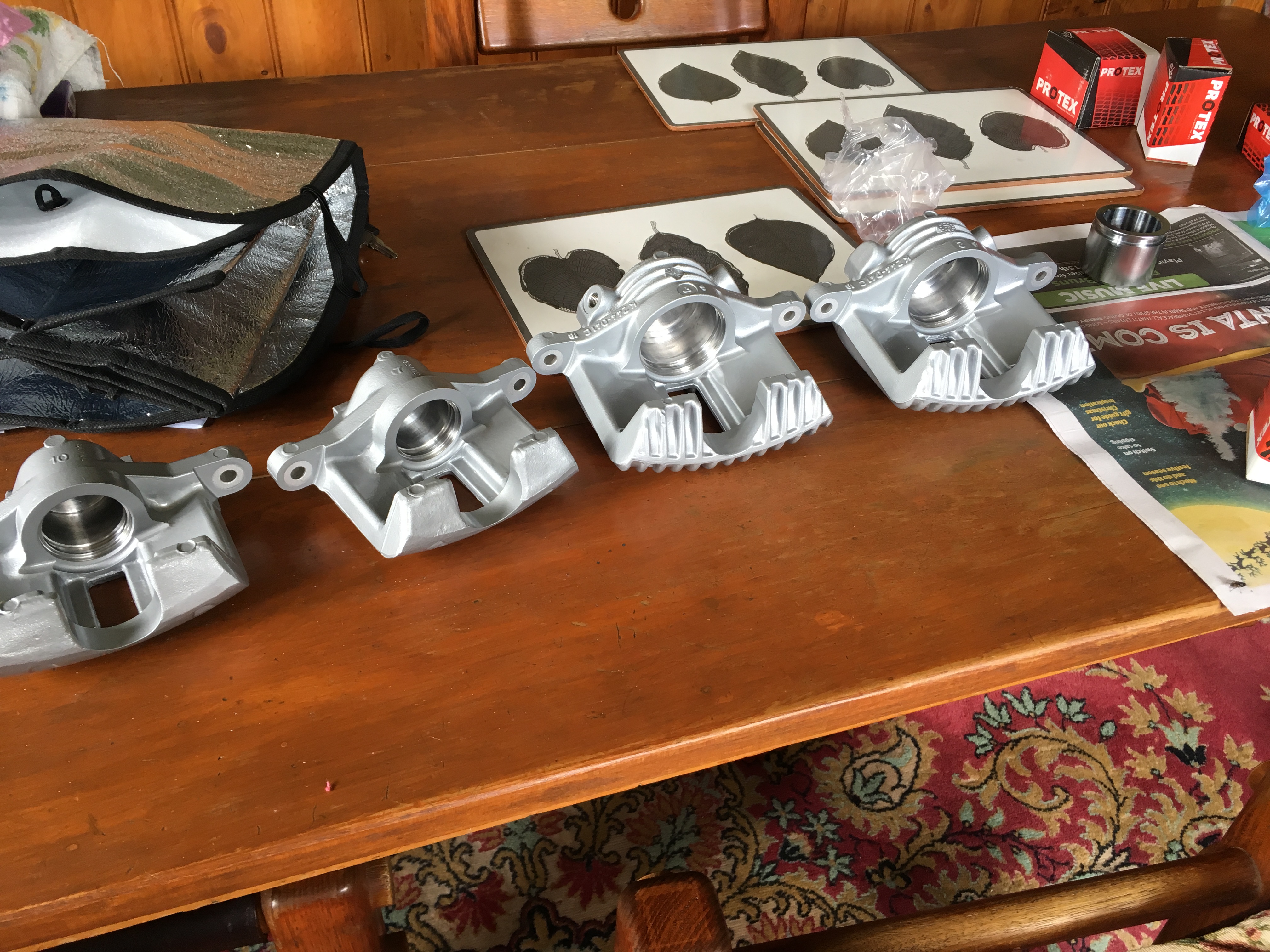

Gave the the bores a polish with fine steel wool to remove the oxidation and crap and have them a final clean along with the new pistons.
And final assembly. Mounted the anchor brackets and new screws. Then did the final toque of them when I took them to the shed at 30Nm
They truly are my best calipers I have done yet. Rust bullet for the aluminum and e-coat for the brackets. They will look like this for decades to come hopefully.
