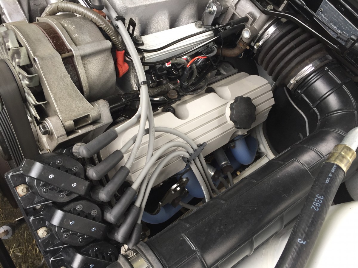

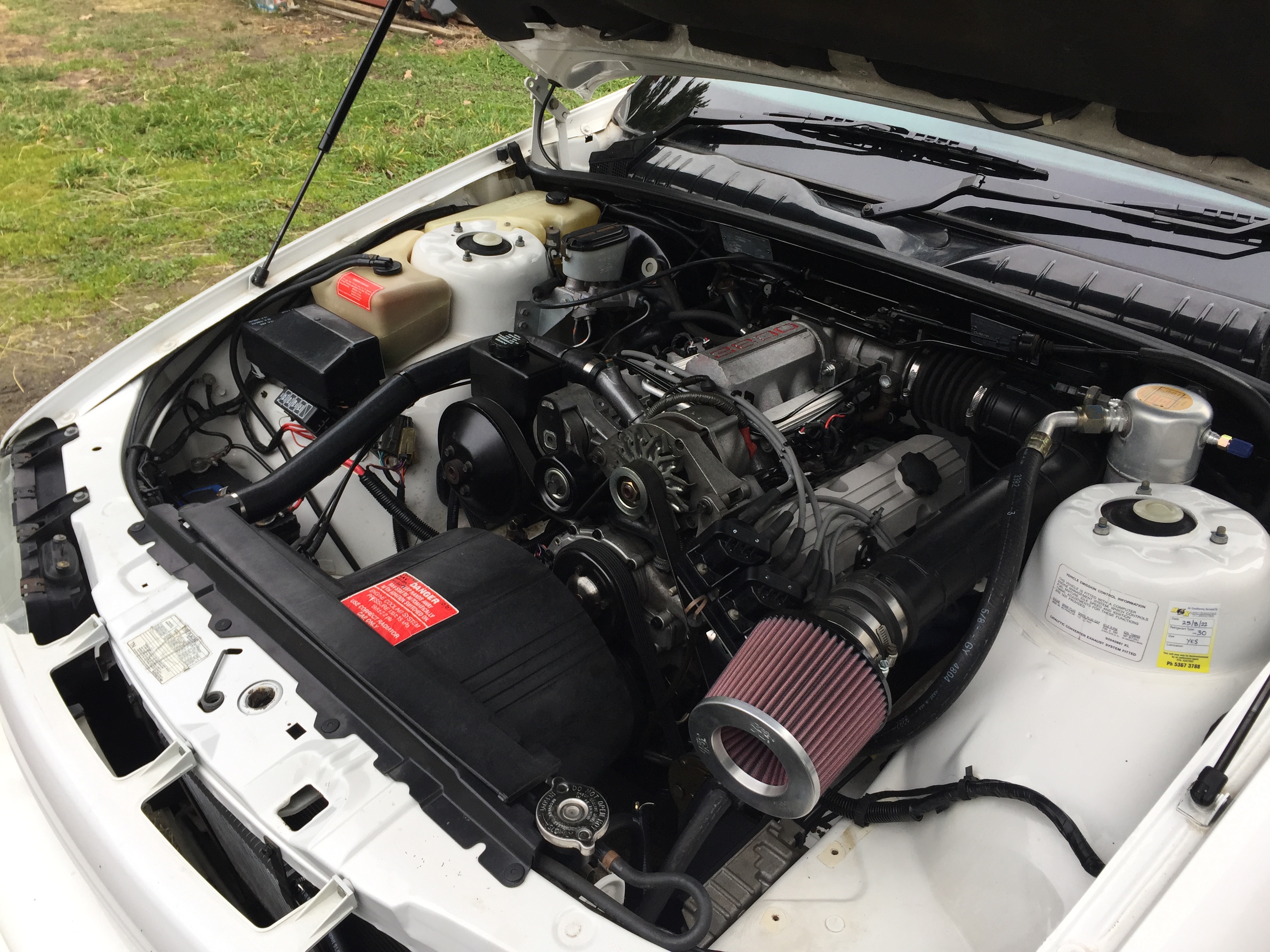

Figured I would add a couple of pics.
Talked to a few auto people and did some research, looks like the governor needs re-calibration to get the shift points right. So I ordered one from the states but the cheaper alternative to the B&M one as it's the same but not as ludicrously priced for eventually a few stamped bits of metal and springs, but still pricey.
There was none in Aus and back orders weren't coming in until xmas. So had to fork out for the robbery like shipping from the states Also ordered a genuine governor cover too as I reckon the original will get pretty beat up by the time I am done taking it in and out a million times

I've done a bit on the car since the last update but havn't compiled all the pics or what I did yet, been lazy and not particularly motivated.
Got the 5L throttle added and modified so I could run a compensation spring on the TV cable, a lot better but still not awesome. So I'm having thoughts of giving a go with some daily driving once everything else is done, and if I'm still not happy I'm going to the T5 route and keen to hot up the engine a bit while it's out.
