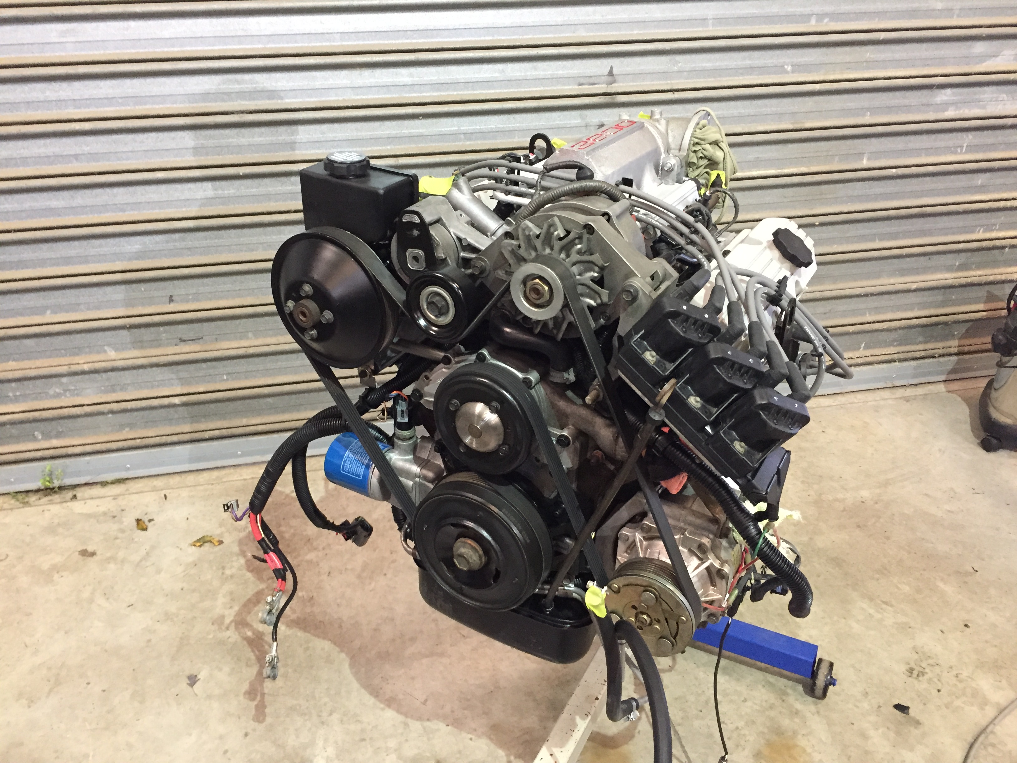

Warms my heart to see these clean and tidy Buick engines. Good for another half million kays now.
My book gives 30-40Nm for valve lifter guide retainer.
- Posts: 7803
I did it up to 25Nm with red loctite so should be ok.
Engine is ready now.

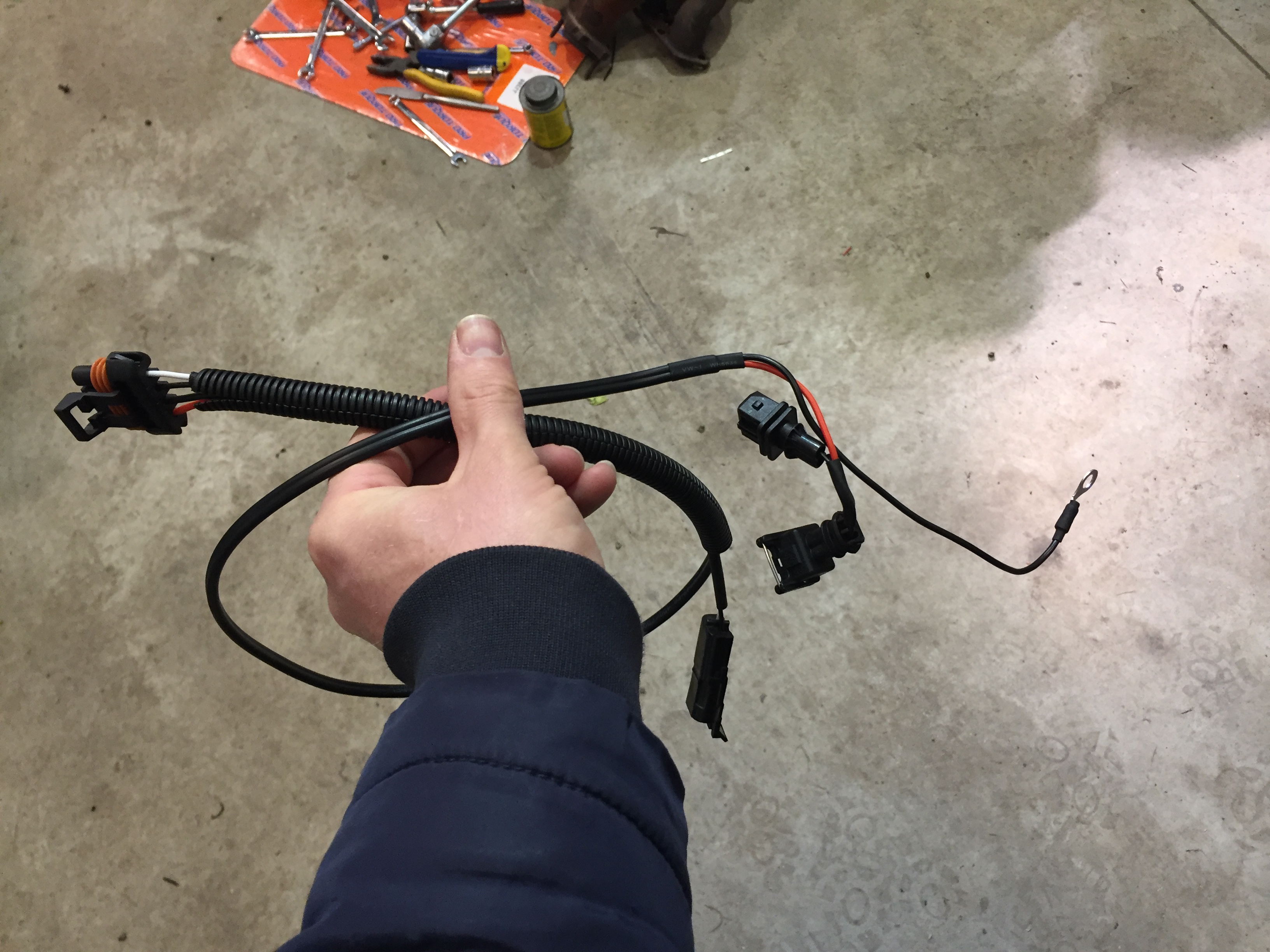

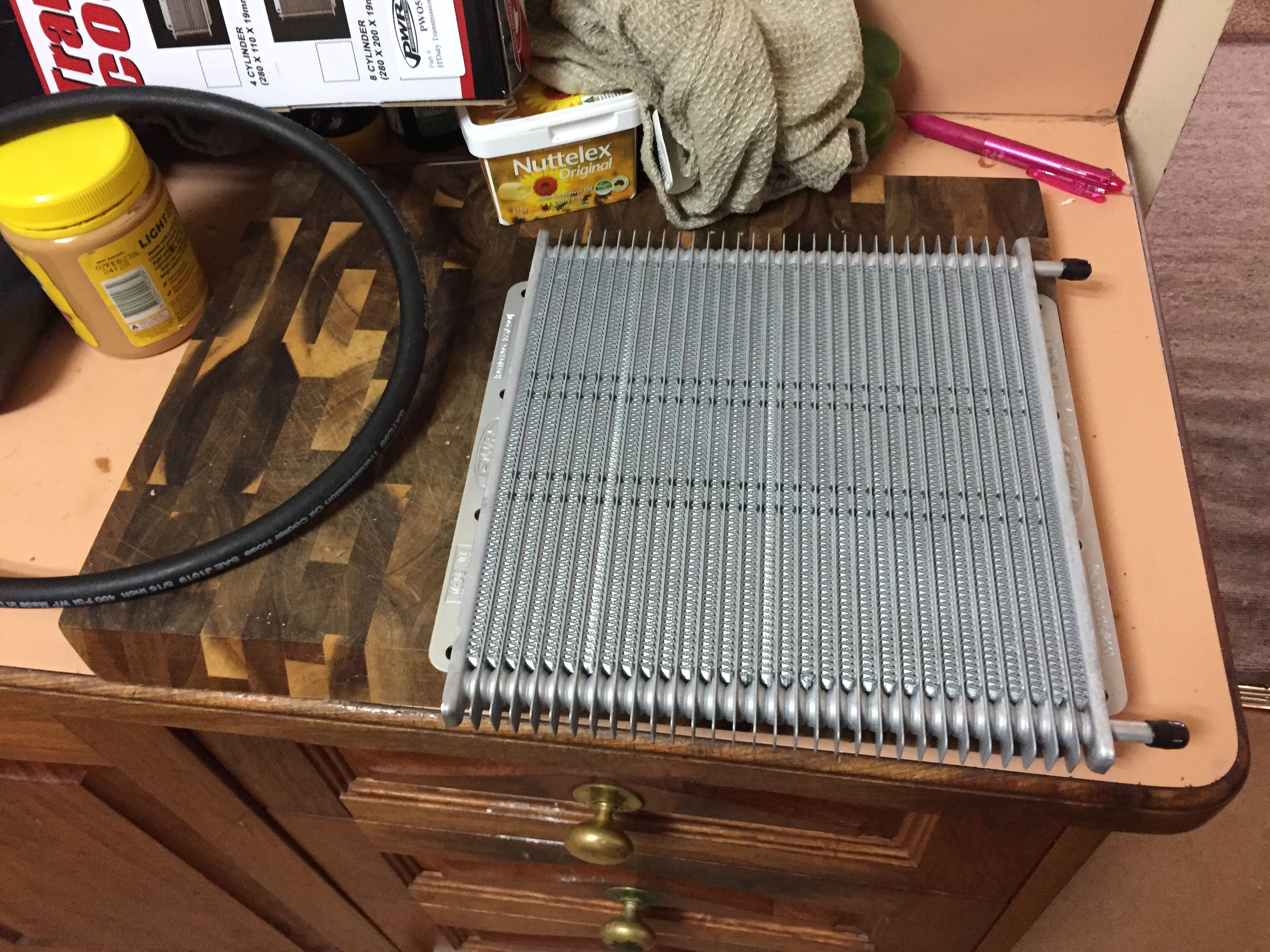

Also got the trans cooler. Completed the patch harness for the 4 wire O2, it intercepts one of the injectors to provide power and converts the standard 2 wire plug to the 4 wire one, all without any mods to the stock wiring, plug and play.

Have you checked the additional volt drop at the intercepted injector connector (with the injector on) relative to any of the other injector connectors..?vlad01 wrote: Completed the patch harness for the 4 wire O2, it intercepts one of the injectors to provide power and converts the standard 2 wire plug to the 4 wire one, all without any mods to the stock wiring, plug and play.
- Posts: 7803
No, it's a non issue given how little current the heater takes and the fact VN-VR injector wiring is super thick, easy take 20A.
