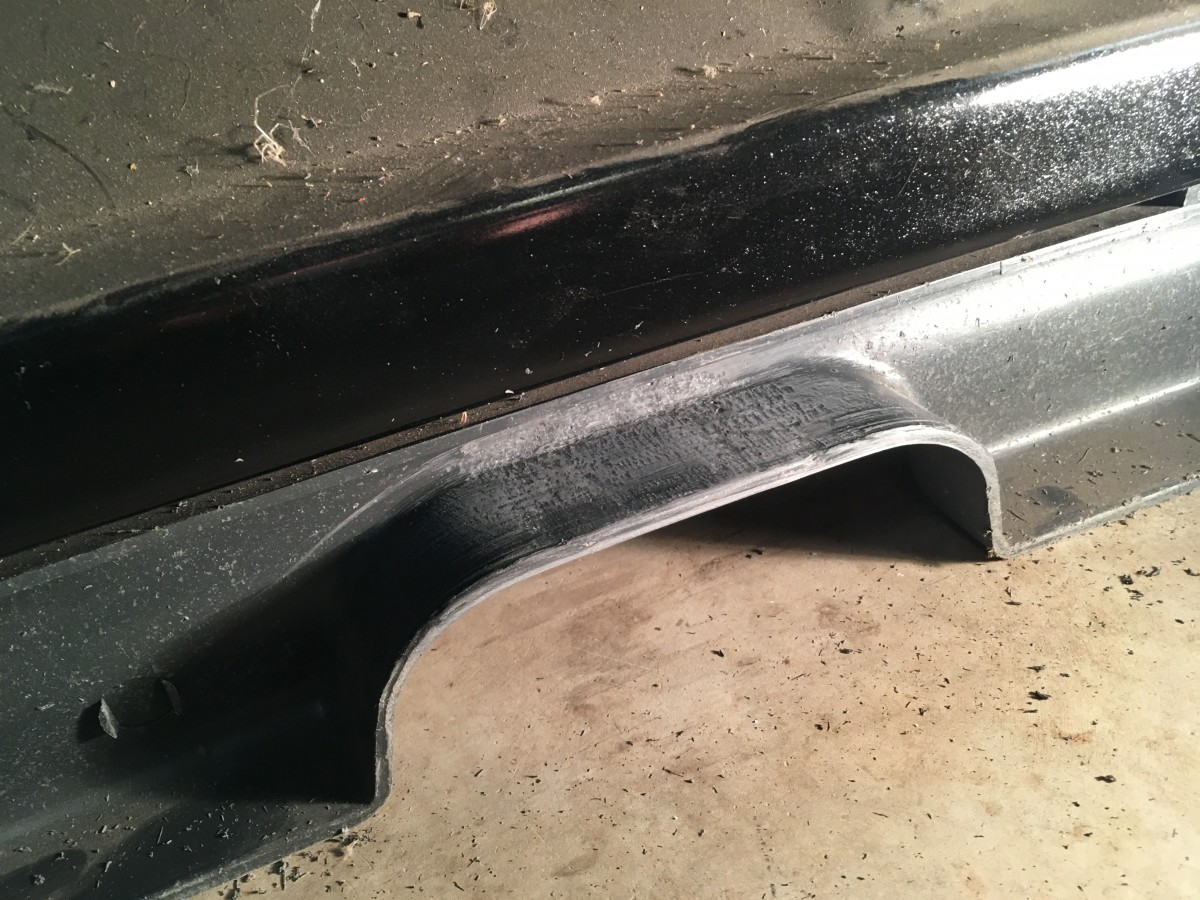

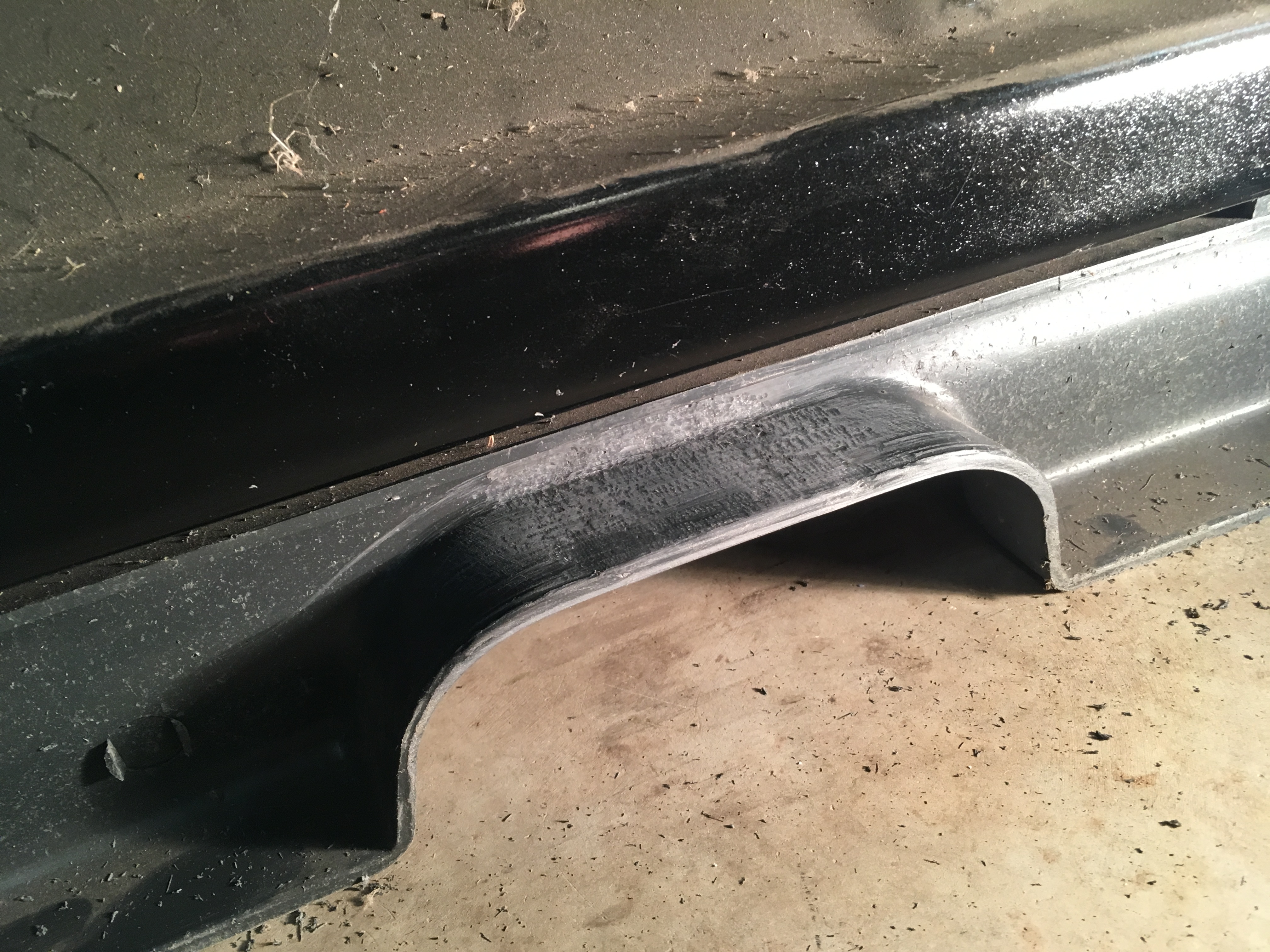

Fixed up the lumpy welding from years ago the other week. Helps having burs of the right size and shape to get in there.

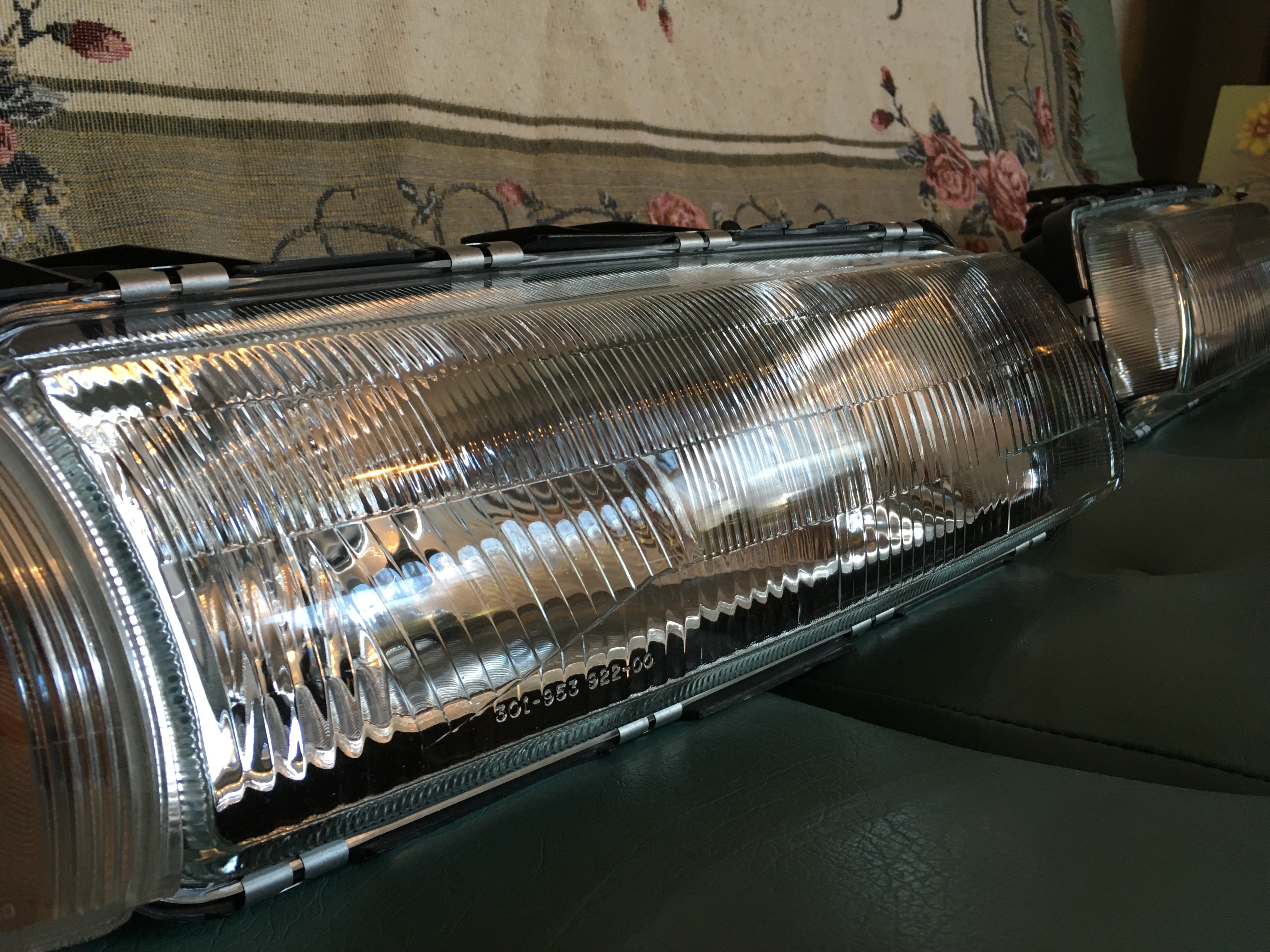

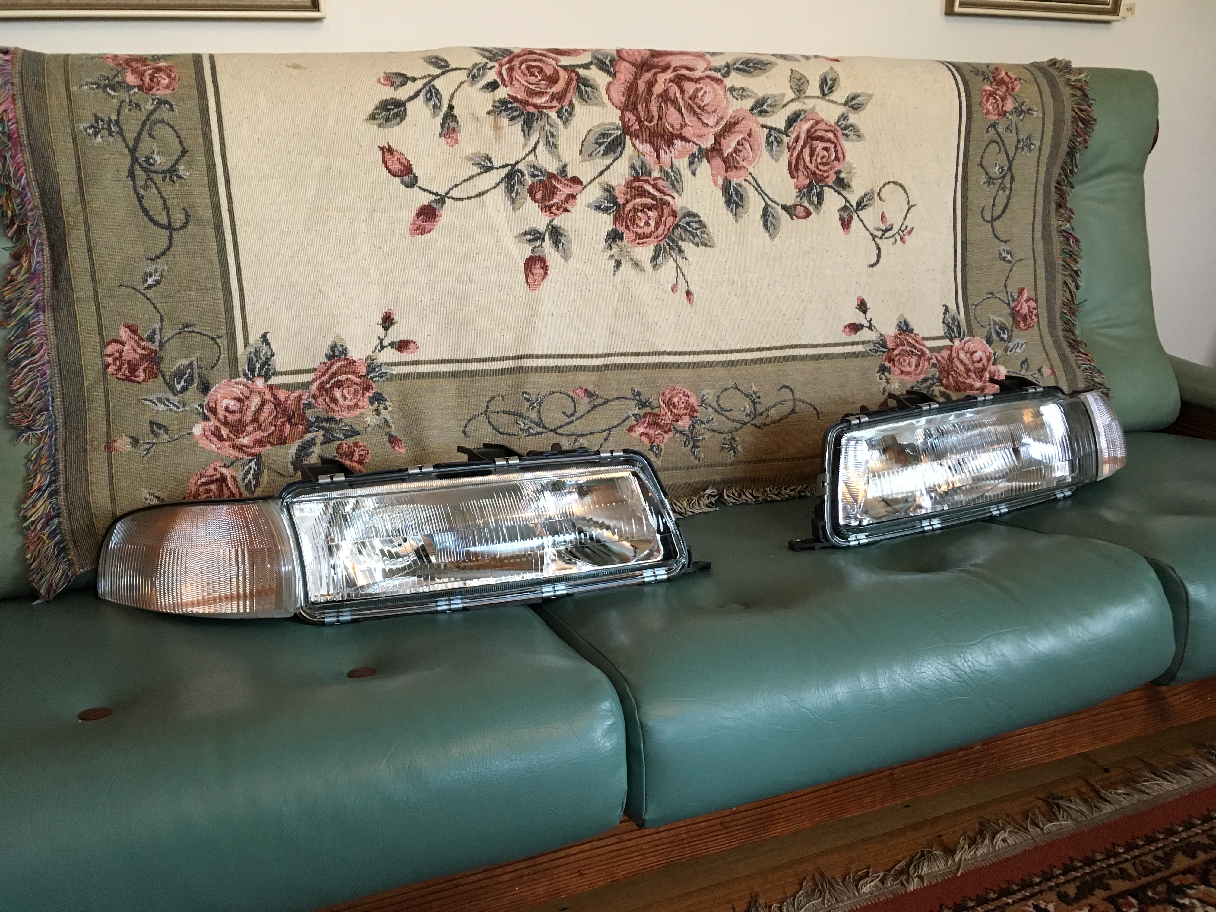

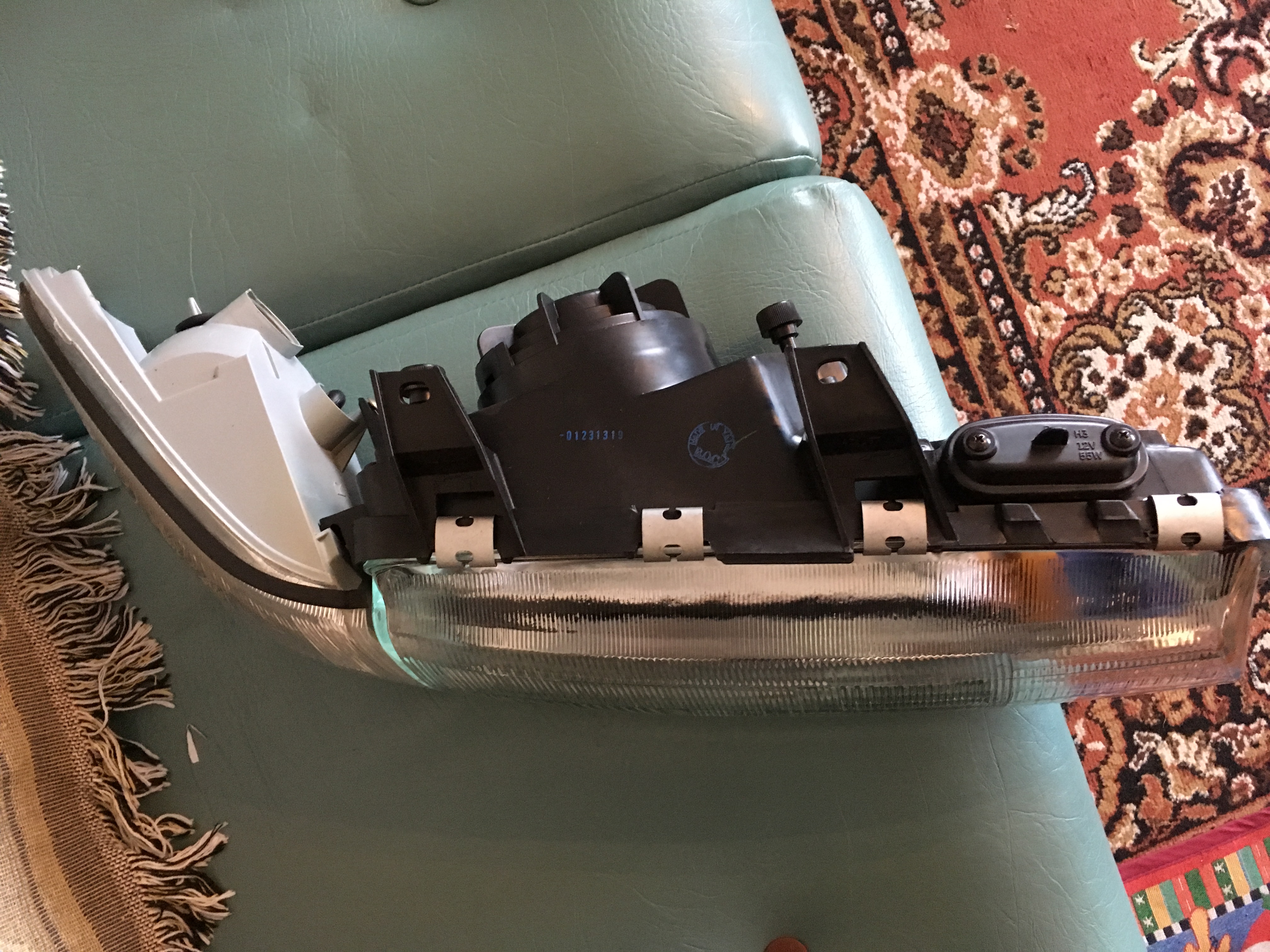

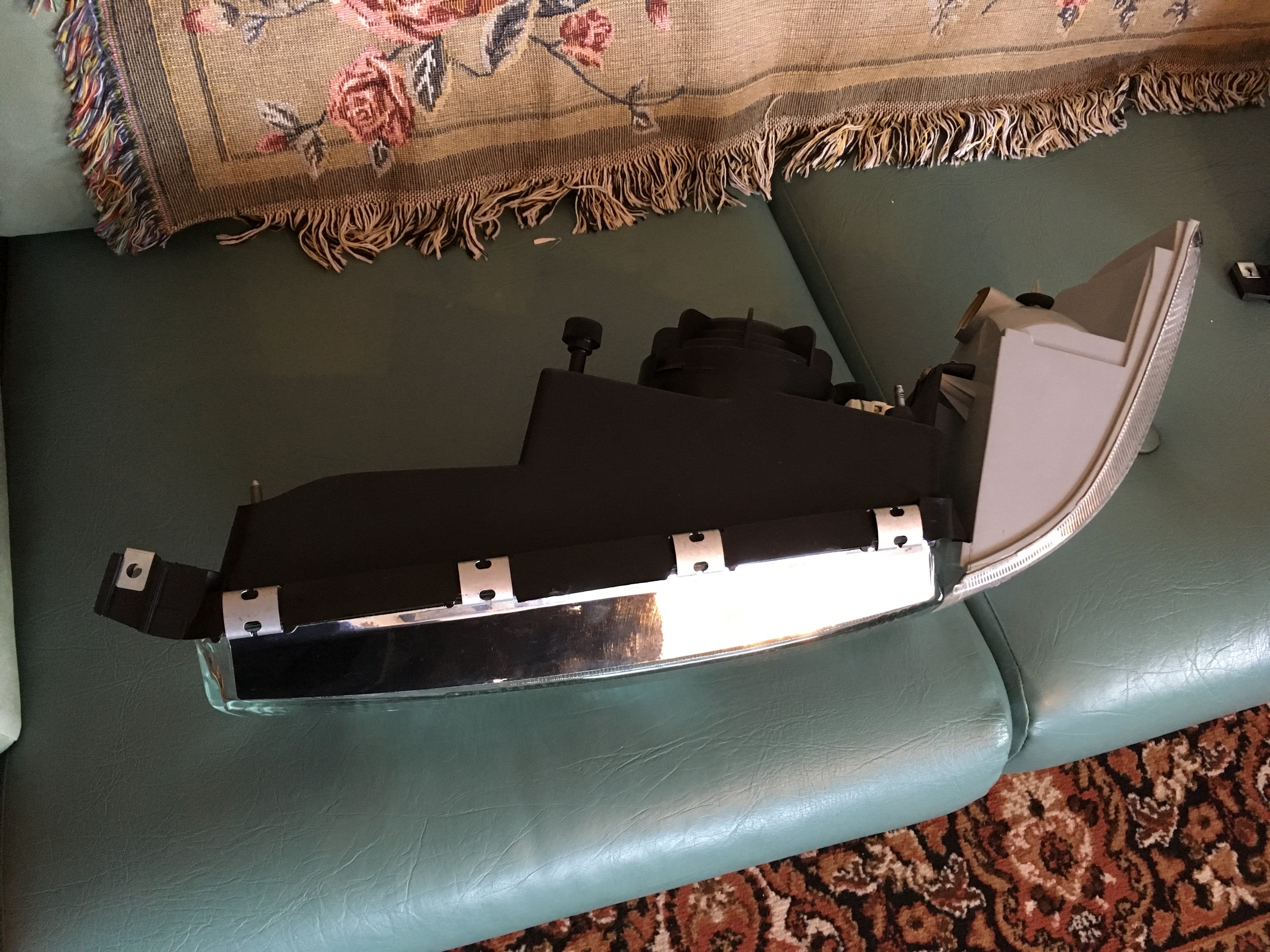

Head lights and indicators done.
Restored indicators, washed and then the lens cut with 1200, 2000 and then a cutting compound. Like new now

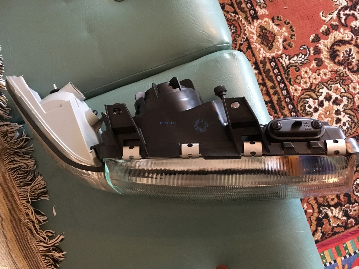

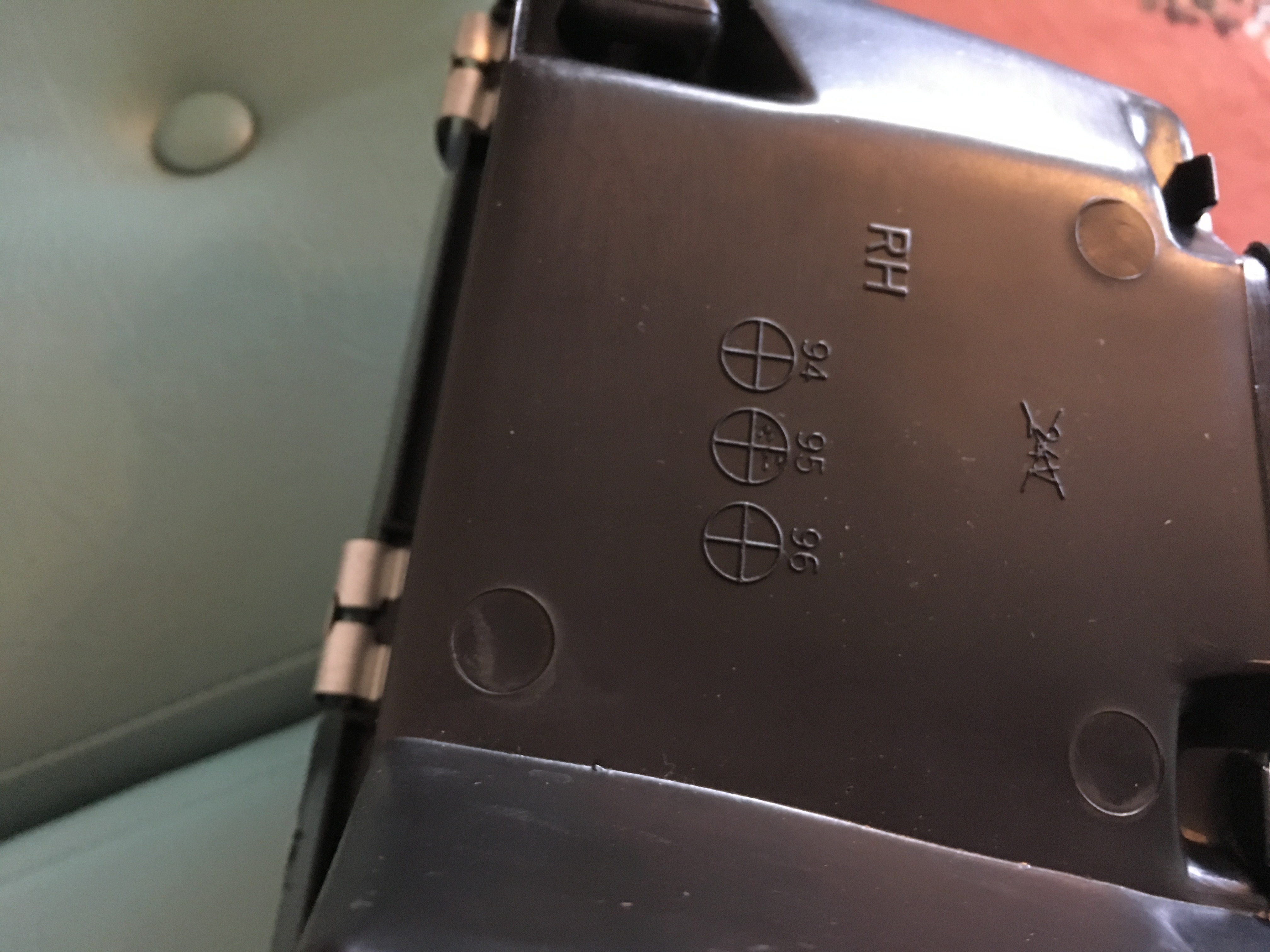

head lights are aftermarket housing with lenses swapped out for genuine NOS. These headlights sold out of All Crash are quite good, 99% identical to the OEM apart from PN in the glass and few tiny details. quality is very good. Its also apparent that they are in themselves old stock or the tooling was produced mid 90s. They are made in Taiwan.
I have some original used globes in there are the aftermarket are shit as I know for a fact the 25 year old ones last longer than any off the shelf ones available now. Not sure if you can buy genuine globes there days? not that it matters as I expect them to last 40 years of daily use from new (early 90s), and lifetime for collector car use.

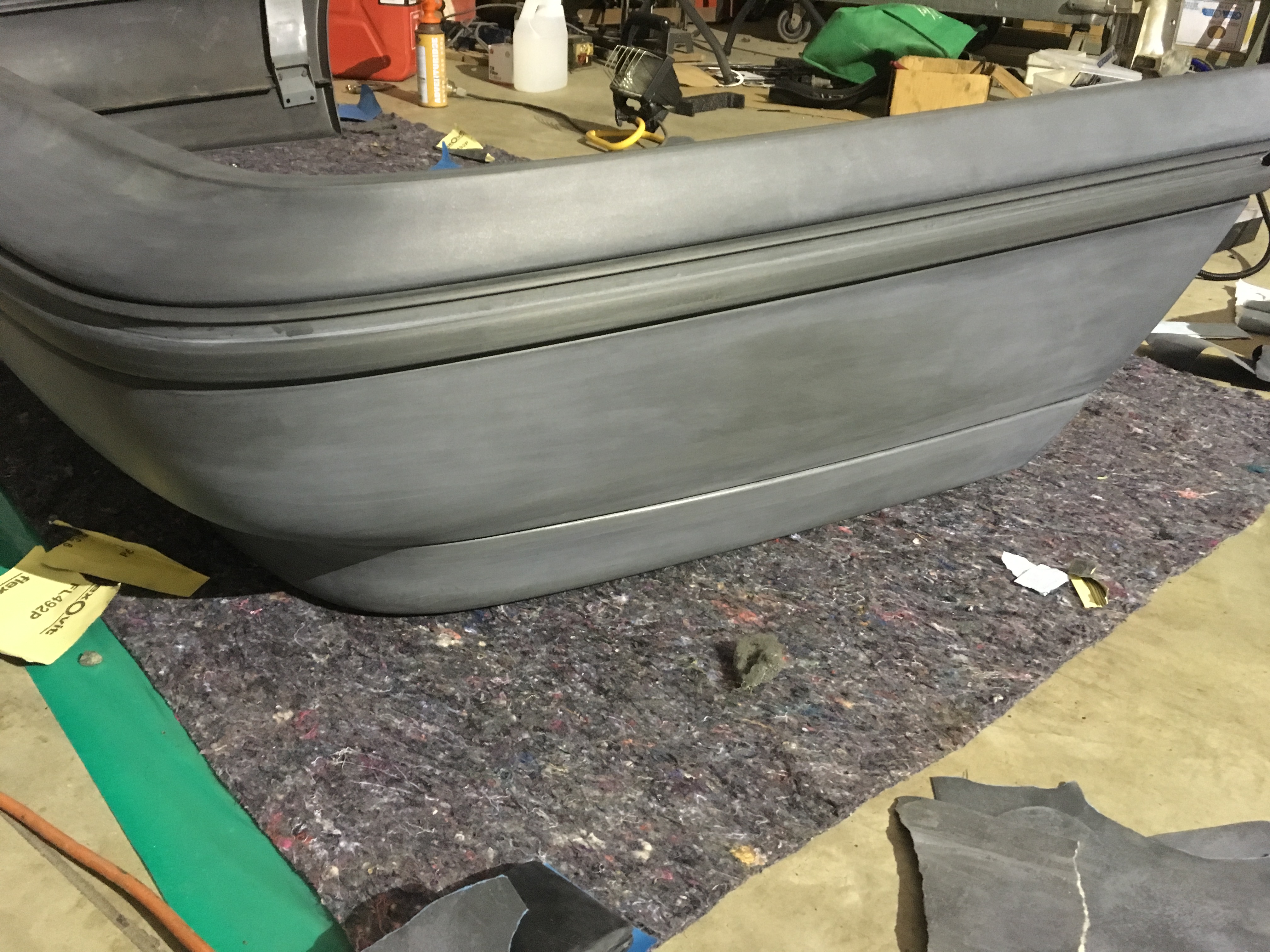

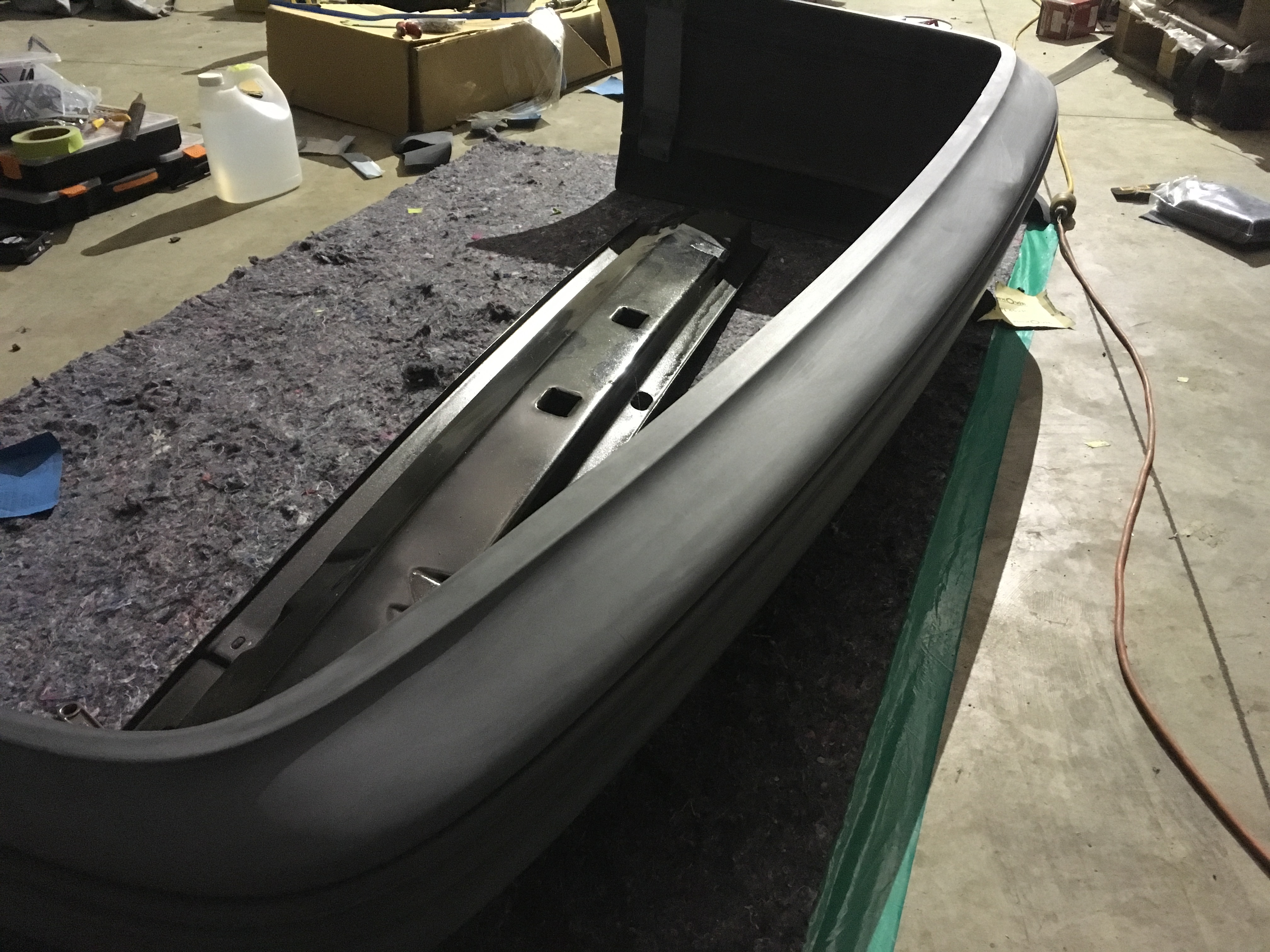

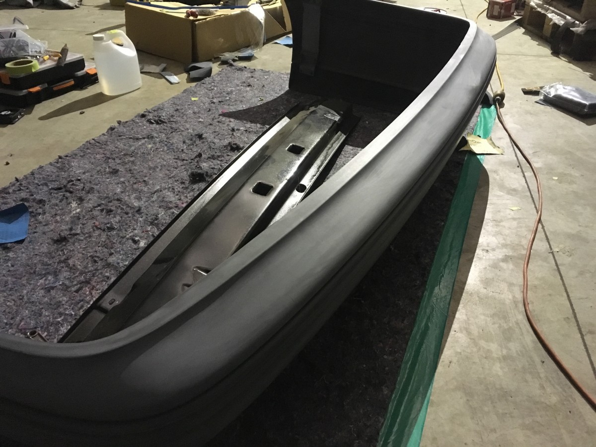

Bumper is ready to wash and have the small nicks and marks spot filled with nitrocellulose putty.
Was going to do that today but I got all the stuff out only to realize the pressure cleaner with the turbo head wasn't there, its my older brothers so he must of taken it home, my big ass industrial one is a pita and since it was 4pm and getting dark there wasn't enough time, so packed out for next weekend.

One thing worth doing on the aftermarket lights is to swap out the seals on the back bulb cover with used genuine as they are rubber where the aftermarket are foam, this will ensure the cover locks in tightly where as the foam ones are generally pretty loose. btw the covers/caps are not swapable due to being totally different locking locations to genuine but the seals totally are dimentionally the same.
Also I ended up bending the lens retaining clips tighter due to slight differences between genuine ones and aftermarket , seal, lens and housing. they are a little loose when genuine lenses are fitted. All sorted now.
